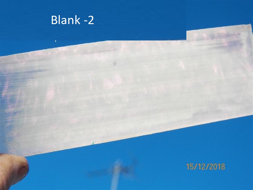

Attached you will see pics of various blanks that were sliced into knife scales, the question is;
1- Which blank/block did produce the most transparent effect...?
And now more importantly,
2- Why...? (what made it become more transparent...?)

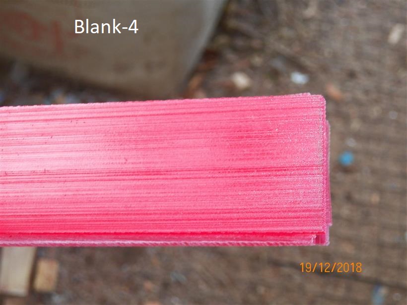

I have only cast two blanks so my first choice is blank 4. Because it appears to be several very thin sheets being held together. So when cast it would be clear and pink stripes.
In fact, all slices on the pics are 7mm thick, the only difference is that on pieces 1, 2 and 3 I used a single slice while on pic 4 I had the 4 slices x 7mm thick on top of each other, which is what each cast block gave me, 2 pairs of scales/slices.

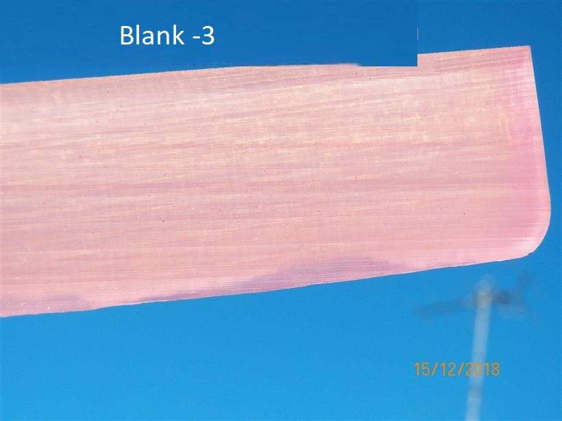

Ok I might as well use up my third try since I don't know anyways. Blank 3 because it has no white in it and adding white allumilite dye creates opaque blanks.

Blank 2 looks to be transparent on the edges. Whatever material you added the resin to turned transparent. Fiberglass is the only thing I know that does this but I imagine that's not what you used.
Edit: I'm only assuming there was a material used because of a pattern in the lower left corner. That could just be surface texture

Blank #2 would be the most translucent.
This is caused by the colorant used. There are several pigments, when used independently, will create a very translucent cast. This is due to the light transference, the light passes through the pigment particles, rather than being reflected. This is most common with synthetics. Most of them are referred to as highlight pigments, although they go by other names.
Using a base colorant, or a dispersion, will create an opaque cast, that will also enhance any additional pigments.
Using a white dispersion in blank#2, would create a white blank with highlight color swirls. Using a black dispersion, would create a black blank, with more intense highlight color swirls.
On both of the swirl blanks I mention, they would be swirled only if cast as a swirl. Otherwise, if they are thoroughly mixed, The highlight color would be prominent.

George, I believe that it's going to be blank #4. The reason behind my thinking this, is because (a) it has very little white in it and as we all learned in art class or science class in school is that white reflects all of the colors of light making it one of the two most opaque colors. (b) magenta or in art, Permanent Rose, is the most transparent color of all while it does reflect light, it's the pinkish hue that's in the long wave spectrum of visible light, thus it's not as reflective to our eye. (c)I'm pretty sure I'm pulling this all out of my rear end and actually have no idea if this is true or not...:biggrin:

Blank #2 would be the most transparent because of the way it's graining is going. The others have a more varied grain structure so the straighter structure would be easier to see thru.

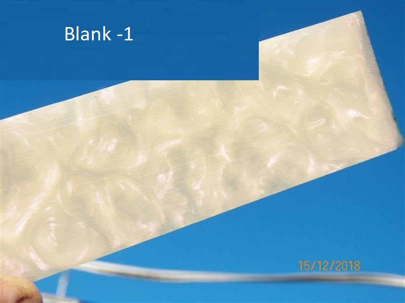

Following Terredax comments, I would like to say that, blank #1 was created using Interference red from Pearlex, the amount of powder used was pretty much what I would use if it was other type of pearl powders or solid colour (powder form), the Marble effects remind me of the quality Italian Marble and I'm sure a pen or a knife will look good with it.

Blank #3 was a mix of the same 1/10 amount of Interference red with a small amount of Irresdecent red, the intent was to bring a little more red into the blank but the colour became pinkish and still not translucent enough.

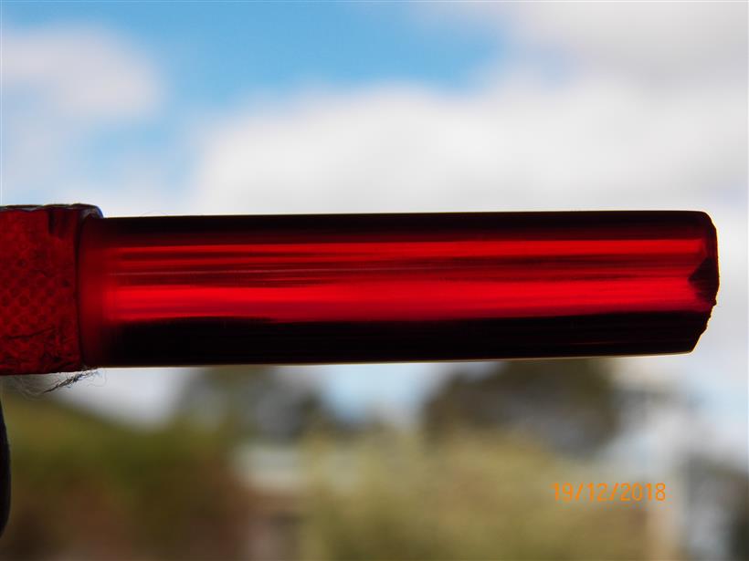

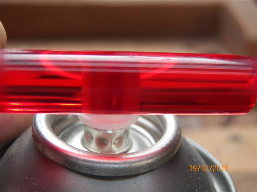

Now, what I used on blank #4 was the result of what the client said when I sent him the pics of the first 3 attempts, his comment was, "well, I was thinking more like some drops of blood in a glass of water or even red cordial type look...!":eek::mad: I wish he said that the first time (I actually told him just that) and he agreed, his original request wording was not correct resulting me to assume a different look.
Someone already commented about the transparent red type blank/scales wouldn't be the sort of blank most of us would go for but this guy thinks out of the box and he has a very clear idea of what he wants, it seems that he has created some knives where some "artwork" was carved into the handle part of the metal blade so he wants the scales to be transparent enough to see through his artwork, smart idea if you can carve, this guy makes some very "unusual" knives.:biggrin::wink:
I had a small bit leftover from the 4th blank I've made and decided to demonstrate how transparent it is, now, that into account that this round piece is about 12mm diameter and the scales were sent at 7mm but will be taken down to 4mm or less in some areas.
Also, Terredax, when you mentioned the use of dye to create the transparent/translucent blanks, you were referring to dyes in liquid form, right...?
