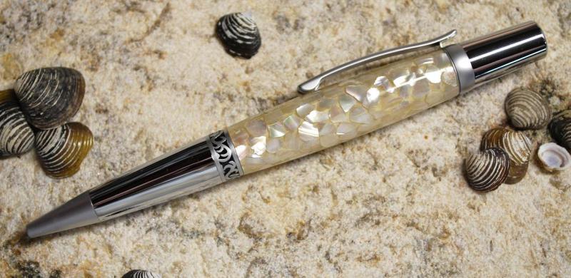

I was reading about casting some mother of pearl powder two days ago and remembered I had this blank, so I finally finished it. I bought a bag of crushed shells and sorted out the pretty ones to glue on a painted sierra tube with medium ca. It was casted in silmar 41, turned, sanded, micro meshed, and polished and buffed! I think the elegant chrome kit is a bit bright next to the blank, but it was all I had. Next time I'll have to check with Ernie at Beartooth and see what I can get in a satin. All comments welcome.

Same Kit
Beautiful Pen!
The same kit is available from Berea with the Chrome and Sating Chrome sections reversed. The will cut down the shine for you. Also, how thin was the shell when you glued it on a tube? Did any of it it come through the simlar?

I'll have to try the reverse kit to see how it looks. Thanks I didnt have any come through the pr. The shell pieces were very thin. I had a couple break when I pushed them flat against the tube.

Absolutely gorgeous pen John!! Two questions: (1) What color did you paint the tube and (2) I always get paranoid when I'm turning down the clear casted blank for fear I'm going to hit the substructure material! But I don't want it to be over bulky as well.....What is your technique in reaching this happy medium!? Thank you

Thank you! Didn't expect to see this post alive again. Lol. These were very small thin pieces of shell so I didn't have to worry about the thickness. The other shell pens like the abalone piece blanks were much thicker. For those I glued them down with medium ca and then after a day I lightly rolled them on the belt sander to thin them down and then put them on the large and sanded through some of the grits to smooth them out. Then I polished them before casting. The other shell pens with texture or patterns on them I just selected the thinner pieces for the tube edges since sanding the outer surface would remove the pattern off of them. The tube paint depended on the shells. I would try to match their color. The mother of pearl blank tubes were first painted white and then I coated them with a pearl looking nail polish. The abalone tubes were painted a dark blue or black and the other seashells were usually an off white to match the underside of the shell. Be sure to wear a respirator when sanding shells. The dust can be very harmful to your lungs. Hope this helps! Thanks again!
