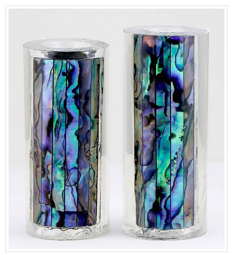

Definitely not Tru-Stone. What I'm looking for is basically mother of pearl cut into strips, glued onto a brass tube, and then cast in clear acrylic. Here's part of a screen grab from Exotic Blanks' site showing the abalone blank:
attachment.php
There are other types of mother of pearl blanks too. Some look like crushed pieces glued to the blank and then cast with clear acrylic.

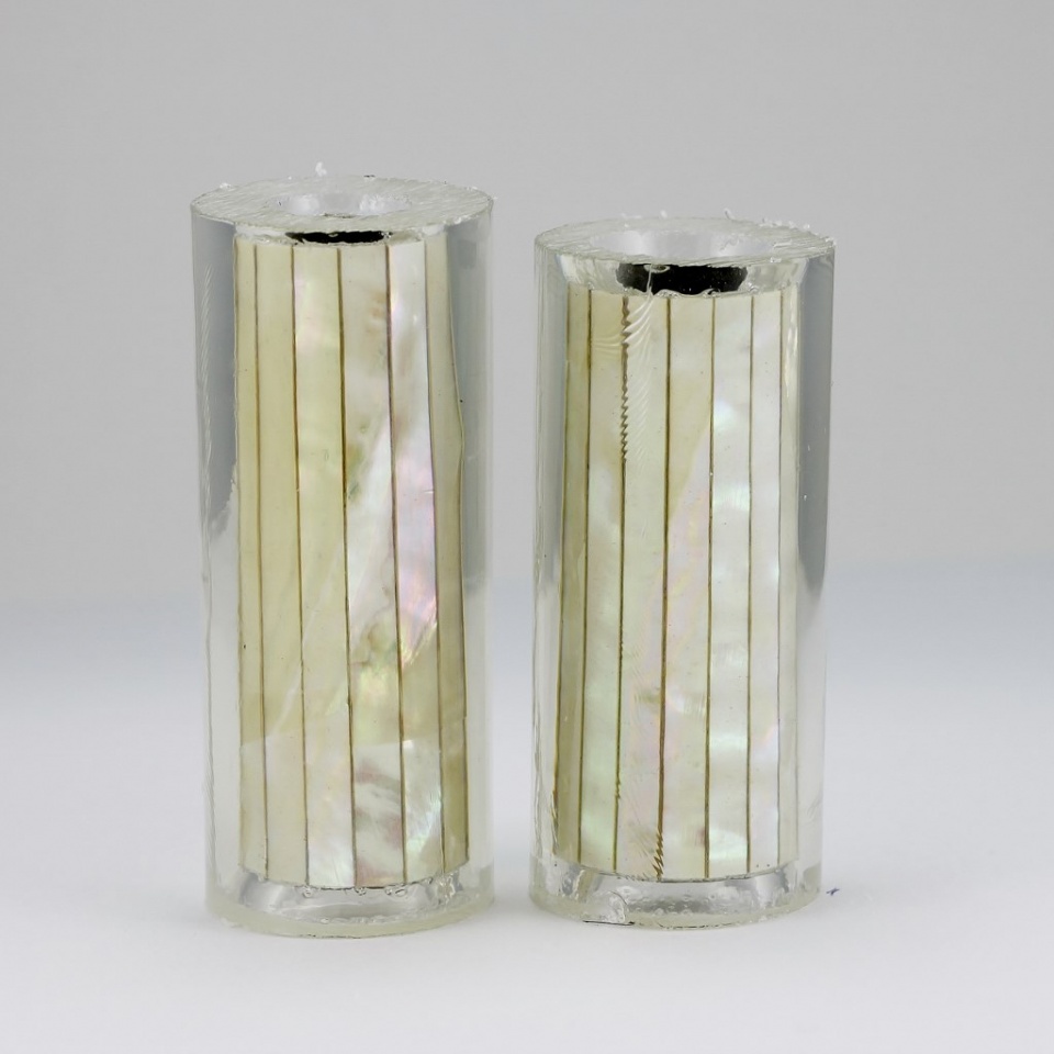

I had gotten one from Classic Nib about two years ago.
Here is a pic.

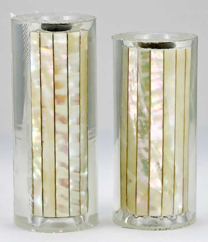

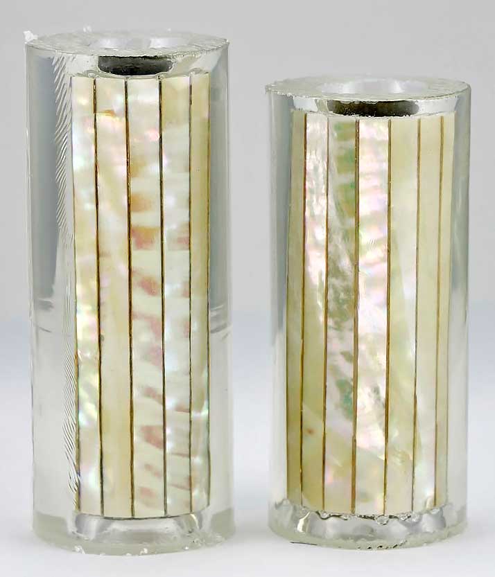

Mother of Pearl is really a broad term. In my research different shell suppliers use that term to apply to different species of shells. When I do these for Exotic blanks I use Natural Awabi as my "Mother of Pearl" color. Below is what one of those blanks look like:
Is that what you are looking for?
I don't make those as often because honestly the demand is a little lower and they are more time consuming since I need to make sure everything stays absolutely clean. I do not have any of the Awabi Material right now to make any right away. I will order some in my next shipment though.
Send me a PM if you have any questions. More than happy to help out.

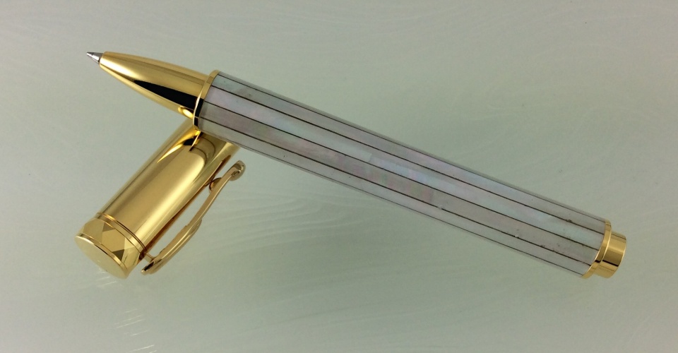

These maybe Mat? Ron Robbins (Brownsfn2) makes these. You can contact him on here via PM.
attachment.php

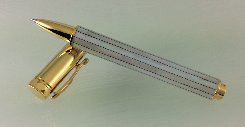

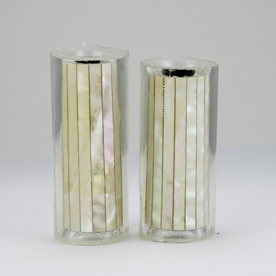

The one I attached is made from awabi shell, which is a little more creamy (ivory) then MOP, but shows a lot more color and shimmer and is just a nicer look (IMHO) than MOP. I have attached a link to a pen done in MOP for comparison. http://www.penturners.org/forum/f13/mop-emperor-66341/
JohnU is the only one that I ever remember seeing doing the shell bits, ( http://www.penturners.org/forum/f13/mother-pearl-elegant-sierra-48012/ ) and they are amazing too! I could be wrong on this, but I don't think that he sells those blanks any more.

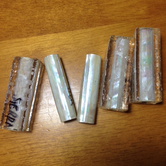

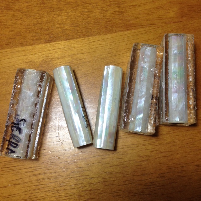

These are the blanks I mentioned in my PM:
Steve, those are very nice looking blanks.
I do not see any gaps between the slices of mop. Looks to have been mitered/beveled and not square cut.
You are correct: mitered and no gaps. Some strips were joined end to end within one strip. This also was done very well, and does not detract from the blank at all. The two turned blanks were quickly ruff turned/polished to be able to inspect closely, leaving some small chip-out on the surface. This will be turned off when the blank is finish turned. I have offered these to Matt at $35 each plus shipping. If he passes, they are available. (Your choice, I am keeping one of them.)
