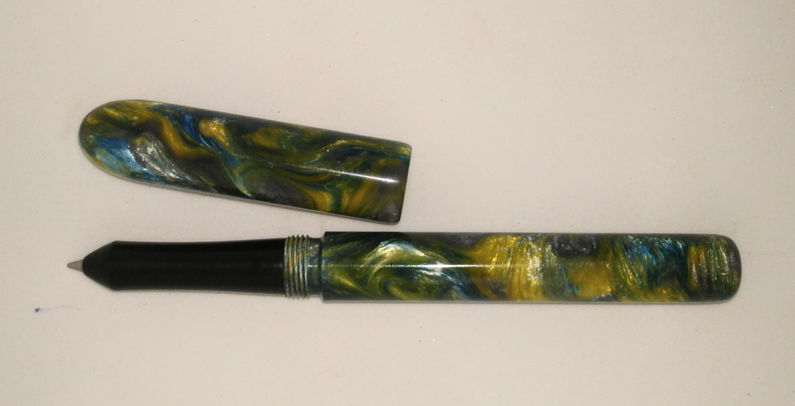

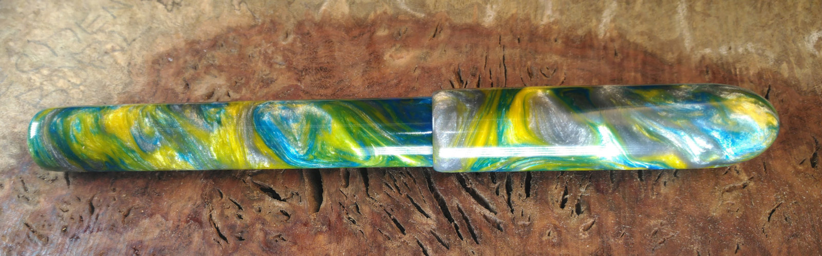

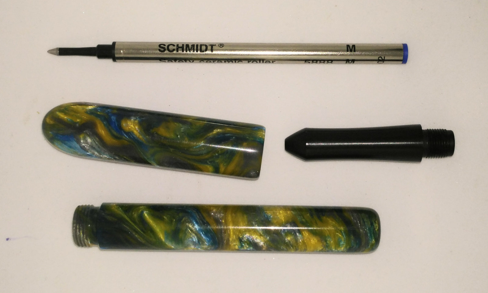

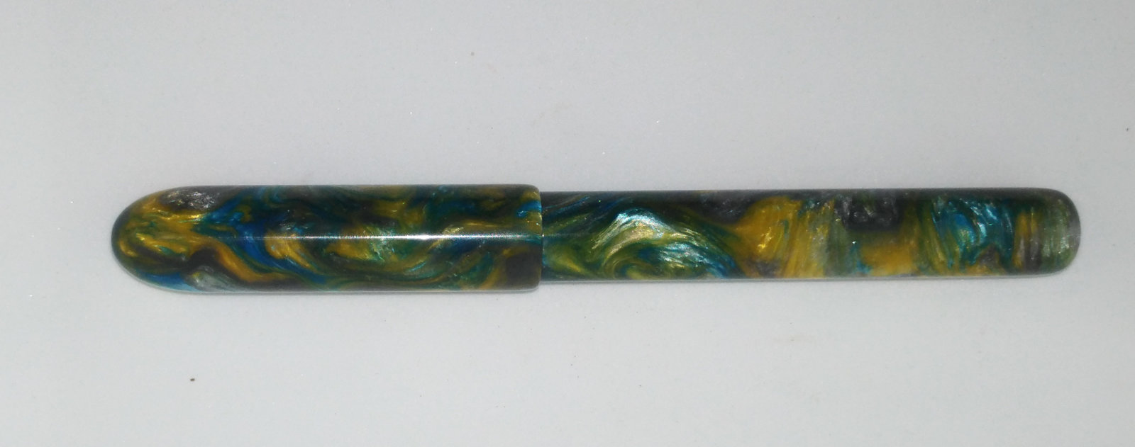

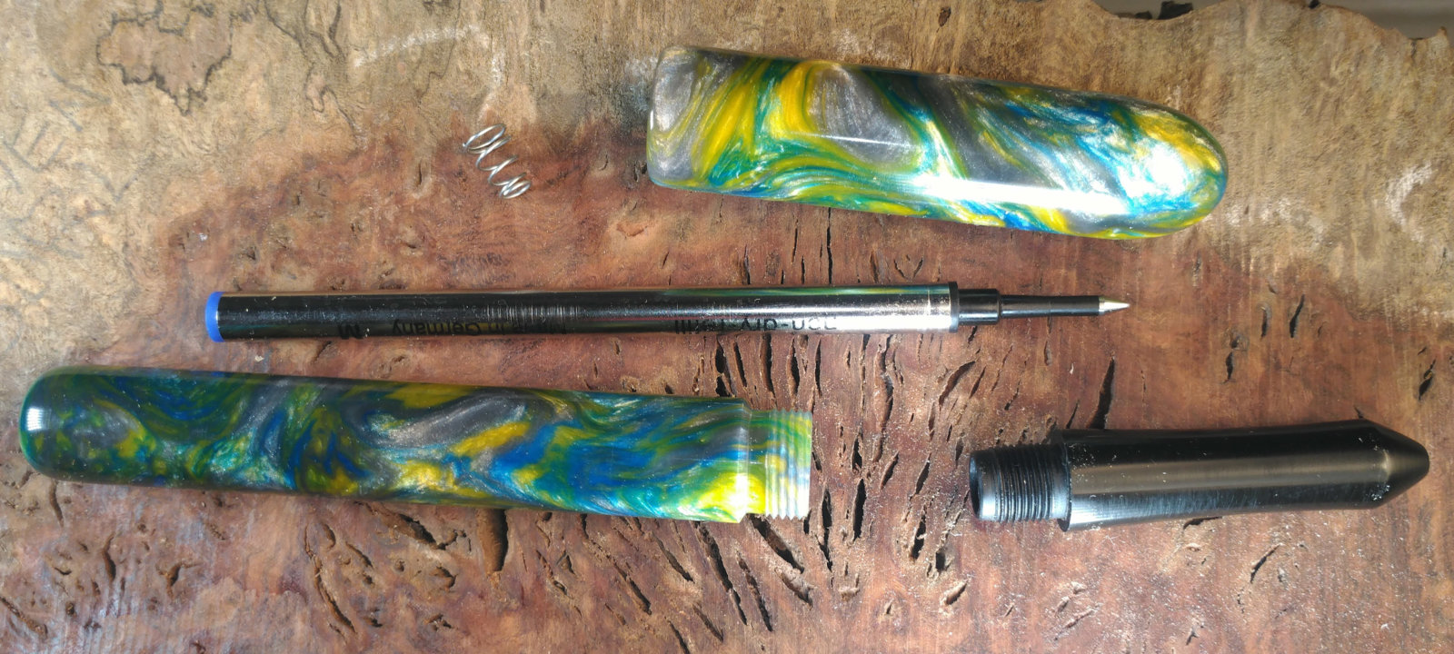

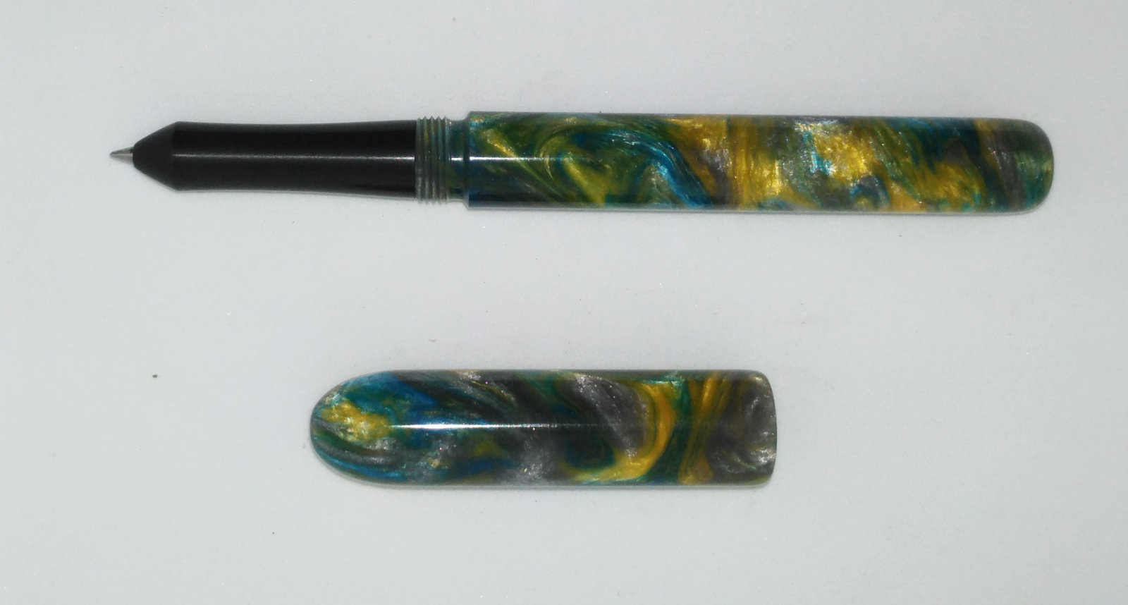

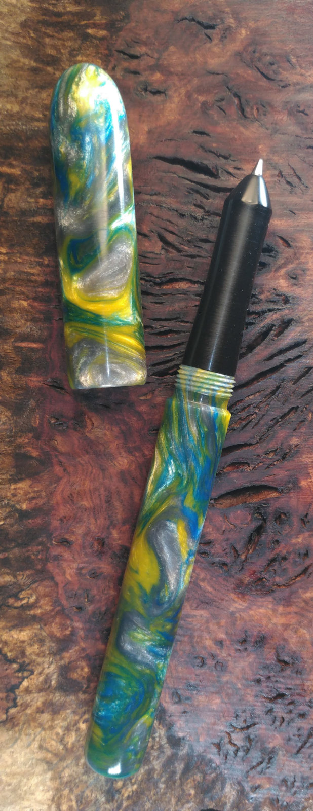

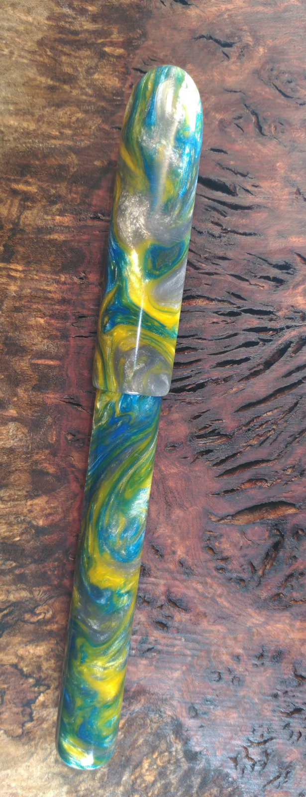

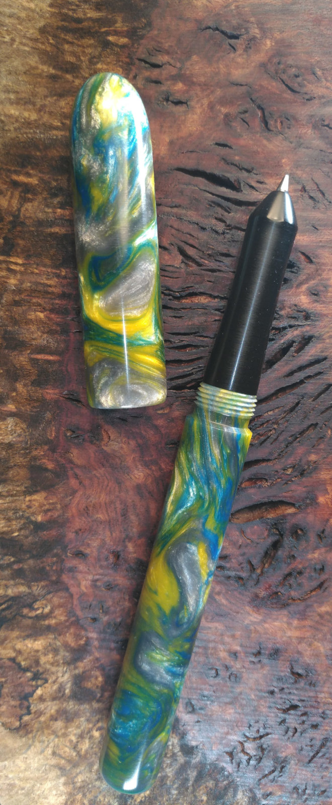

My first kitless using alumilite and ebonite. The ease of how alumilite turns was nice..never could get a good polish on it though.
The alumilite blanks are "Thors Hammer" from Exotic Blanks for the barrel & cap, black ebonite for the section. Its made for rollerball refills.
Both the alumilite and ebonite were very thread friendly, especially compared to the AA and rhinoplastic I had been using with my other pens.
Almost forgot, I also changed tap & dies. M13 x 1.0 for the barrel / cap with the section a M9 x 0.75 . I was using 1/2 x 20 and M10 x 1.0.
Thanks for looking !!

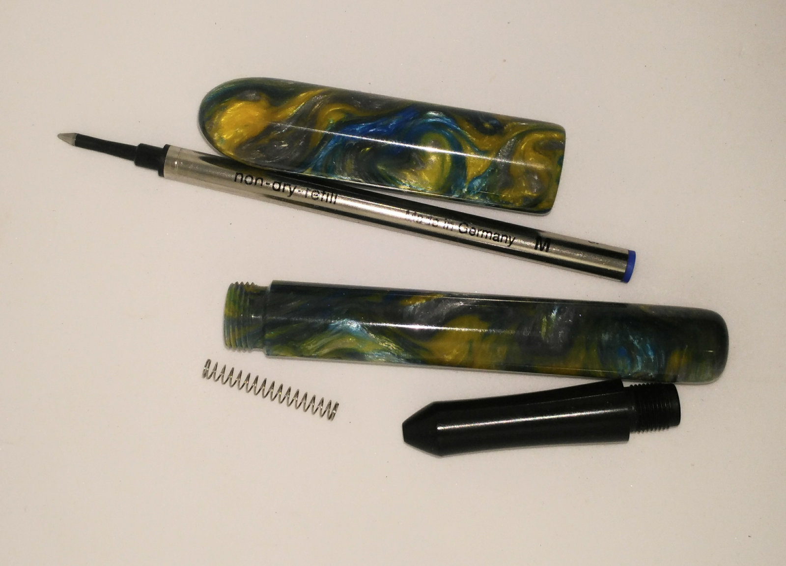

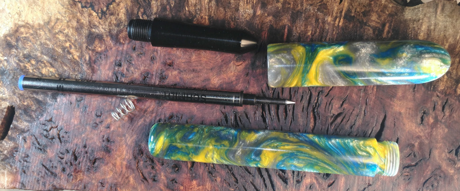

Fantastic looken rollerball. I do have question for you about the spring. It looks like a clicker spring if it is are you putting it at the writing end of the refill or the back of the refill?
Thank you !
It's at the rear, bottom of the barrel pushing the refill into the section....I had a rollerball spring in it, I took it apart to polish it one last time and the spring bounced under the cabinet...to be gone forever ! The clicker spring adds a little bit more tension than the smaller rollerball spring but it works fine.
