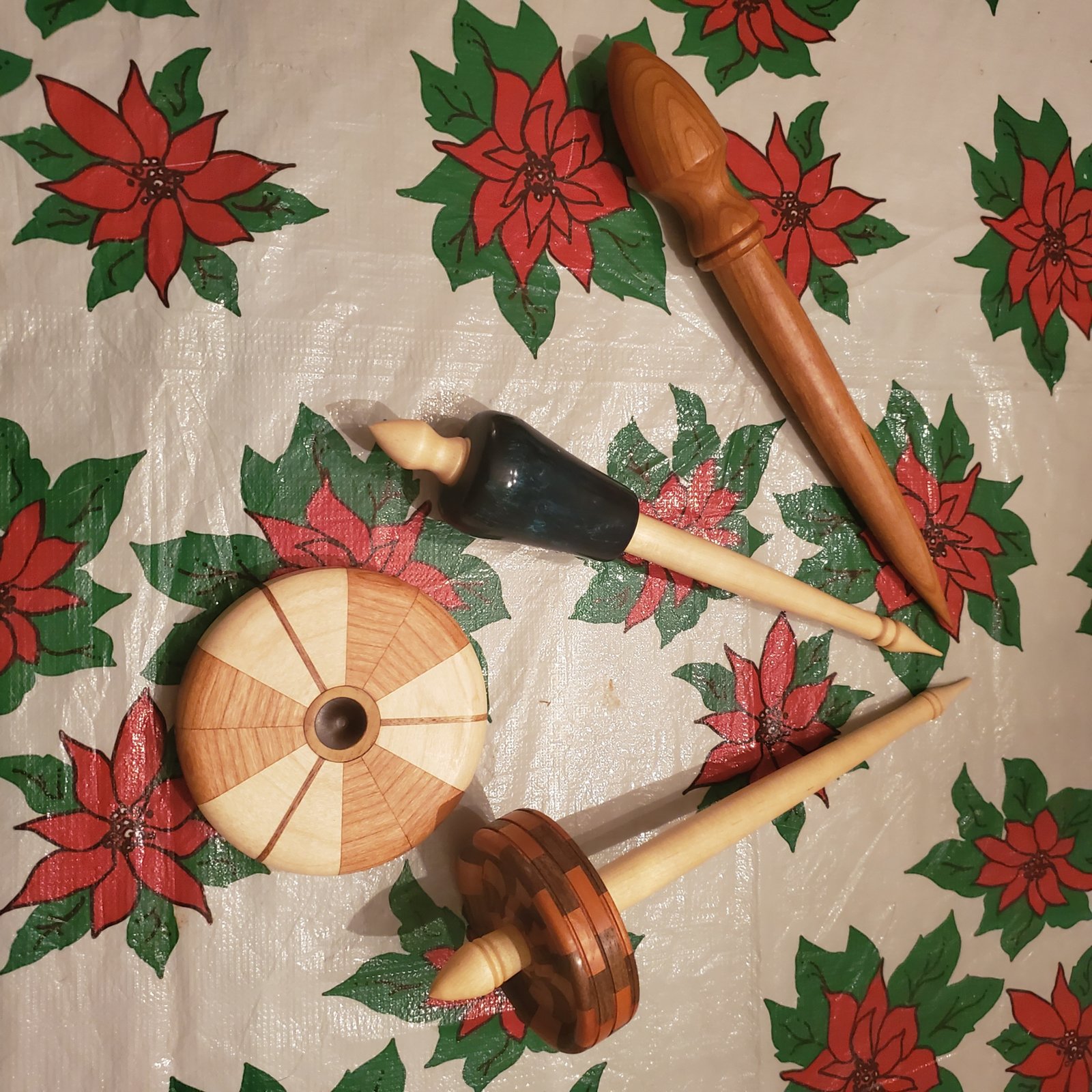

More yarn spinners these are Supported Spindles.

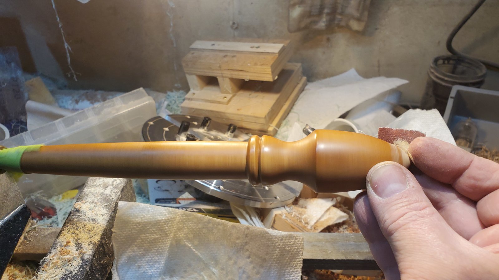

Would a piece of hose tube to stop the chuck jaws marking it not work? ie stick the end into a bit of hose then grip that in either pen jaws or outside jaws and sand to your heart's content?
chartle
Mar 13, 2015
1,287
Pgh, PA
Yes but was improvising. I used 2 layers of tape and no marring.
Also just needed to put a point on the end.

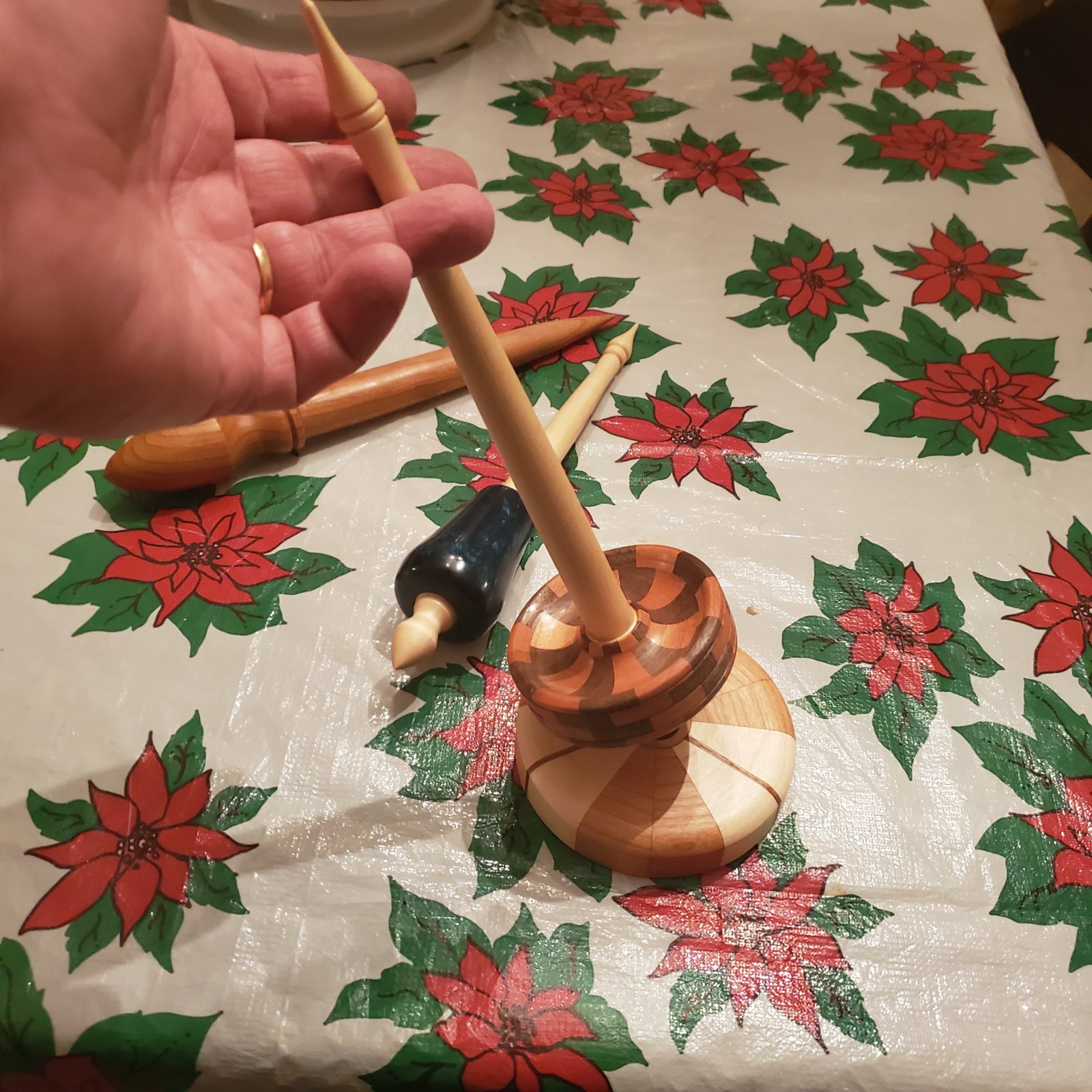

By the way what's the segmented base for ?
Look at the second pic. Its what you spin it on. In middle I used lignum vitae for the wear surface.
Also check the Spinning video I posted. The one i thought i cut out the audio of my son ordering Thai food.
Some use little ceramic bowls.

Thanks for that video. I have a mate in australia who makes " drop spindles" so wondered about the base.
Merry Christmas !
I've seen a dozen or so styles of drop spindles, same for supported spindles and even grasped spindles where the person just sort of spins the spindle in their fingers.

NICE! I'm really enjoying your segmented disks.
I cant afford big pieces of wood. 😉
But then again look who I'm talking to. 🤣
But really it adds a ton of "style" and I feel it's more stable than a single flat piece of wood. There is no side grain.
