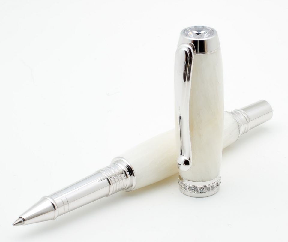

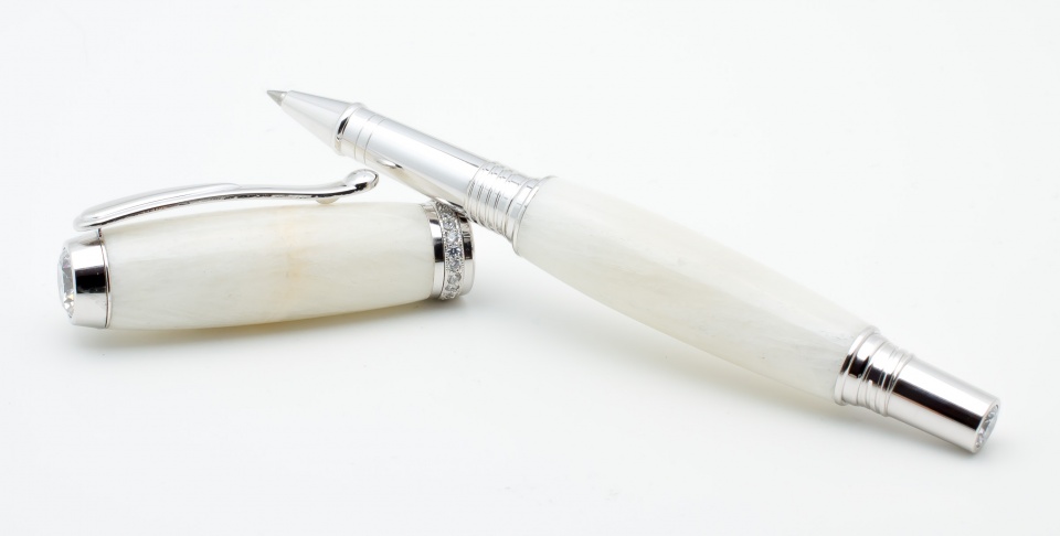

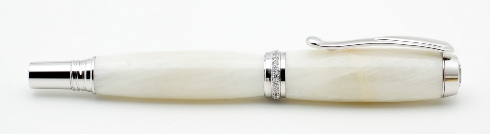

Stonework? Stone work (2 words)? Not sure which is right, but here is a sample of my latest stone pens. I'm hooked and I'm quite sure my mailman hates me for all of the stone being delivered to me LOL. This is just Alabaster but I have a few different types of marble I'm anxious to work on some more. Thanks for looking, C&C are always welcome.

Thanks folks :) It's really the kind of material you have to REALLY want to see the finished product, because the stone dust is a nightmare of a mess.
Magnificent Combination John.
Beautifuly Crafted Soapstone, perfectly matched to the Kit.
Your Fit and Finish is Superb.
I am glad I didn't have to clean up after you.
It would have been easier to see, if you changed the background.
White on White is not the easiest to see.
But I suppose that everything was covered in white powder after you had finished turning.
Congratulations,
Brian.
Thanks for the kind words, everybody. This kit was one that I was never really fond of, but when I got this piece of alabaster I *knew* it had to be paired together :)
Very nice. Have you tried jade yet?
Ed
Funny you should say that....I've been looking into it, but a piece big enough for a pen is beaucoup bucks. I have some crinoid marble, which I believe is a 5 or 6 on the Mohs scale and That was quite a workout. I suspect Jade will be harder, but a challenge I look forward to.
Thanks. Drilling has been a combination of HSS, Cobalt bits, and masonry bits I ordered from England (no metric size masonry bits here in the States). Cutting has strictly been on my wood lathe with carbide. Jet 1221VS...putting it through its paces :p I found the middle gear setting works best for stone, it has enough torque to push through and a decent low end RPM (the fastest I turn these at is 900 RPM vs. 3000 RPM for wood or acrylic, start the turning around 250 RPM)

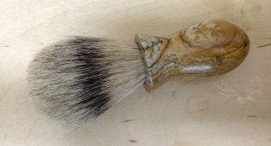

Here's a soapstone shaving brush I made late last year as a Christmas present:
Turned quickly, sanded quickly, but it makes lots of dust along the way (likely very similar to what you had while working alabaster).
