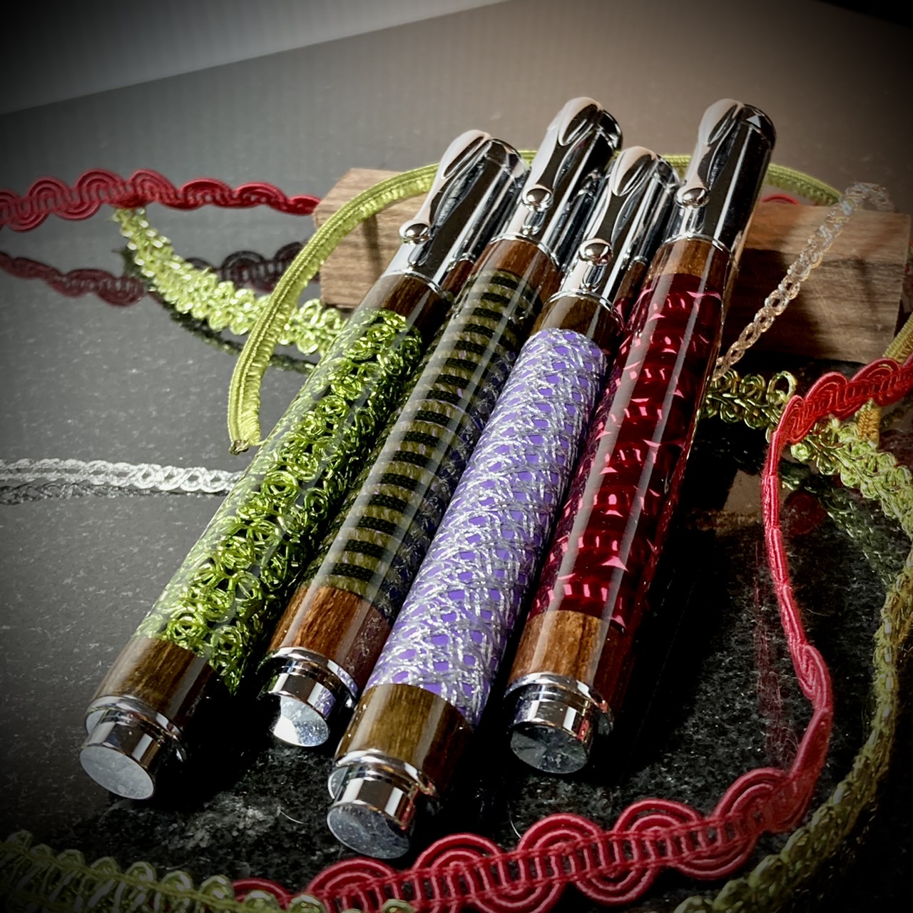

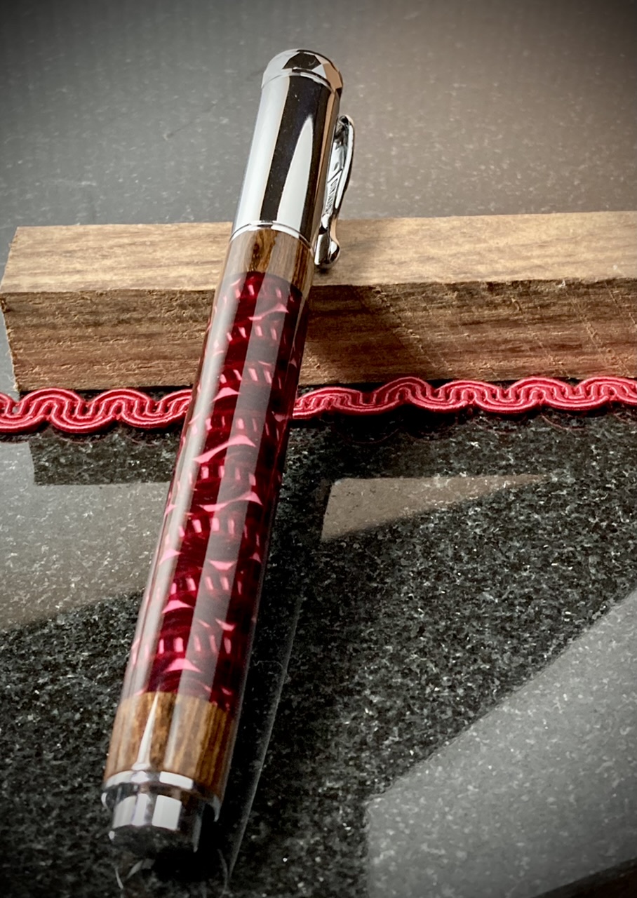

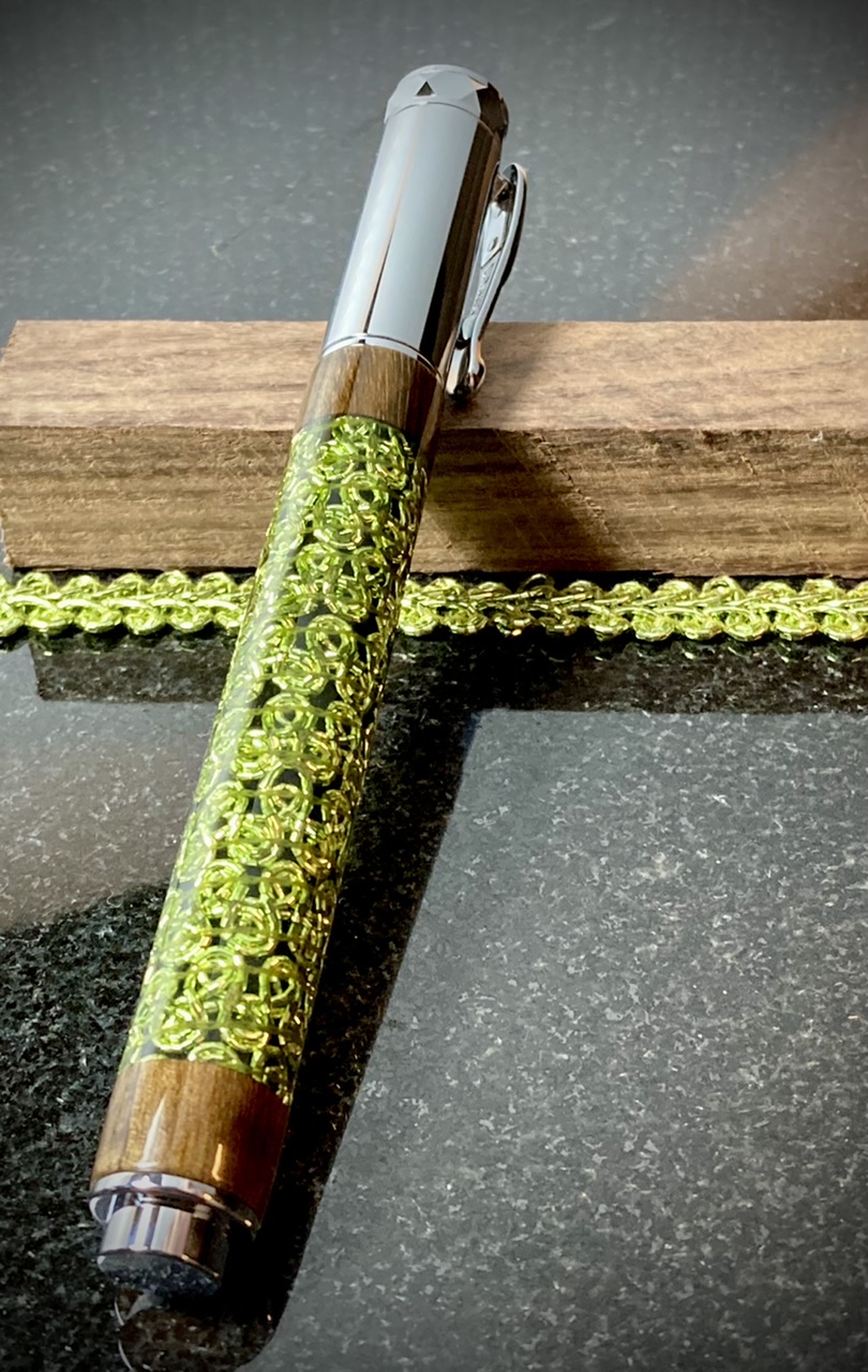

I'm continuing experiment with casting tubes wrapped in ribbon. I don't find similar technique on IAP or the internet, but perhaps I'm using the wrong searches. This cannot possibly be a novel idea. Maybe it's not done because really it's just not that attractive. Therefore I genuinely invite critique and comment.
There will always be something new.. Even if it was done before, but you never saw it - happens all the time! Your blanks are superb!!!!! They are unique for each and is very nice. I will add, some thought to trim rings to give a separation between your layers might be something to consider. Darn nice job! 👍 👍
I think the pens are quite attractive - seriously, they look really cool. I think you're on to something. I like Mark's suggestion about adding some trim rings - maybe aluminum, copper, or brass trim rings would look pretty cool.
Thanks for the inspiration!
If you can adhere it to a tube then it can be cast. As far as the chain thing, I bought chains a few years ago but never got to incorporate. Glad to see you do it and now gives me hope to give it a try also. The ribbon thing is a women pen so if you are selling you may want to gear your kits toward the female likes. Keep up the good work.
You're definitely onto something and they look great. I've seen blanks made using Japanese fine thread, but never with ribbon like this. Kudos!
I find the results most pleasing to the eye. The wooden top and base adds to the design in my view. I'm not sure whether a coloured trim ring at the base contrasting with or in some way tied into the design would be of use.
Great idea , well executed
It would be interesting to see how you start and stop the ribbon of you care to share.

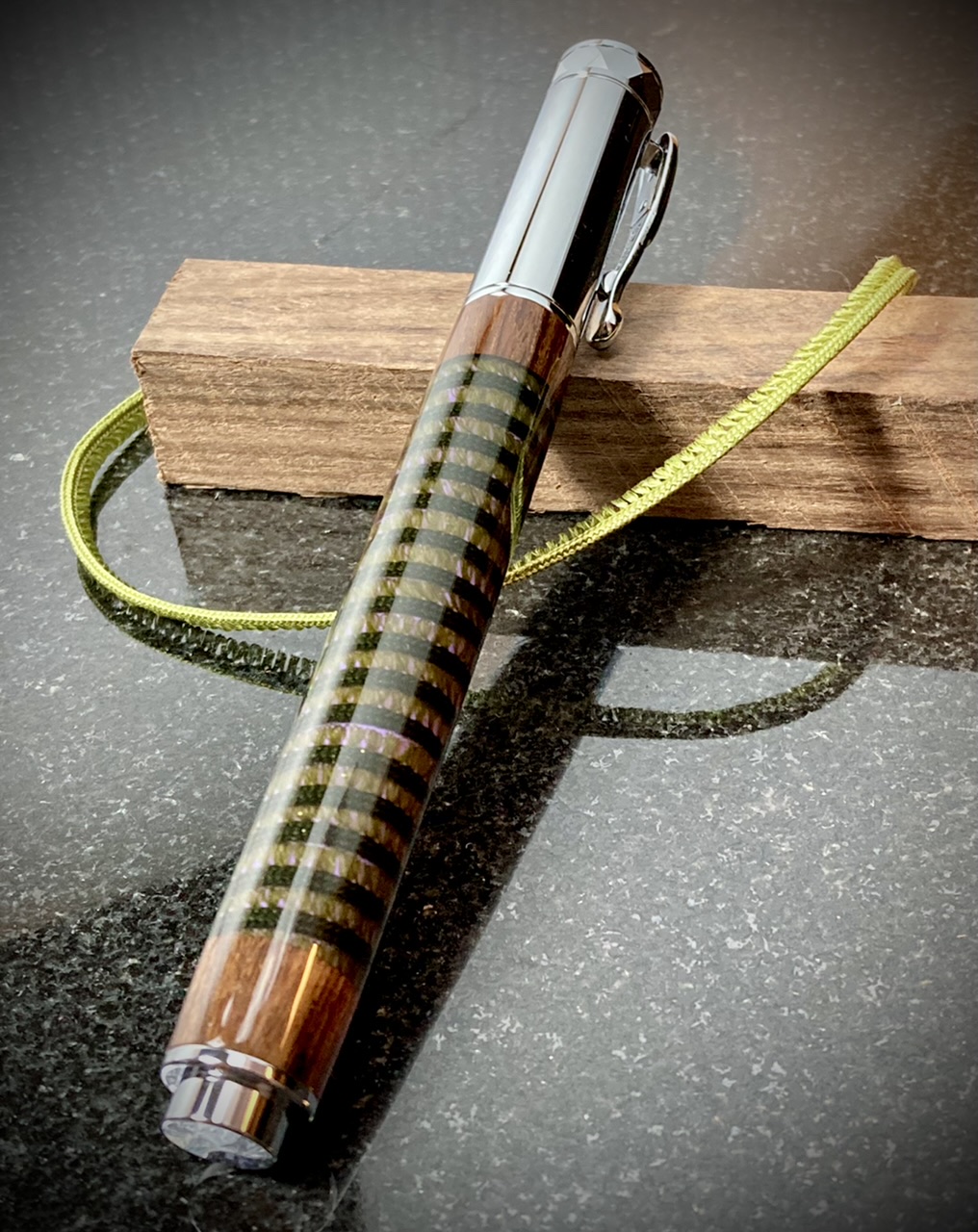

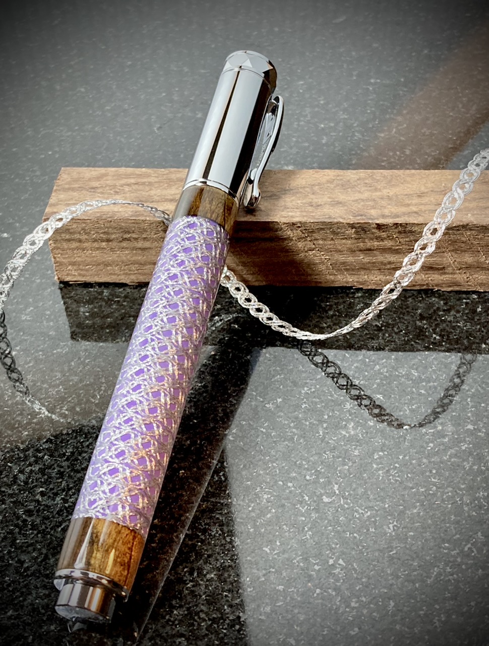

View attachment 341400View attachment 341401View attachment 341402View attachment 341403View attachment 341404
A unique idea. I think they look great. Excellent all around.
as a bit of a counterpoint on one of the pens I'd say that the light and dark alternating green one is giving a solid camo/parachute cord vibe to it. It might do well around an Army base, VFW types, etc
Bump.

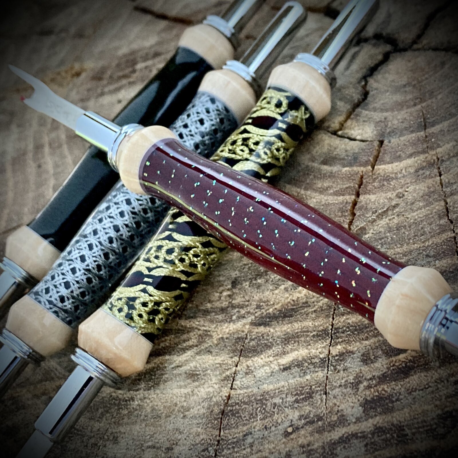

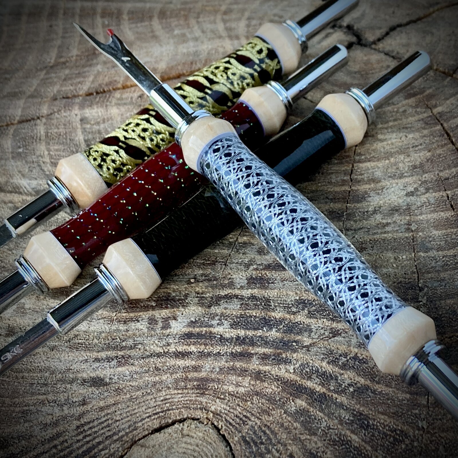

I decided the best application for this technique would be for seam rippers. I have a mothers day show coming up and realized I sold all my double rippers (I also did sell 2 of 4 of the pens shown above). Ordered more seam rippers and decided to make a batch using ribbon. The long handle is a plus, as is the extra thickness in the handle.
These have maple end caps and a thin pvc veneer separating the wood from the resin. Finished with CA and polished.

100% agree with you on this choice Todd. I may have to steal this idea (hope you don't mind):). Last year I bought a bunch of those seam rippers and planned on making a few. They sit idle for now but your ideas are intriguing.
Custom fishing rods have what is termed, "thread art." All kinds of patterns but the time needed would price the seam rippers waaaay high.
A simple pattern with one or more threads would be feasible. Thanks for the photos and it ideas. Imitation is the best indication of flattery.
