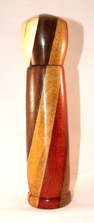

8 3/4", Marblewood, Walnut, Curly Maple and Muirapixuna (I think another name is Brazilian Ebony??)

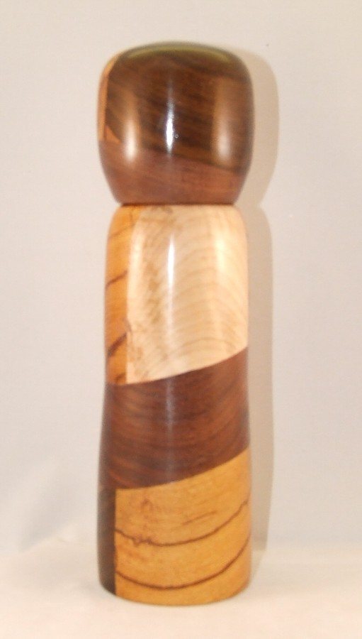

Walnut, Bloodwood and Wormy maple, 11" tall

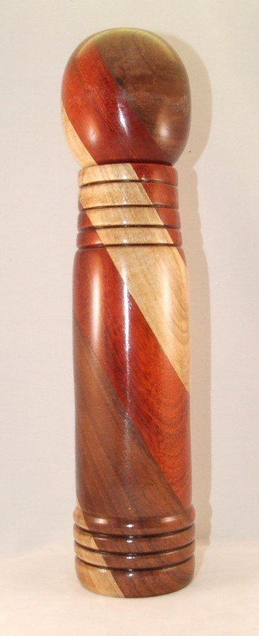

11" tall, box elder, Braz ebony, Marblewood, Bloodwood, White Oak, Cocobolo and Wormy maple

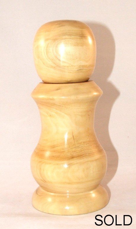

Tennessee River Birch..actually I'm pretty sure it's birch that I found on the Tellico River, the log was chewed on both ends like a beaver had cut it and the bark was stripped. The wood was soaked and water logged, so I had to let it dry for over a year before I could turn it.
