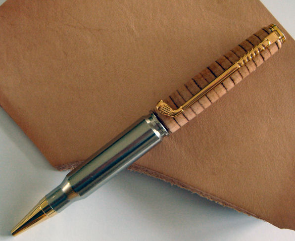

After reading some of the posts here with regards to turning leather, I decided to give it a shot (LOL). Stacked 1" square pieces of leather and glued together with Gorilla Glue.
Drilled blank for 7mm tube and used Gorilla Glue to glue tube. It turned fairly easy using a 3/8" gouge, made sure it was SHARP. Sanded leather to 400 grit, applied about six coats of medium CA and then wet sanded to 12000 with MM.
I had some left over parts (.308 shell and golf club clip) and put this together. I've got some more glued up and will try other kits.
L8R.

Very nice. NOw we need to figure out how to market the pen. Leather Pens?? Maybe they would go with leather whips???

Truly special pen L8R to acheive such a result makes it seem an easy process but my thoughts are this leather is both thick and physically strong. The pen would be attractive to anyone golfing, owns strong leather belts, ever rode a horse with a leather saddle, endless sale situations including stockwhip users, shooters, sporting groups, target shooters, recreation shooters, people on the land ad infinitum. Quite marketable to most people IMHO.
Reminds me sometimes chance can play a huge part in discovery and invention. With you having items in hand in front of you and then actually visualising this could set a trend in pens. I know I hear you say this has been done before however you have done it now.

Now before I finish your pen pleases me I am not a Golfer, nor a shooter but admire good carefull workmanship, it inspires me to follow through on my aims to do different pens.

Thanks all for the comments. I have a few more ideas I am going to try. I have some wafer thin pieces of 'Corian' I might glue in and maybe try some staining. Got a bunch of leather scraps that I paid little for.

We did one where we alternated leather, purple heart at 1/16th inch thick, leather, purple heart for the barrel. Came out exceedingly nice with the high gloss finish.
