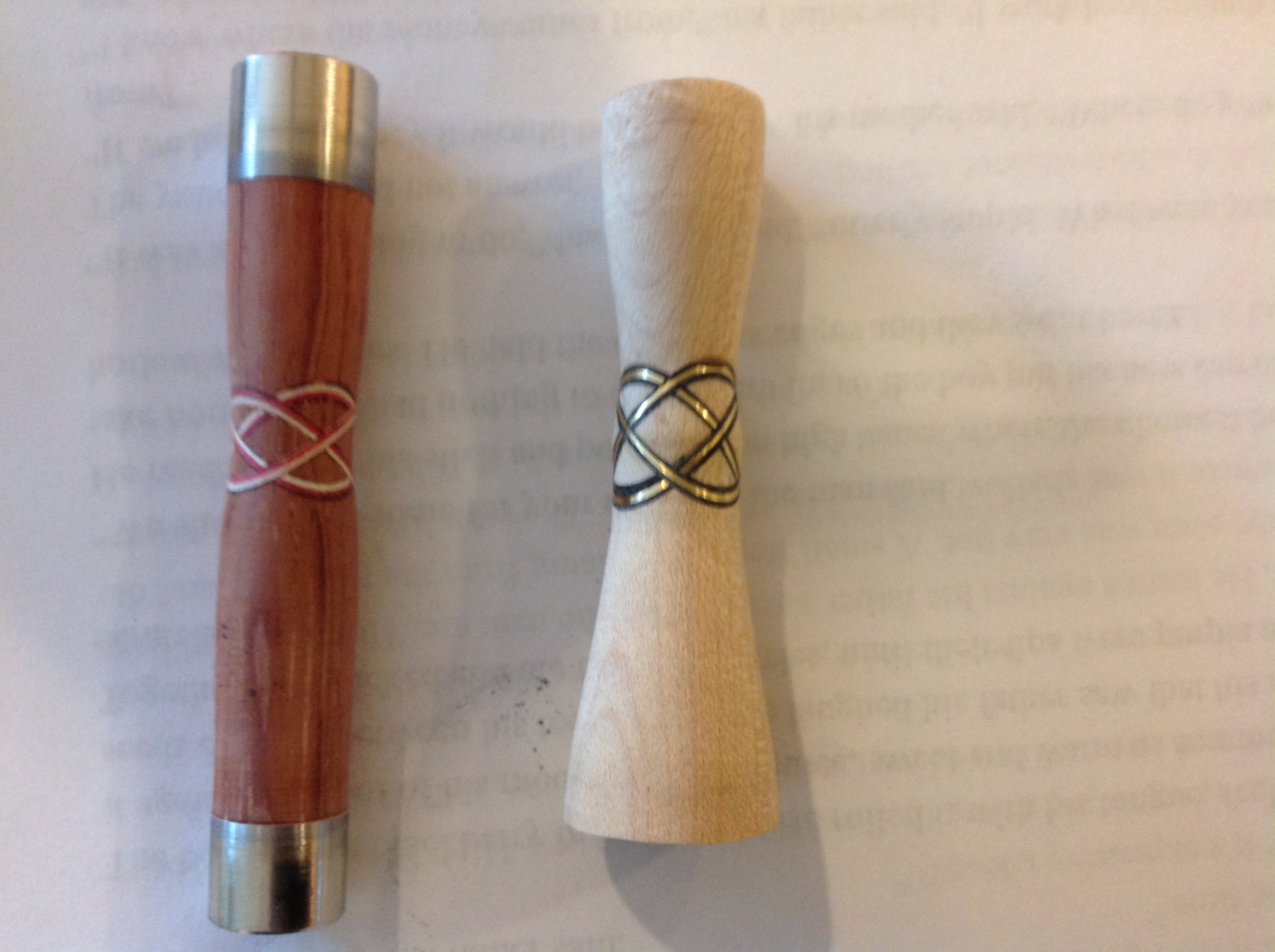

I have tried, so far, 35 and 45. Pic on left is 35 with the bushings, pic on rt is 45.
I used 3/4 inch squared pen blank on both.

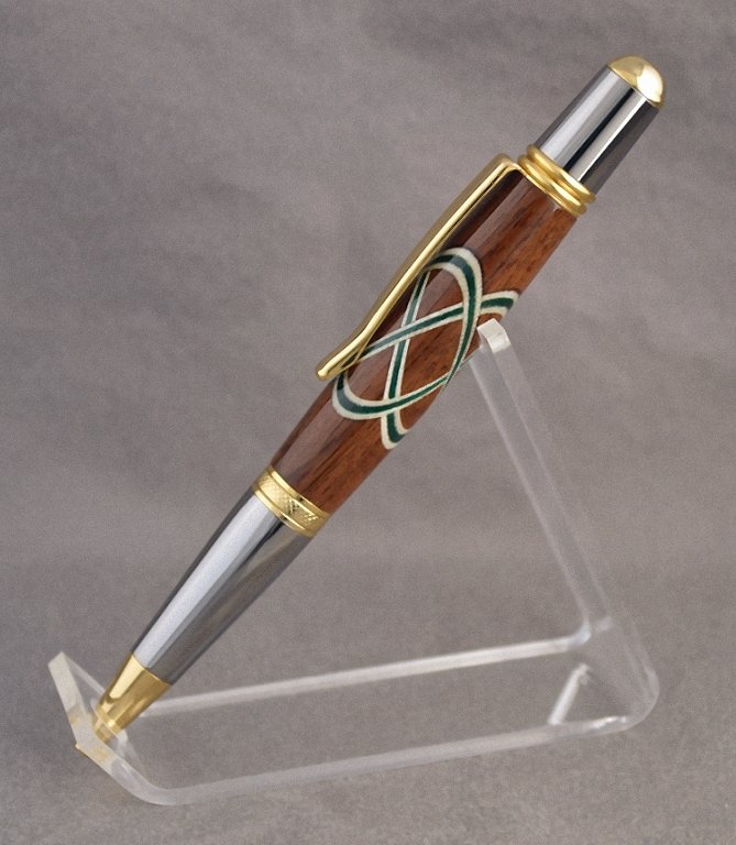

I think 52° is about right for a Sierra or clone. That's also what I use for the upper on a Cigar.

In the left pic that you posted, you used 35 degrees for a double knot. . Looks good to me (if alignment is improved)
In the right pic, you used 45 degrees and I don't like it as well as the left, but it is OK and looks attractive enough.

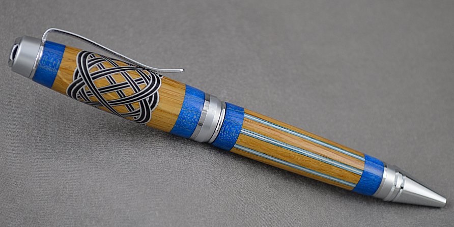

In Brian's first pic using 52 degrees for a multi-loop knot (I think it is 8) and it looks terrific and I think he won a prize for that pen.
I assume Brian's second pic (Sierra) is also 52 degrees and, again, it's terrific again, for, this time, a double knot.

As I am new to Celtic knots, I'm trying to figure out what is the right angle or size of blank that I need to turn down so that the finished knot is bigger around. The pic on the left, I had to turn down too much to see the complete knot. You understand?
The starting size of the blank doesn't determine the size of the knot. Whether 1", 7/8", or 3/4" the size of the knot on the finished barrel will be the same, unless you decide to settle on an inelegant, portly, finished barrel.
The more acute the angle, the smaller the knot.

Most of the time, I start with a 7/8" blank. For the 8-loop above, it was slightly less than 1" because I needed to mill it to an octagon first.
