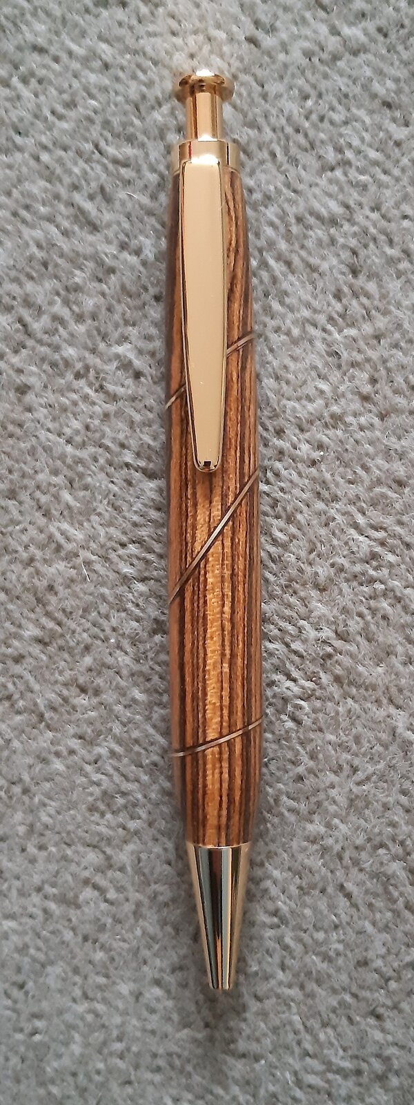

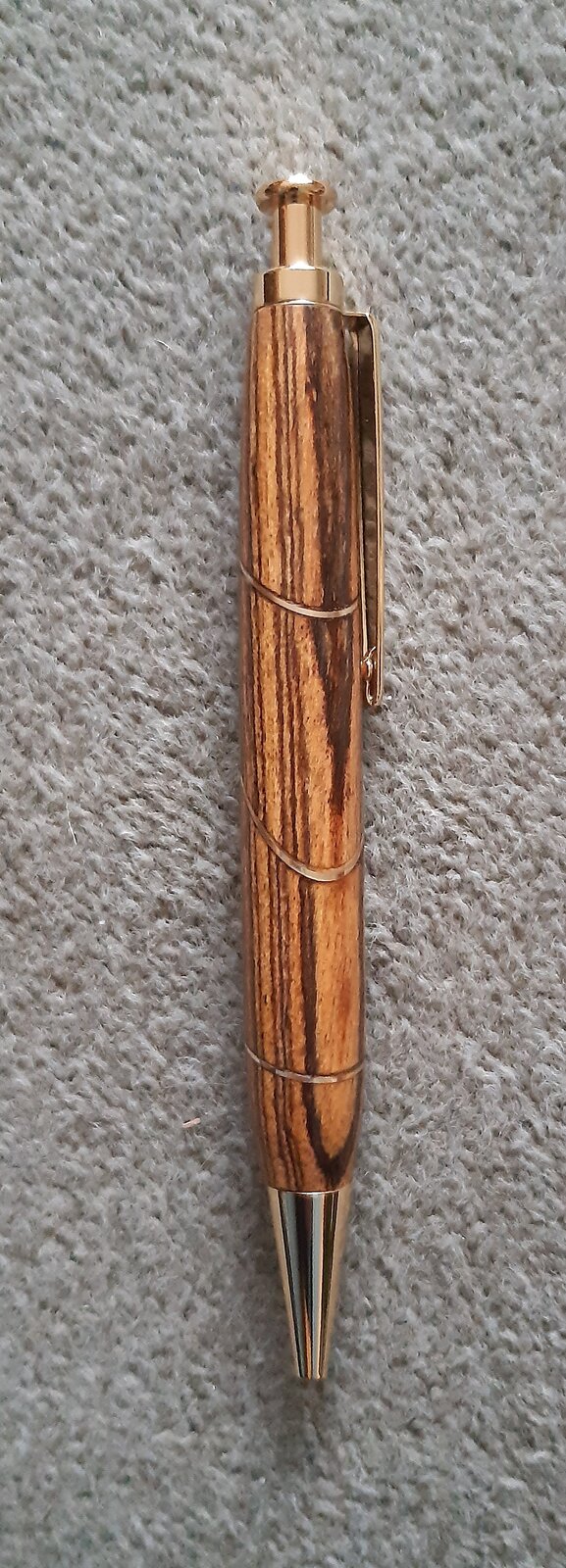

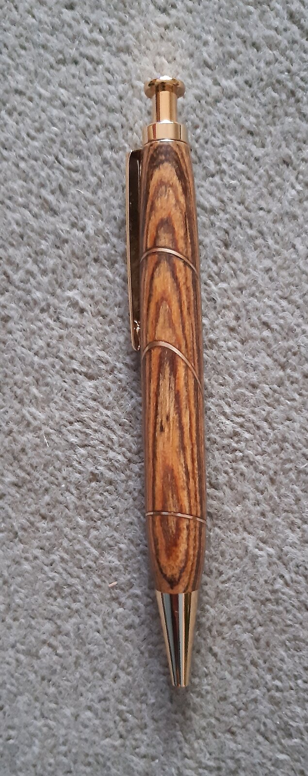

Another attempt at a Brass insert with a new expensive Epoxy Gfex 650 from West Systems. Still blew out on drilling repaired with CA even using a smaller drill first. But the CA held.
So now I am confused I've read use Epoxy other than it has a longer cure time.
I will give it another go but not convinced. I sanded the Brass and cleaned it.
I like the finished Pen. As always your comments are always appreciated.
