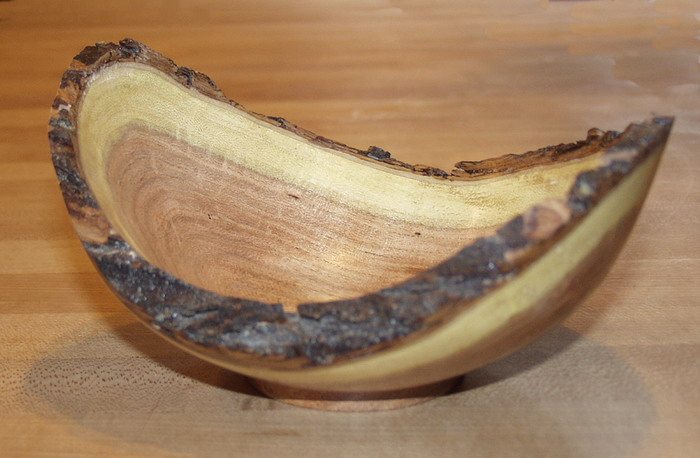

Natural edge 8.5 by 4 inch Mesquite bowl

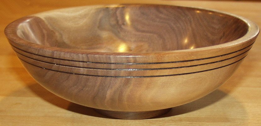

6.5 by 2.5 inch Walnut bowl from mature tree

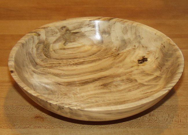

8 by 3 inch Spalted Hackberry bowl

I like all 3, but really like the spalted hackberry. The mesquite bowl, which is probably the ligthing looks unfinished. It also looks like it has some tool gouges in it. Not that I could turn a bowl anyways.
Now that I look harder it's a race between 2 and 3.
Question though. Out of curiousity to someone that hasn't turned a bowl. Why do most I see (even other places) have such a short height? Just the size of your stock I guess?

Thanks guys. I agree with you concerning the natural edge bowl finish. I use a friction polish and it is hard to do with a natural edge because the outermost parts will put a pretty nasty cut on your hand if you are not careful (I speak from experience). I did most of the sanding and the friction polish by hand because of this hazzard. The picture is deceiving - there are no tool gouge marks. Guess I will remove the wax and apply a spray poly to this bowl. Bowl height is determined by the blank to a large degree. I rough turned these bowls about a year ago I was pretty new to turning and I turned a 1.5 inch tendon on the bottom for the chuck (safety factor since then I did have the occassional catch). Now I think I will start recess chucking and that will add at least an inch to height. Also you can glue a piece of sacrificial wood to the bottom for turning a tendon. A lot of the wood from a tree trunk is unfortunately waisted when you turn a bowl.
