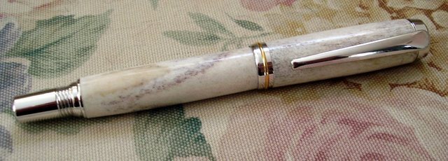

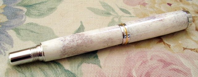

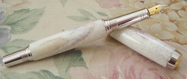

Thanks to Roy for the moose antler - here are the pre-engraved pictures. This pen will be sent to Ken Nelson on Monday and I Will post engraved pictures in a few days. Decided to upgrade the pen when I saw the quality of the antler.
40 thin coats of plexiglas to protect, but not to completely cover the texture.

Thanks for the nice comments! Brian is right - rhodium Jr. Gent with postable cap.
Grizz, my finish is plexiglas dissolved in acetone. I put 40 coats on the blanks in about 3 minutes, then use Micro Mesh wet to polish. There are several posts about plexiglas finishing here on the site.
Usually, I put on enough plexi to completely cover the blank. For this pen, I wanted some of the texture of the antler to be exposed.
