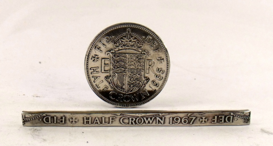

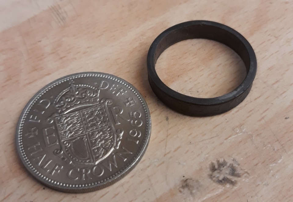

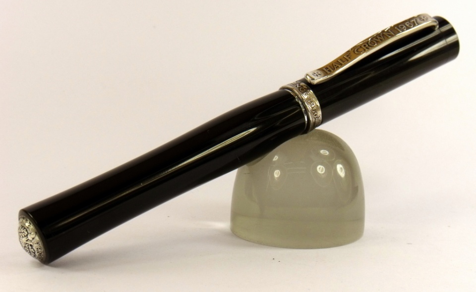

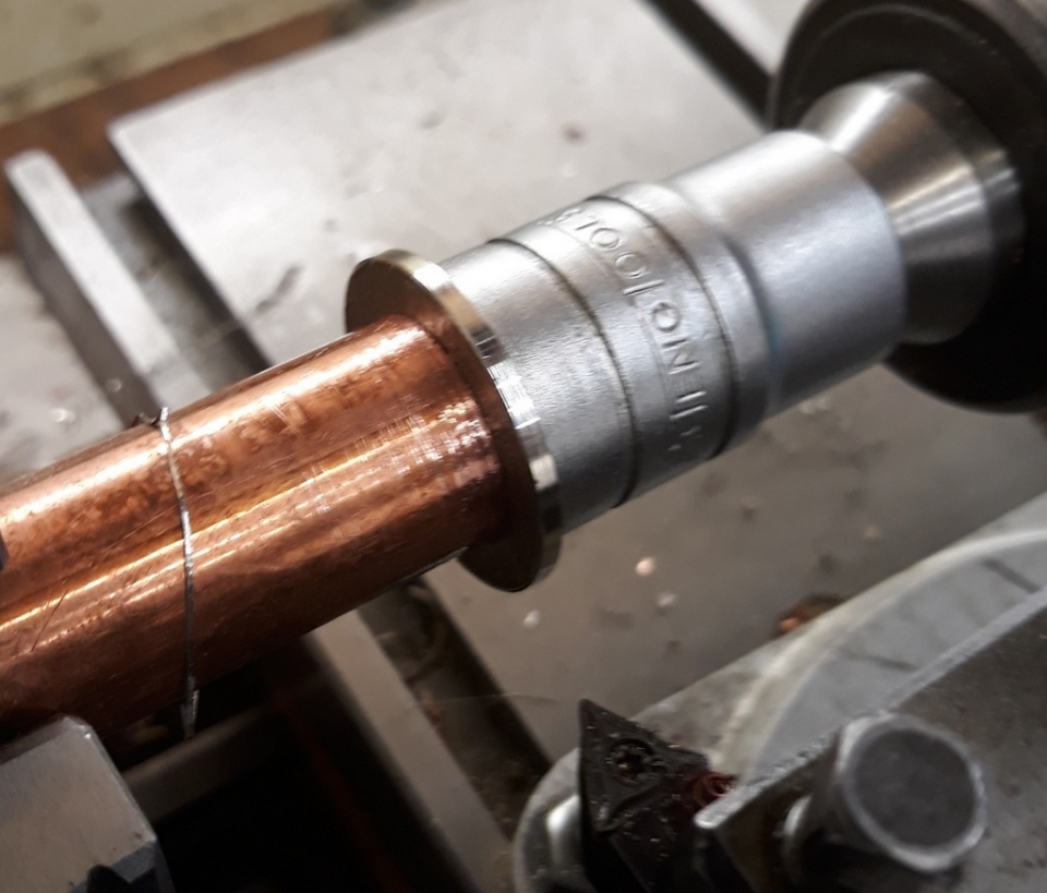

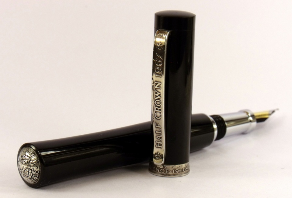

A few weeks ( months, actually !! ) ago, I had a play with making finger rings from old coins. I made a couple
I went on to say I'd like to see if I could make a small enough ring to be used as a center band on a pen. The smallest I could make with the tooling was just too big.....but I eventually got there..:biggrin:
My wonderful wife is in Swaziland with 14 teenagers from her school for the next three weeks.......so PLAY TIME in the Rat Cave !!!:biggrin:
This pen uses the FP section from a Spring Blossom ( I think ) but the rest is custom. The clip is from a 1967 Half Crown ( with reeding removed), The cap ring is made from a 1960 Sixpence and the finial is made by simply doming and recessing a 1936 Thrupence.
It was great fun to make and I learned a lot. Although not flawless, I'm pretty pleased with the way it came out. I hope you like it too.

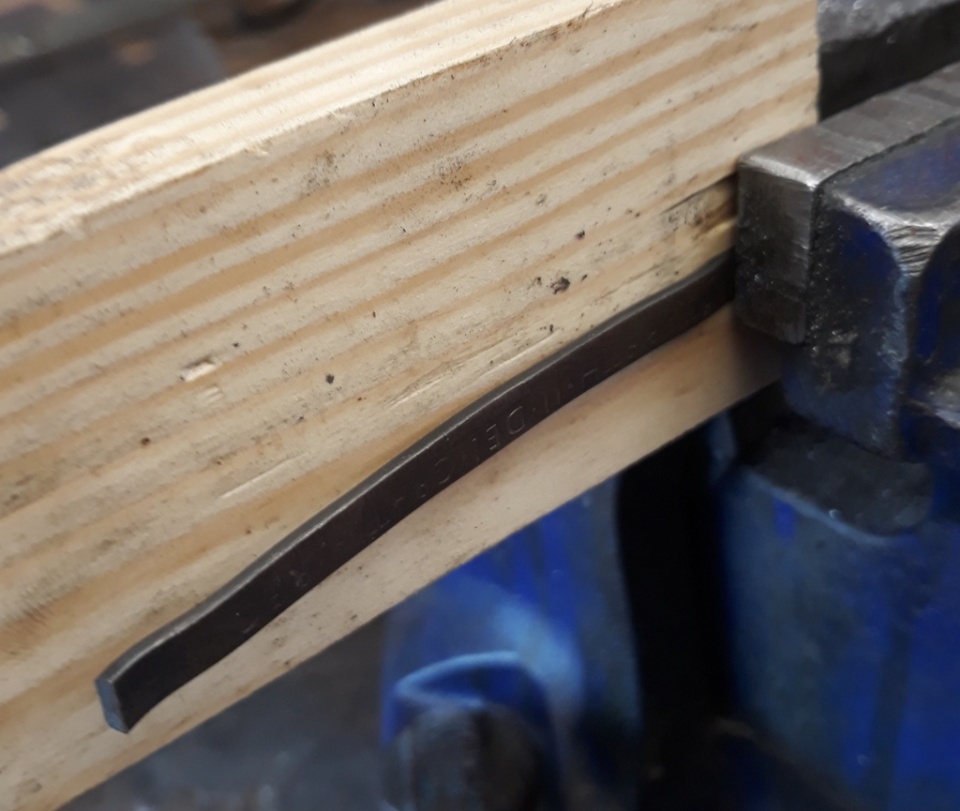

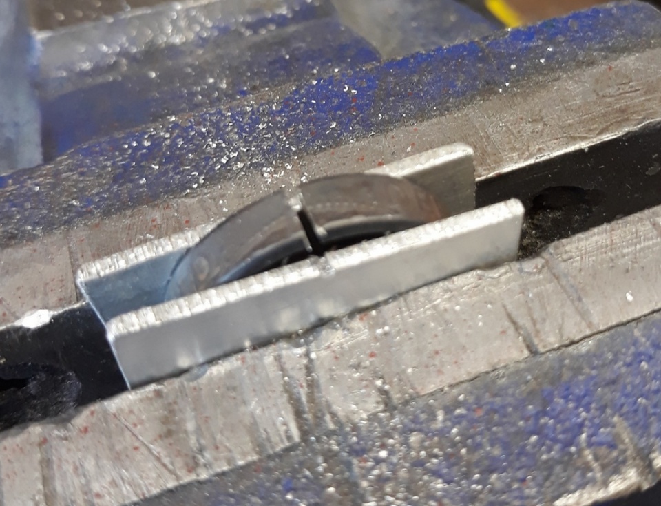

Here are a couple in progress pics..:wink:
A few months ago there were a couple post on here about money rings. I wondered then if it were possible to make a center band for a pen, but I knew it was something I would never pull off. As usual Skip, you exceeded what I expected someone to do and set the bar very high for others to try. That is an exceptionally fine work of art and it does not surprise me that you made it. I always thought a copper braid body with penny accents might look good but the dark body give your pen a much better contrast in character. Awesome work!
That is just beautiful. I love the clean neat appearance, it really highlights the coin accents. I wanted to agree with your comment on another thread that simple is better. But a better reference is that "Not too busy" is what I mean; nothing simple about this.
Superb.

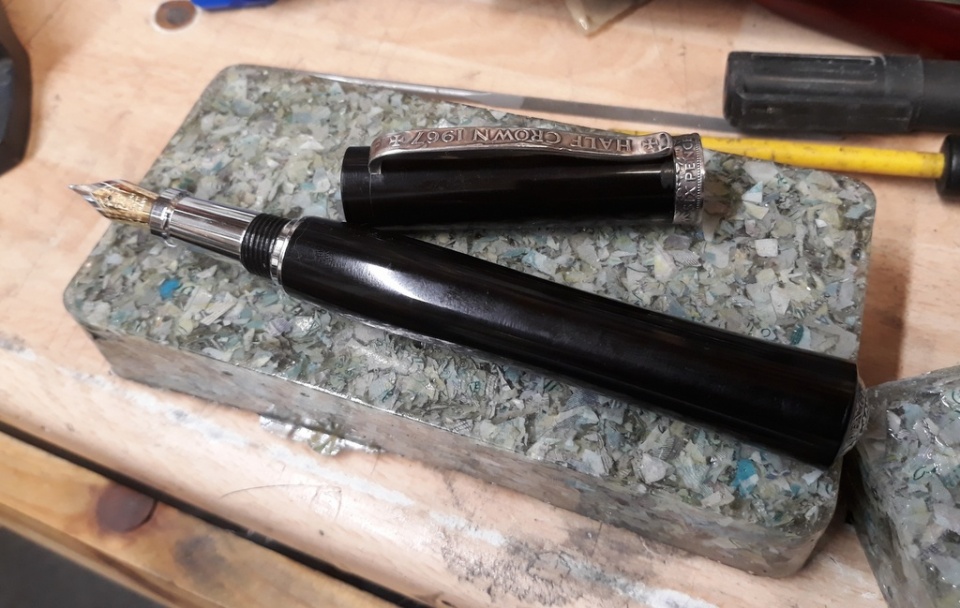

Edit In; Quick pic with it before being polished up, with the shredded fiver blanks....would not have worked:biggrin:

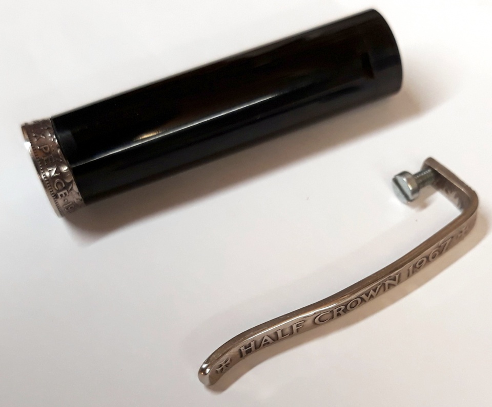

That is fabulous. Just fabulous. What did you end up with for ID and OD on the cap ring? And cap threads? This is a lovely, timeless pen. Congratulations, Skip.
Greg, I bored the ring to suit the Spring Blossom kit. I replaced the kit clip, cap ring and finial. Perhaps I misled. Those are the custom bits. I also had to extend the cap length to accommodate the clip length. There is also a small brass plug in the end of the cap which I used to anchor the clip. The clip is threaded to 3mm and as the screw is in from the open end, the clip can be removed.
I'll take a quick pic and add it to this post..
Back in a mo...:biggrin:
Edit In; Pic added
