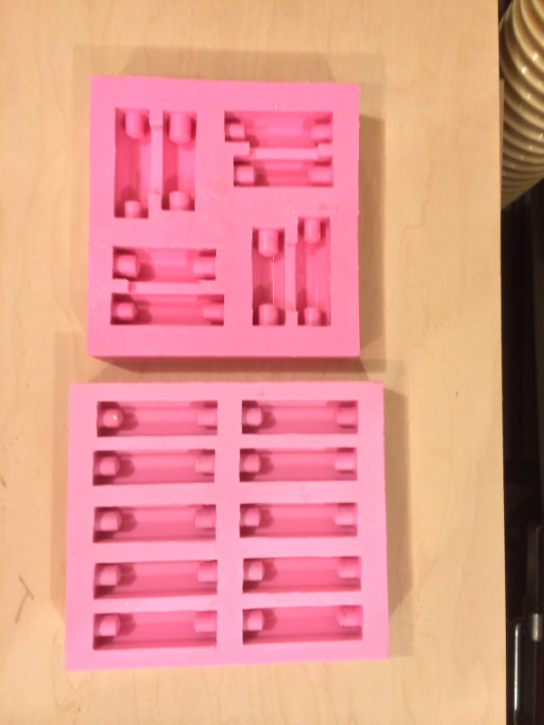

got pics of those molds?
It depends on the size of the moulds you make and on what you make your wall and floor thicknesses. I get approximately 6 or 7 multi-cavity moulds that will fit in a standard pressure pot. If you want to make a number of different size moulds you can use the calculator that SmoothOn have to get a better idea of how much goop to mix. It is below the Technical Bulletins and MSDS links under the column "How much do I need?".
They are similar to the resin saver moulds. Nothing special or unusual.
