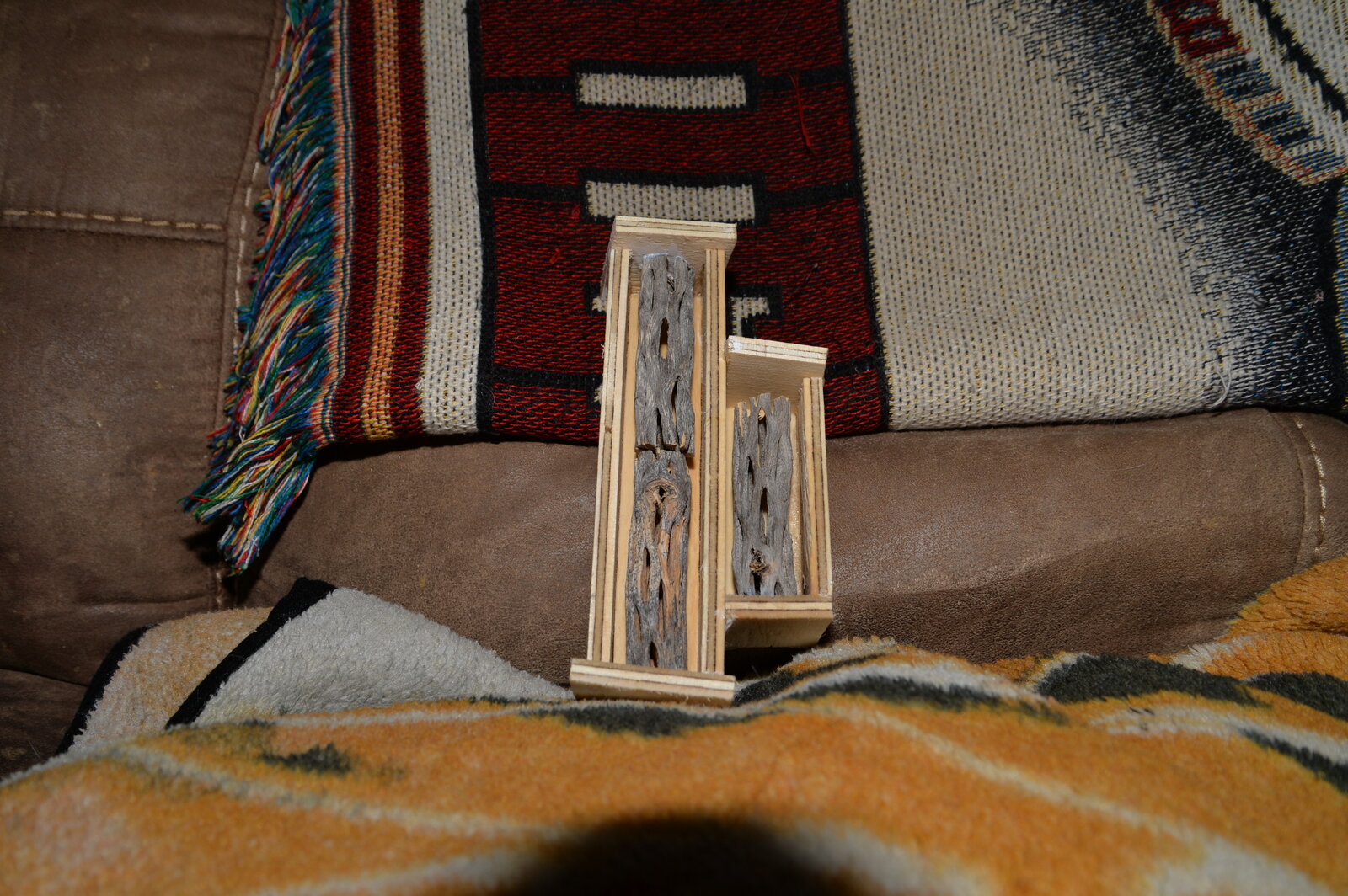

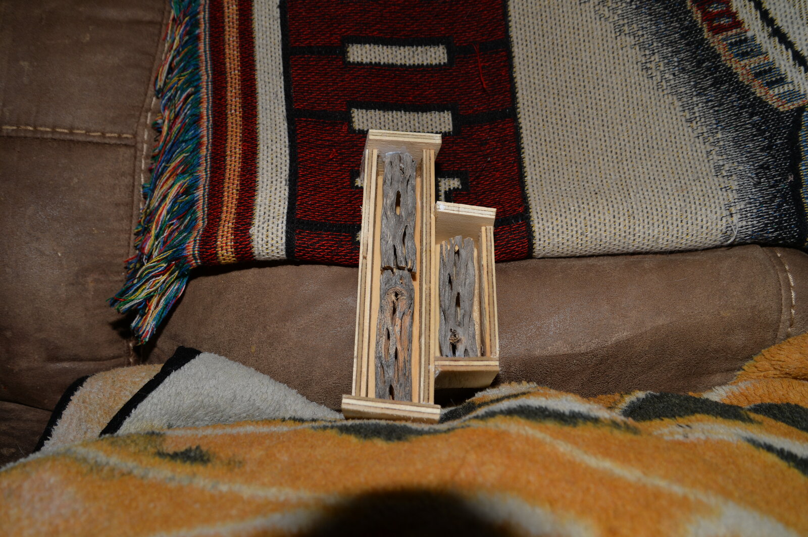

not a pen but for a set of darts using Alumilite clear slow

thanks, everyone, got it all sealed and letting off-gas cheap plywood works for now saving up for something nicer

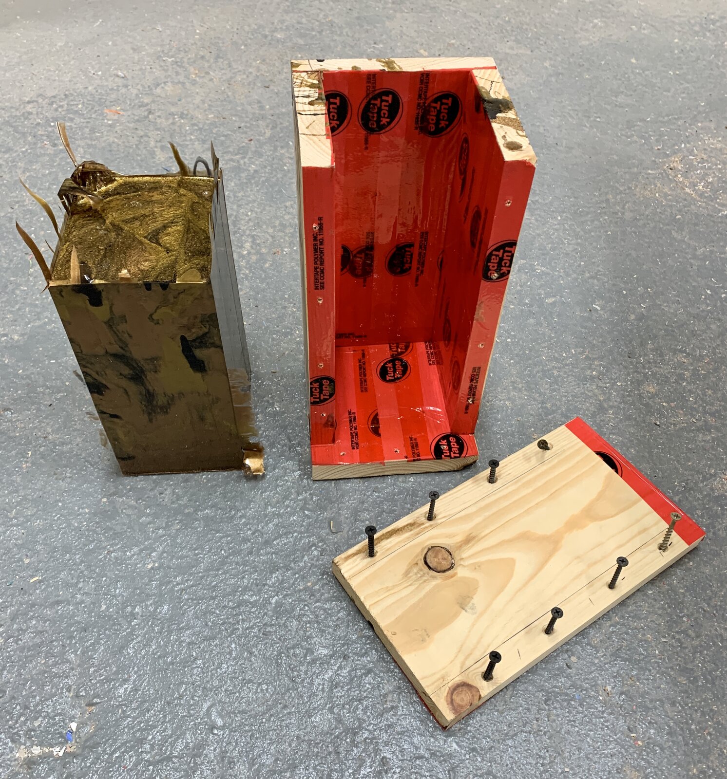

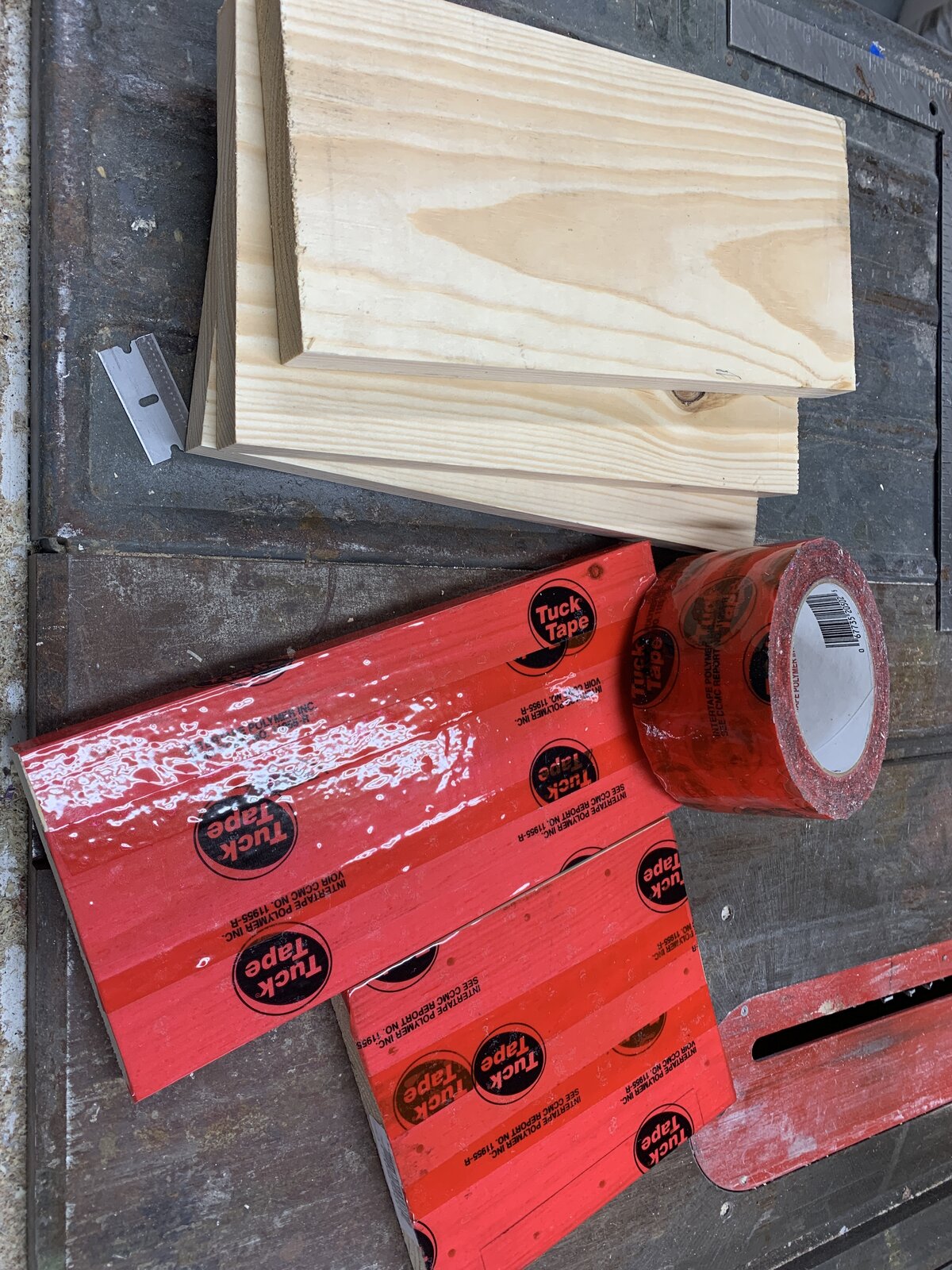

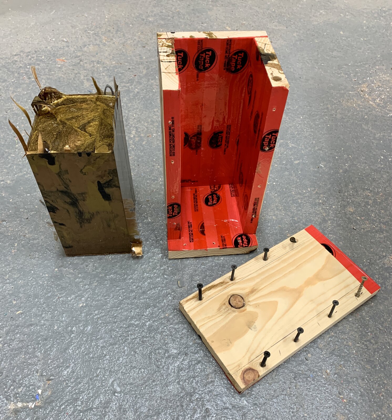

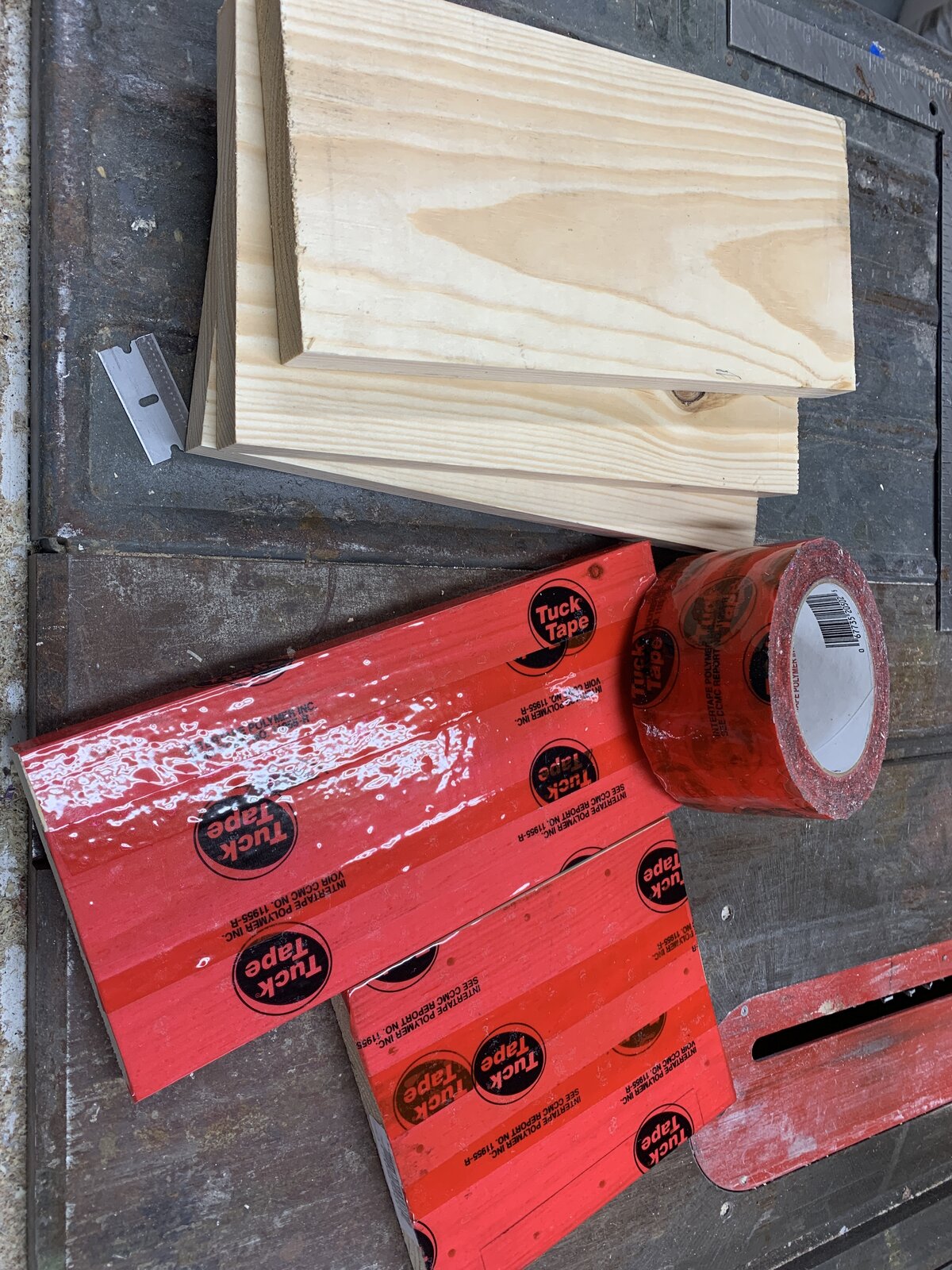

I use wood for molds all the time, especially larger custom molds. If you cover the inside of the wood with Tuck / Sheathing tape, and spray a little mold release, the resin block slides right out for reuse of the mold, and you can use it to seal the seams. It's quick and easy.
