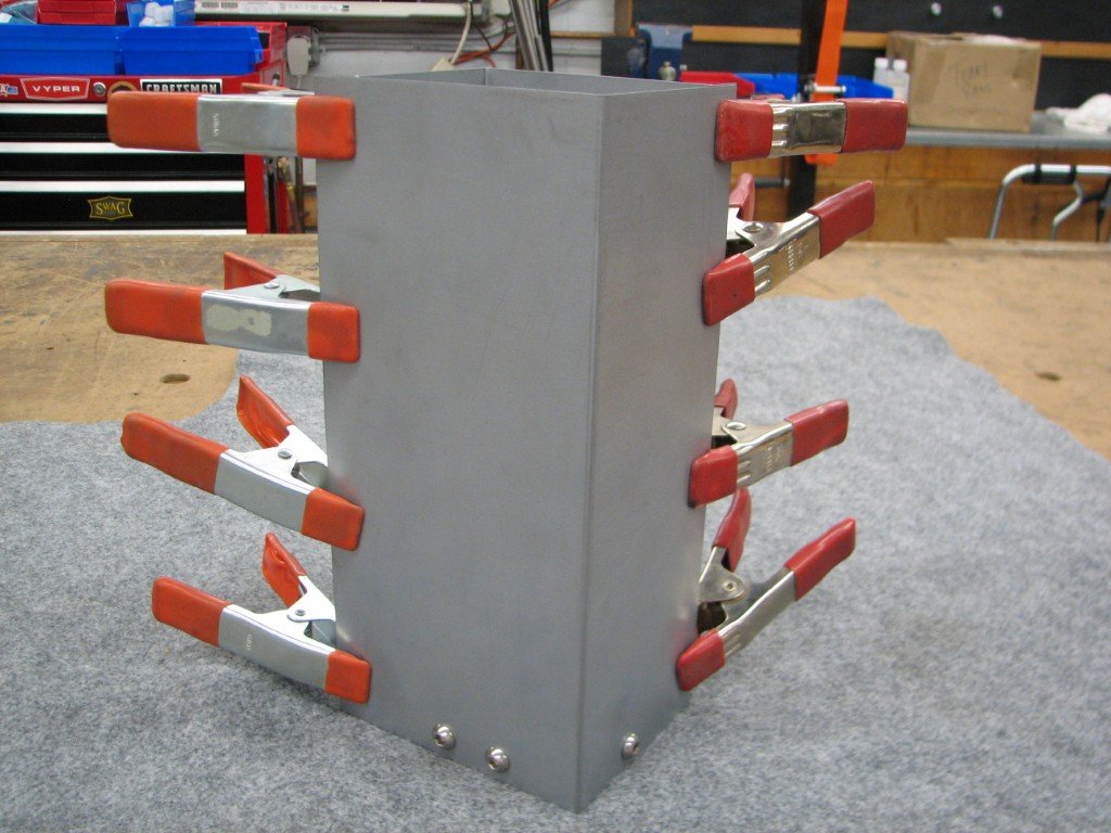

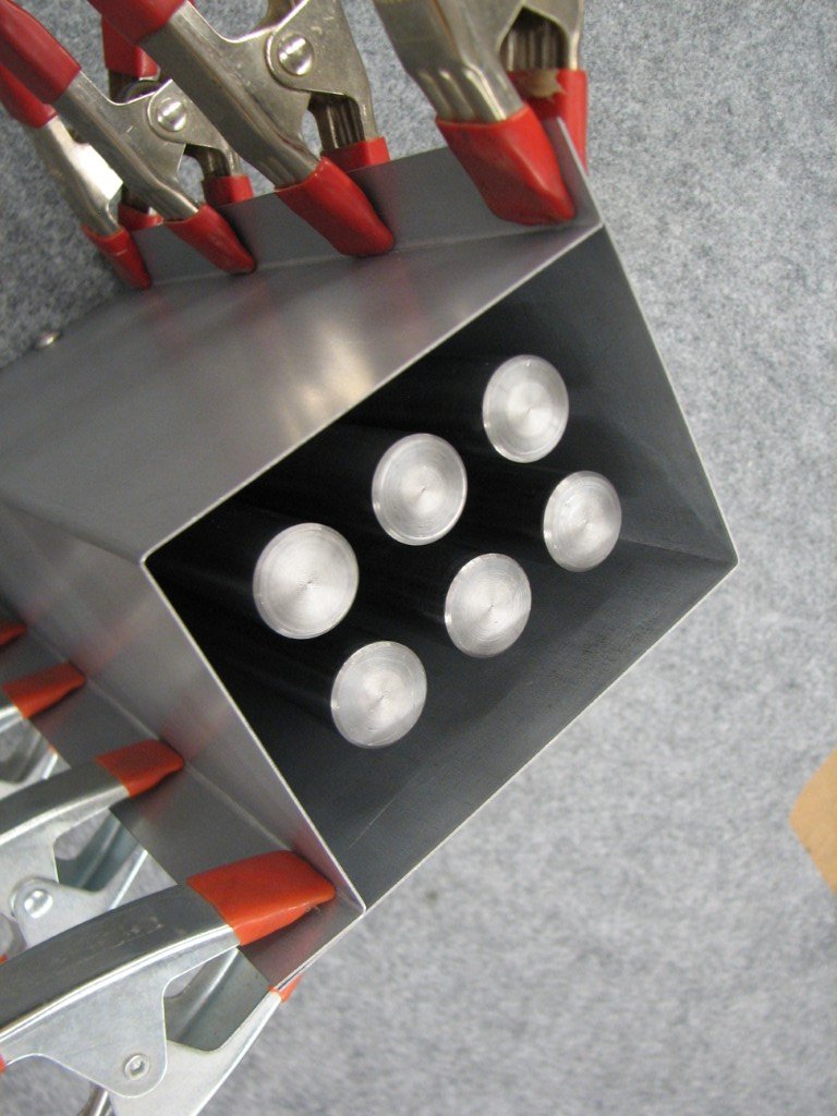

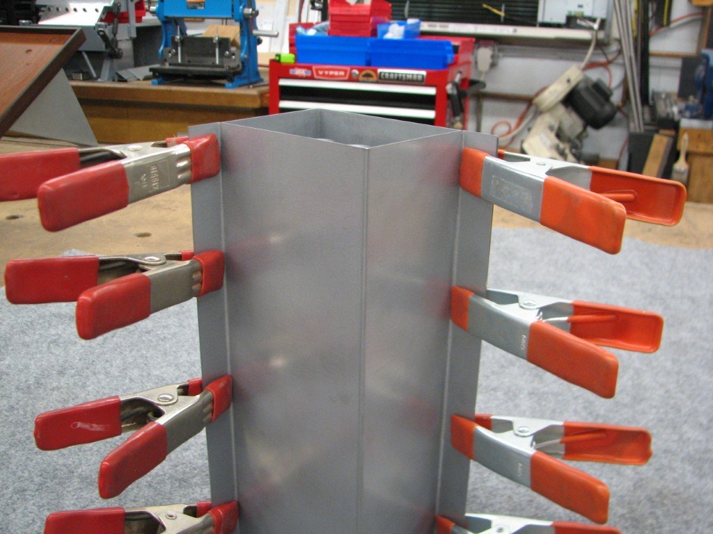

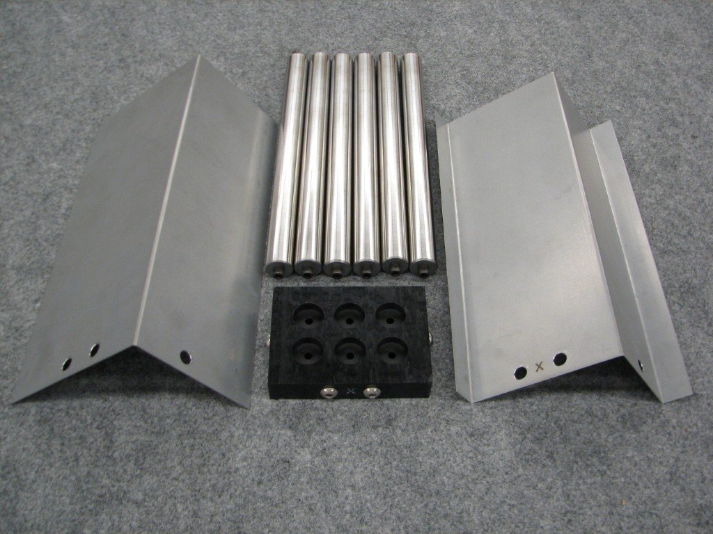

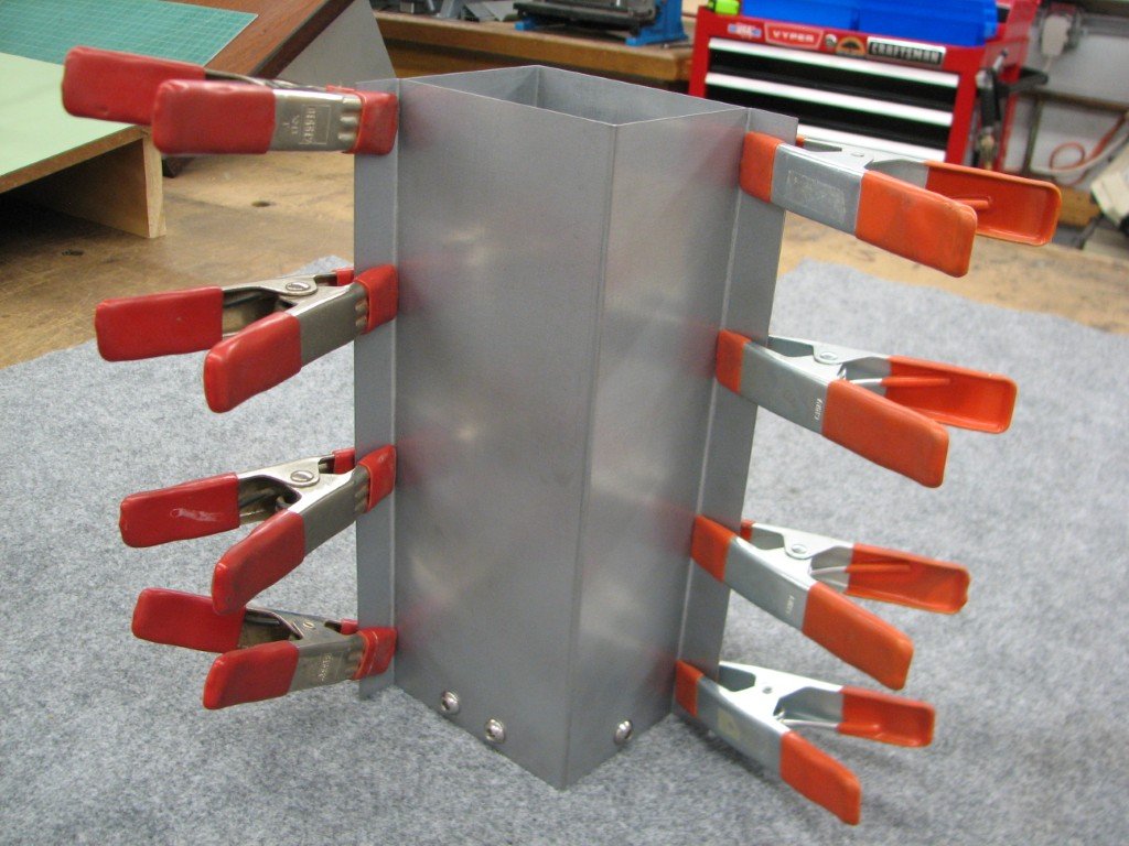

I made this for a well known pen company, he called it a "mold backcast" so I'll take his word for it.

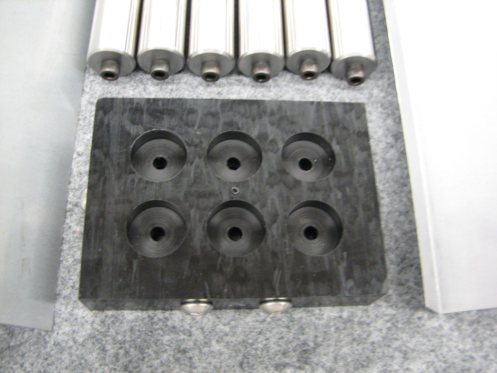

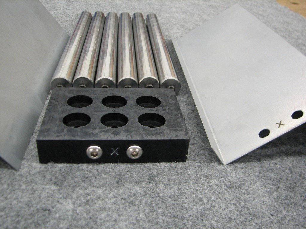

The shell is 24ga. galvinized steel.

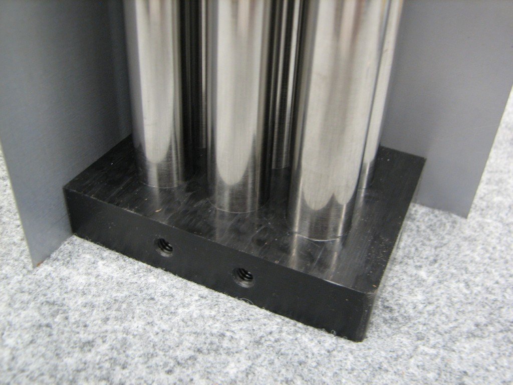

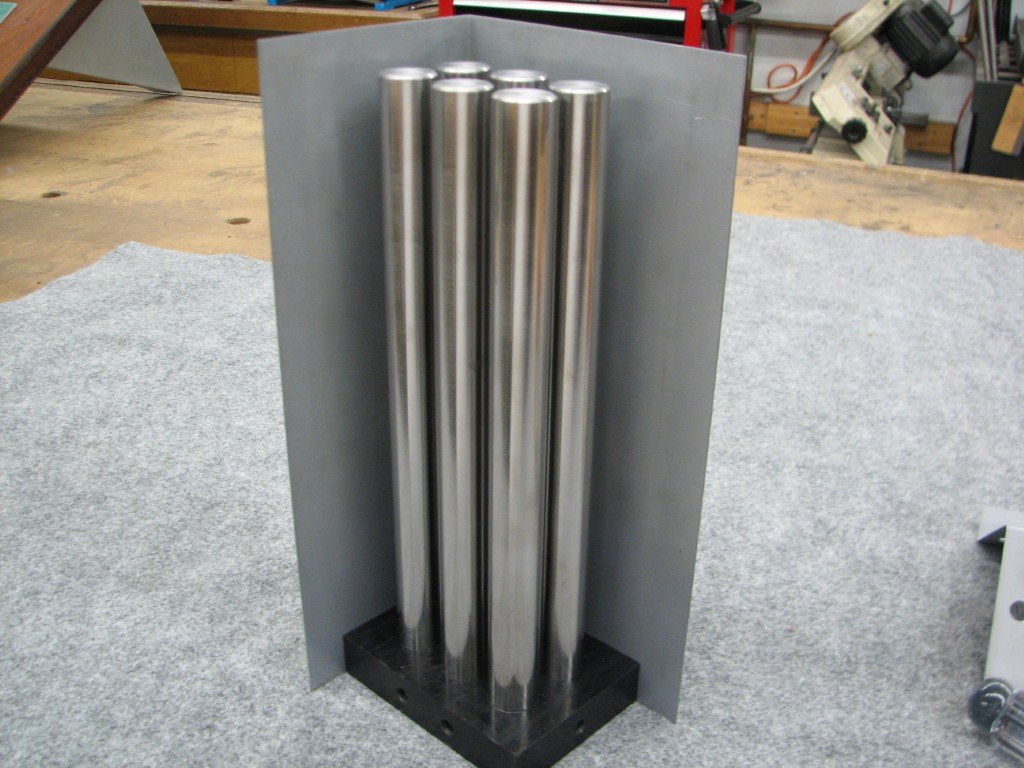

The rods are W-1 Tool Steel, the same material that my toolrests are made from, polished to 800 grit.

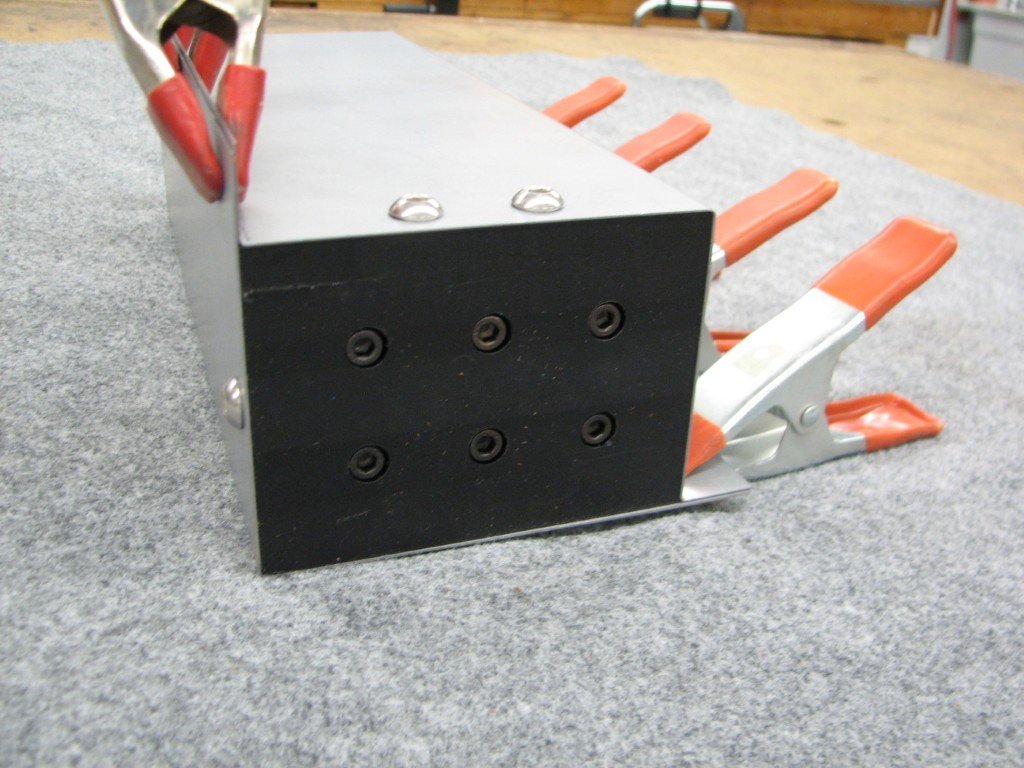

The base is 3/4" Delrin.
I had fun making it, I love doing something different.
Here are some pics, I hope you enjoy!
Am I right in guessing it's a "master form" that he'll use to make blank molds for vertical casting? I've seen two-part silicone mixtures for sale but hadn't figured out how to get the cylindrical holes - my gut told me that wooden dowels were not going to be easy to remove, polished steel should be much better 👍
Yes, I also thought it was a "master" but he called it a backcast.
The sides stick up 1/2" above the rods, that will become the base when you remove it and turn it upside down. It's filled with silicon rubber.
Very Cool! - In a foundry usually the term "backcast" refers to the process and not the mold itself. I'm guessing that it was called a backcast because backcasting is the process that the tooling will be used in. Essentially backcasting is the pouring of a material into a mold -- the empty void between the pattern, (the cores i.e. the matrix of rods in this case) and an outer shell or container. Regardless of what it is called, it is a very cool piece of tooling! - kind of a mold mold! - Dave

This turned out great! If this is who I think it is, they messaged me asking who I had make my mold masters and I sent em your way. I like the inset for the rods. I may have to have my next one done that way!
