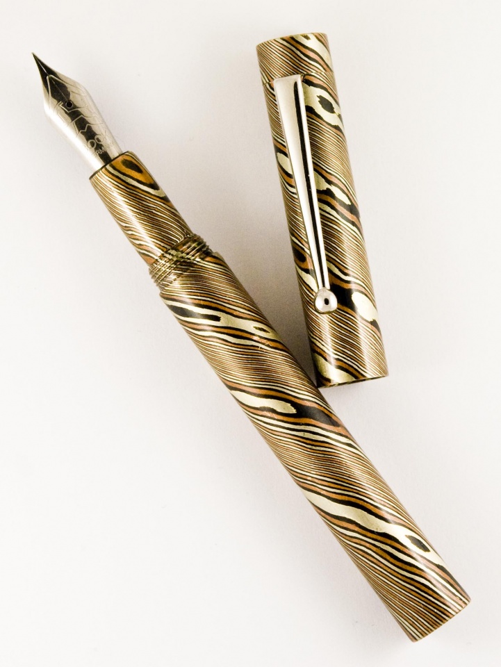

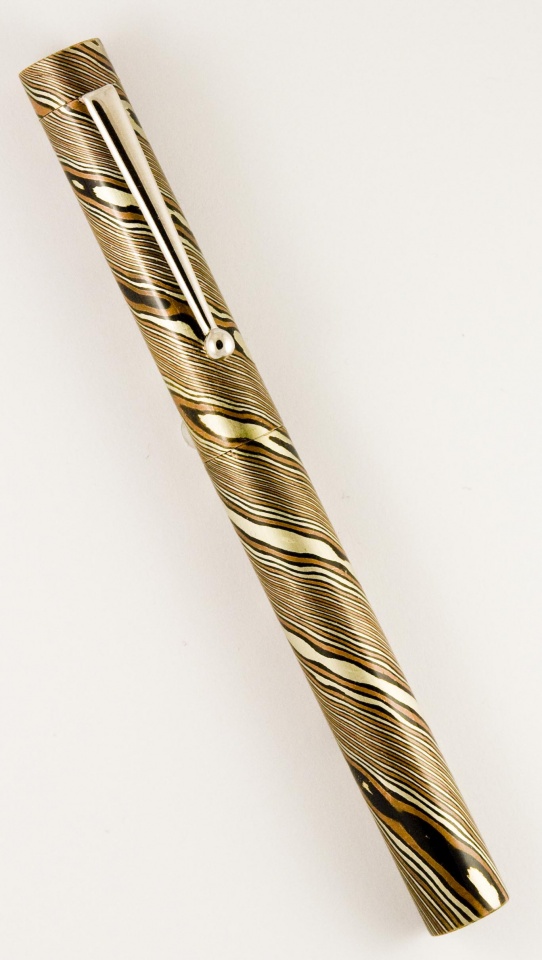

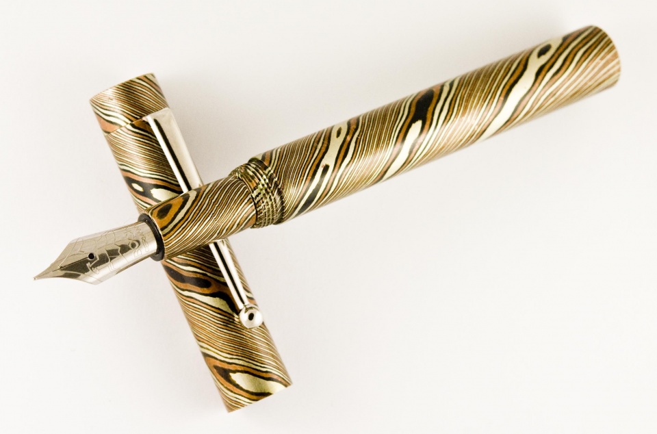

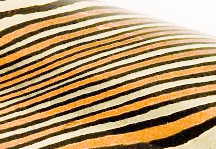

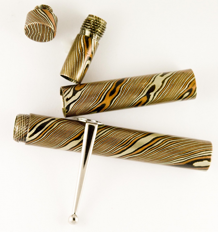

Been working a lot. Did get a chance to make this kitless Mokume Gane fountain pen. Made this a little at a time whenever I could get away to the shop. Created from a Triple Twist Round Bar of Mokume Gane with Nickel-Silver, Copper and Brass. Finished by sanding lightly but thoroughly with Feldspar powder and patinated to show all three metals. Took my time using the felspar to ensure there was good shearing of the metals. Resulted in defined boundaries of the three metals so as to not overlap and "smear" over the adjacent metal. Has a Bock #6 polished fine nib. Was happy with the result. The Mokume Gane twist triple round bar was custom made by master metalsmith Mike Sakmar.
Thanks so much for looking.

yes I have to agree with the others this qualifys as a WOW pen. The material, the shape, and the consistant flow of the blank from cap to body makes it a real beauty. Now that pen belongs on the front page for sure. One of your most prominent pens. Nice work and thanks for showing.
WOW is right !!!! .... WHAT A BEAUTY !!!! .... Look at the perfect alighment of patterns where the cap and body meet !!!!!
In addition to what else has been said, the thing that amazes me is how well pattern/grain of the top and bottom barrels line up when closed....a lot harder than it looks.
A beautiful pen indeed. Love the Mokume Gane you've used and the fit and finish (and immaculate attention to detail) is top notch. Very well done. thank you for sharing

I really enjoy working with Mokume and have made pens and jewelry from the material. It's an amazing sight when you apply the patina and see the reactive metals pop out.
