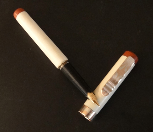

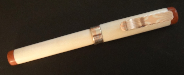

A little over a month ago I took a 2 day workshop to learn how to make Mokume Gane rings from sheets of silver and copper. We cleaned, diffusion bonded, ground, forged, annealed twisted, rolled, shaped and finished. Of course my ring was a centerband. Well the one from the class came out too big but there was enough of the billet we made to make a few more and a clip or 2. Didn't know if a white or black background would look better, so here is the first try in ivory with a little red ebonite trim. At some point, I may try the black. Section is a vintage Mont Blanc I got in a trade with TerryF.

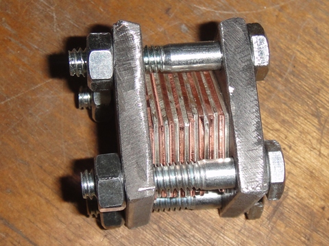

Just curious...Did you use that little rolling press that you posted to adhere the metals?

No - not to adhere but to roll to gauge when it was thin enough from forging with a hammer. To fuse the metals, a stack is placed in a little frame is tightened to hold them together and then it is placed in a little furnace heated with a torch. There's a view port on the furnace so you can see when the metals start to flow which is time to remove the heat.

Heh, I had been thinking about making components from real mokume and then using a very plain wood for a reversal effect (woodgrain visible in the metal parts but not the wood parts), but you beat me to it!
Cool looking pen, I can't wait to see the black one. It may just be the photos, but the mokume looks a little washed out against the white.

I think you're right about it being a little washed out. There is some stuff out there to darken it which I may give a try to create more contrast.

Bruce, I think it looks super! As usual, Very creative! Did you pick the red (reddish brown) ebonite trim to tie in with the copper in the Mokume? I'm trying to picture what the pen would look like with black ebonite accents. I wonder if it would tie in more with the section from Terry? Anyway, just rambling... Great job! Regards, Doc

Bruce, the Mokume Gane is terrific! Especially that clip. I don't know if it was intentional or not but it's interesting the way it almost seems to form a balanced design on the clip. Just my opinion but I think it would look better against a dark background for the pen.

Thanks Doc - yes I picked the red to go with the copper, and next one will be with black ebonite. The good news - I got 2 sections from Terry in the deal and there's enough of the billet left for one more.
Thanks - I did pick out that portion for the clip. See above for all black version to come.
