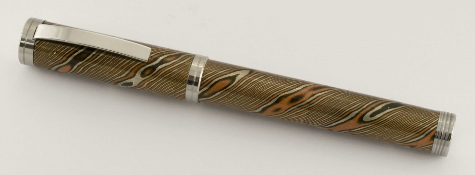

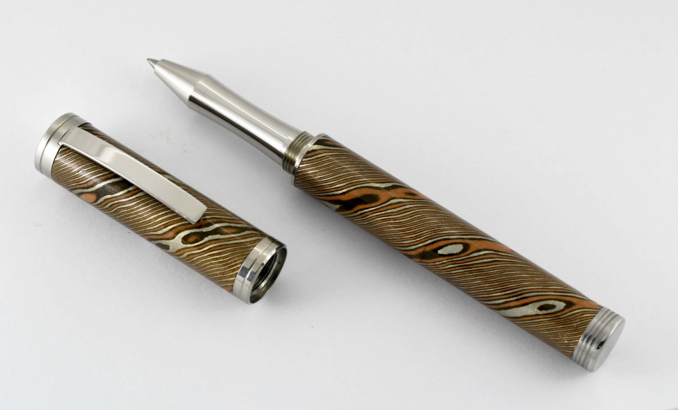

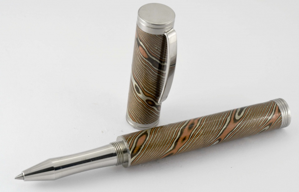

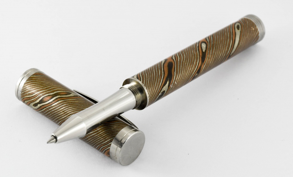

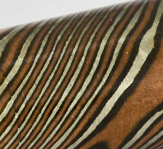

Made from solid round bar of Mokume Gane. The triple twist Mokume was made of copper, nickel silver and brass. Machined, finished, treated with feldspar and patina applied. All three metals well delineated with little or no smearing of the metals seen. (last picture). Used a stainless steel rollerball component set made in the UK by British Made Pen Kits. Had fun making it !

Without a doubt, this masterpiece is a Front page pen. Well done.
Thanks for sharing, your work is an inspiration.
Rod
Outstanding Pen Doc,
Magnificent Mokume Gane Triple Twist Blank, Superbly Manufactured, and Finished.
Splendid Stainless Steel Kit, Is a perfect Companion.
Incredible Craftsmanship.
Congratulations,
Brian.
Thank you all for the kind comments and encouragement!
Regards, Doc :smile:
