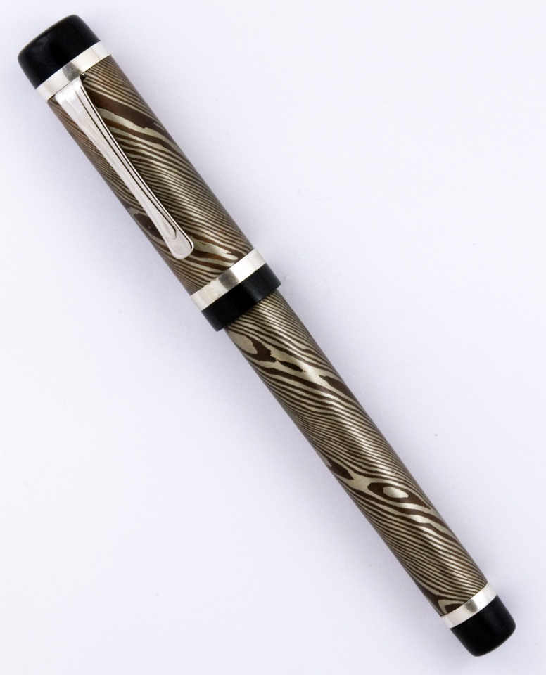

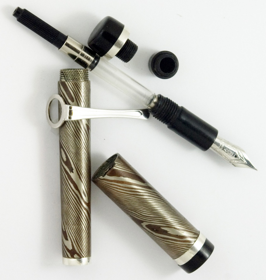

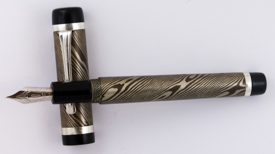

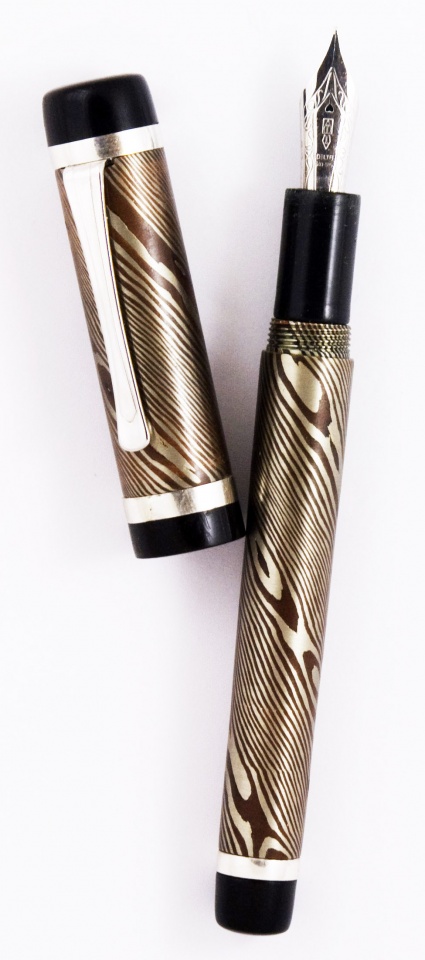

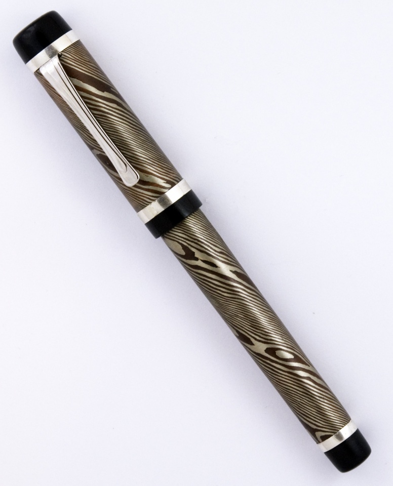

Made this gradually over the the course of a week or so. It's a custom fountain pen made with copper and nickel-silver Mokume Gane with ebonite and Argentium sterling silver accents. The mokume was machined, finished, etched, patinated and lacquered. The accents were also lacquered to prevent the ebonite from oxidizing the Argentium silver bands. The bands were formed around a ring mandrel, soldered and polished. Section is also from ebonite. Nib is a Delta14K medium point. Thanks for looking! Doc:smile:.

Stunning pen, so much talent Doc. Tell me how long did you take to make this pen from start to finish? Do you sell your pens? If you don't mind sharing if you do sell, what would this go for? Love your dedication to the art of pen making! So inspiring! WOW
Sean, It took me about 9 to 10 hours on and off the course of a week.
Nope..don't sell them. Give them away as gifts to my patients, friends, family and also donate them to galas for auction to a charitable cause for children. The only idea of what a pen like this goes for is somewhat inflated as they sell at auctions for benefits. My pens usually bring between $500 to $3750 during a gala. But usually the galas consist of bidding among individuals with large egos and equally large wallets... lol...I don't really care as long as the kids and a worthy cause gets most of the money.

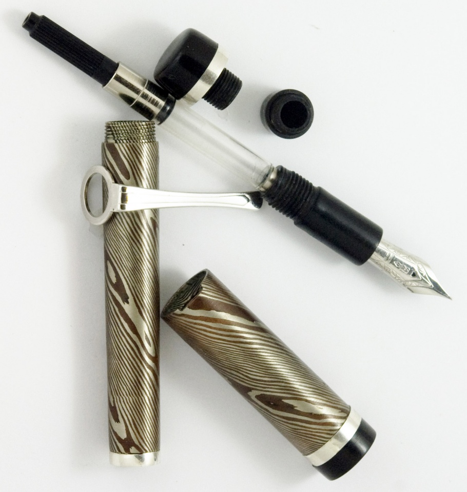

Since this has copper, and nickel in it......How smooth are the threads when you screw it together???
Mark,
My experience with the threads on Mokume, both made with nickel-silver/copper or made with nickel-silver/brass/copper are such that cap and body mate in a virtually very smooth, quiet fashion. I have wondered if that has been due to the versatile and malleable properties of copper. Very different from steel/stainless steel threads.
Doc:smile:
Doc
Was this triple or the new double threads?
These were triple start 12mm X 0.8mm. Am going to try double start on same material next and will let you know. Ty, many many thanks again for what has got to be smoothest execution of the mother of all group buys!!
