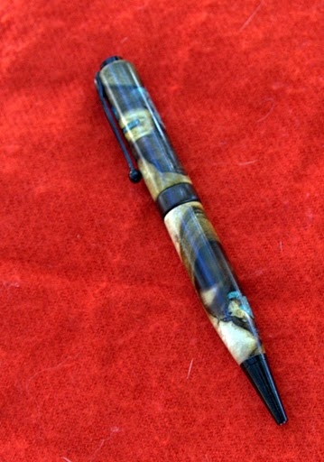

I really like the look of your modified slims. I love the slimlines, although about the only time I actually turn it as a slimline is when I'm turning corian. They allow you to use your imagination and creativity more than any other kit.
This is my latest effort

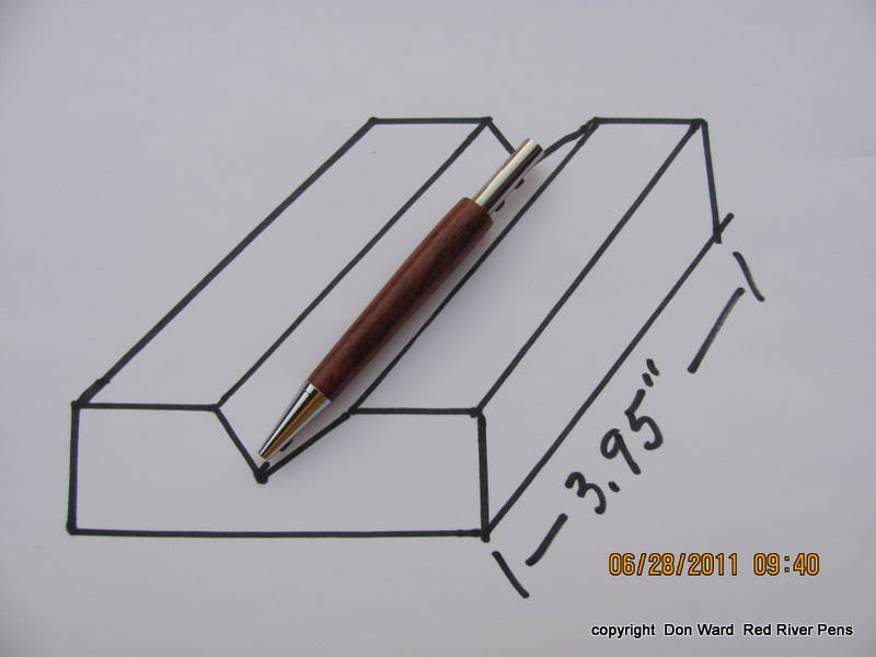

Here you go Lenny...and Sharon. This may help. It works for me. Drawing one was easier than finding mine. It is packed away in my traveling box which I used to teach at a club meeting last week. Do a good turn daily!
Don

My stop block is almost identical to Don's, except I cut it 4 inches long. I always have put the refill in, open it fully, AND THEN make another tiny little press stroke. I may sand the back of my jig to 3.95 inches.
I made it a little longer, because a long time ago all Cross style refills were not created equal, meaning that some were a "tad" longer. Today, that issue seems to have been resolved as all refills appear to be identical.

I have seen the spacer block reported to be 3 15/16 inches which is 3.9375 and 3 31/32 inches which is 3.96875 inches. Both will give a good seating. I just settled on 3.95 inches mostlyn because I like that look and it works with every slimline kit I've used and I think I've use all of them. Some I like much better than others.
