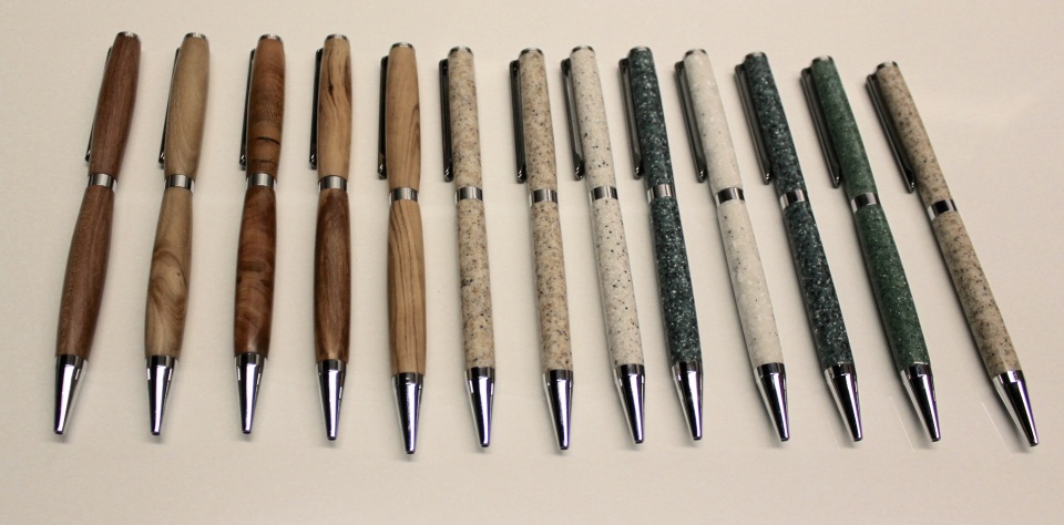

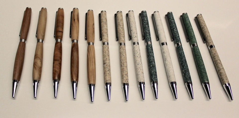

And some regular slims.
I had not turned a slimline for about 3 years. Earlier this summer, the Ohio IAP Chapter had some predrilled corian slim tubes and kits distributed for future donations to Service members. The regular slims were turned by Bob Jackson, Magicbob and I.

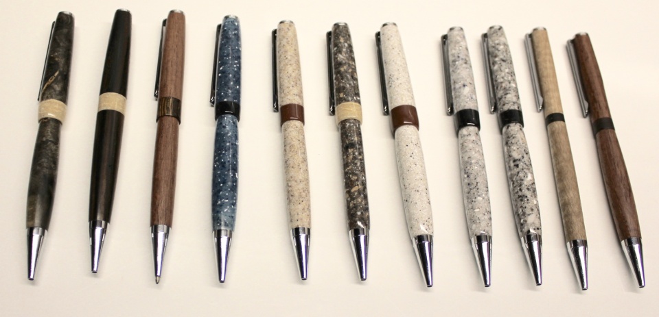

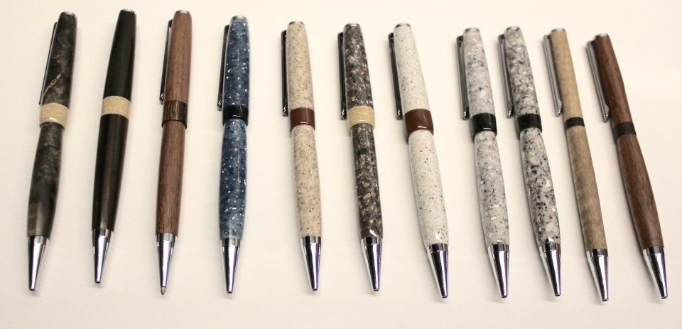

Since I have recently had an interest in segmenting, and modified slimlines (there should be a contest for these :mad:) were on my bucket list, I thought it was time to play.
I am keeping two of these, but the rest will be donated to our buddy in sunny Florida for "Pens for Service Members:" http://www.penturners.org/forum/f70/servicepens-2015-a-123881/ GaryMGg.
Two final comments: Please remember our Service Members, and if you have never went for the modified slimline... It is a very rewarding and easy to work with modification. (Kudos to Don Ward's book and tutorials available in our and his library).

Nice way to class up some slimlines! They resemble the euro/flat top/amercana which I like a lot.
I got a 100 pack of the basic Chrome slimline from Berea Hardwoods (at that number = $1.60 each). These pens cost me between $2.50-3.00; so a few extra minutes to make them a bit nicer is fine. After fooling around with the center bands for 2-3 pens, I got a nice profile down.
1. Upper blank tubed as usual.
2. Turn the upper blank barely round.
3. Use a parting tool to cut a 1/4" slice down to the brass tube.
4. Glue on a piece of corian/wood for the center band.
5. Use a 23/64" bit to drill a larger hole in the center band - I go all the way to the brass tube.
6. Turn the lower blank to profile, with the upper end able to fit into the 23/64" recess.
7. finish as usual.
I have to admit, I have used several of these pens the last 14 days, and like the size and feel of the ballpoint. The mechanism has been excellent. I bought 2 Cross refills from Staples and they are no better than the stock refills in the 100 pack. I will order some of the Private Reserve and Monteverde just to compare, but for now, I am not disappointed with the stock inks. (I would not say that for the stock Parker clones that we mostly throw away upon assembly).
As I will be turning more Service Pens, I cannot imagine NOT doing the custom center band; it really is an easy mod.
7. finish as usual.
