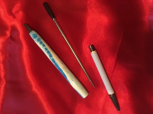

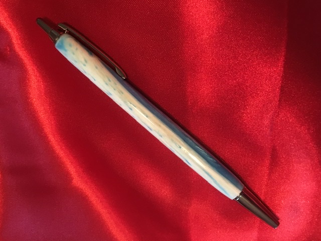

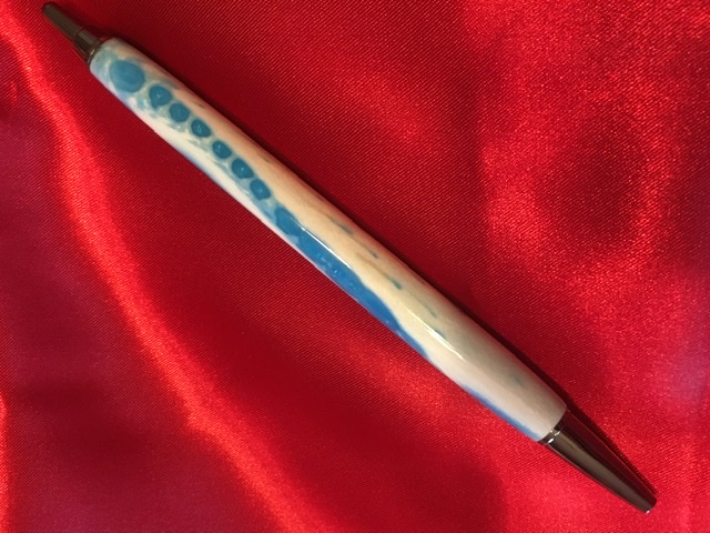

I was interacting in another thread about the PSI Groove. I received the kits and finished this up this morning. I had a plan in my head before getting the kits so when they arrived I jumped in right away. Needless to say when I was ready to assemble the pen it didn't work because the spring is on top not the nib end. After disassembling and cutting new tubes this is what I ended up with. This wasn't my fist choice in blanks but I didn't want to cast another just for a trial run. Thanks and Questions and Comments Welcome. 5477B376-4121-44BA-9232-0DB22E6A071E.jpeg419589D6-F48E-493E-BCE3-FB97329993F4.jpeg0CB7CC0A-F58C-485E-9691-897AA63258BA.jpeg

I notice your thread title refers to this pen as a "Modified" Groove ... how did you modify the kit ?
EDIT: - Oh, maybe your mod is that you made it as a single barrel.
I see that you painted the brass tube white .... right ?
Also, I see that the push button is fairly long .... is that actually true, or is it just an artifact of the photo ?
Oh, one other question .... is the position of the spring (on the top half) any problem .... once you know about it ? . Things work OK ?

Thanks for the complements. The reason it's modified is that the original kit is a 7mm 2 piece pen. I ground down the center band/ coupler smooth with the tubes and pressed it all together. I then took an 8mm tube and cut it the length of the 7mm tubes and the center band combined. I drilled my blank and epoxied the 8mm tube in and turned. I then took the top half or clip end and epoxied it into the blank. When the glue cured it inserted the bottom/nib end and screwed it into place. I lost a spring so now I'm down to 2 kits and one spring. My goal was to get a long body pen with a Cross Refill in a click style pen. I guess I accomplished that but not sure it's worth the extra work having the Tenacious / Blade ready to go with no extra hassles. I'm going to glue up and cast another blank and see how it looks. If I can find the spring or a replacement one I'll probably make the last kit as it was intended. The pen works great now that I assembled it the way it was designed internally.

Sorry I didn't answer all your questions. The push button isn't that long itself. The top assembly is cone shaped so it adds to the total length. When I had to replace the tubes I had one the correct length that was already powder coated so I used that. Thinking after the fact since that tube will come out to replace the cartridge it makes the whole thing look finished. I'm not sure if I would've gone the extra mile to paint the tube if I didn't have one already.
