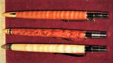

ok just for fun i made 2 of these, the tubes are 4 1/16" long and the click mechanism smooth,
pomelle bubinga and curly maple, the other is a dura click long tube that's made out of curly makore

The Cigarillo kit ... did you use the kit from CSUSA and then make modifications ?
Here's the CSUSA instruction sheet : https://www.woodturnerscatalog.com/docs/cigarillo_pen.pdf
That kit is based on two 7 mm brass tubes and a Cross refill .... did you stick with the 7 mm size and the Cross refill ?
If so, I'm wondering how you attached the SKM-88 click mechanism because it's too big to thread into a 7 mm tube.
Also, you would have had to add a spring when you converted from the twist operation to the click operation.
And then, the problem is that the Cross refill is not designed to work with a spring.
I'd be interested in knowing further details about the modifications that you made, please. . Thanks.

I realize now that the DuraClick "long tube" (as you called it) is actually the PSI DuraClick SLIM.
Also, other people might not know that the Cigarillo (a CSUSA product) and the DuraClick Slim both use Cross refills. . I was thinking Parker refill all this time. . The fact that Cross refills are used here might be a sticking point for some other people as well.
One other point of possible confusion is that the DuraClick Slim starts out as a click pen, whereas the Cigarillo, as purchased, is a twist pen which you have converted to a click pen by adding the SKM-88 mechanism to work in the same way as in the DuraClick Slim .
Finally, the DuraClick Slim can work as a click pen with a Cross refill because PSI has jiggered around with the center band to hold the spring at one end while the other end of the spring bumps up against the black plastic piece at the top end of the Cross refill . . To me it was a foreign concept to think of a spring being used with a Cross refill. . But now I get it ! . Thanks again for the clarifying discussion, Bill, and for pointing me to the instruction sheet.
