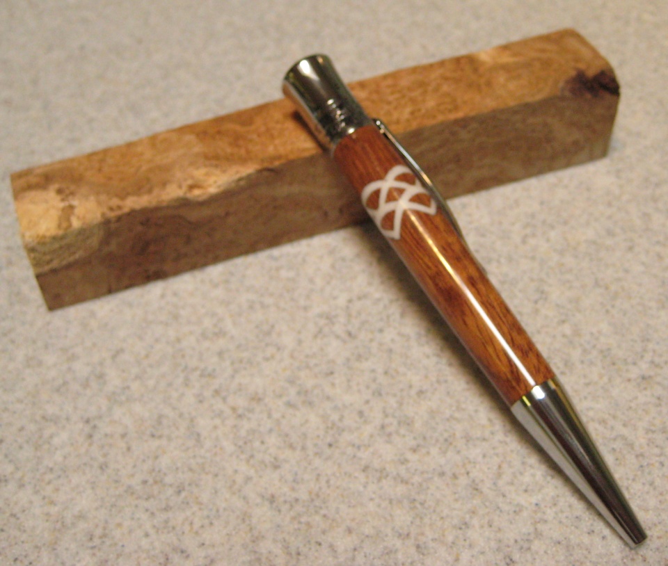

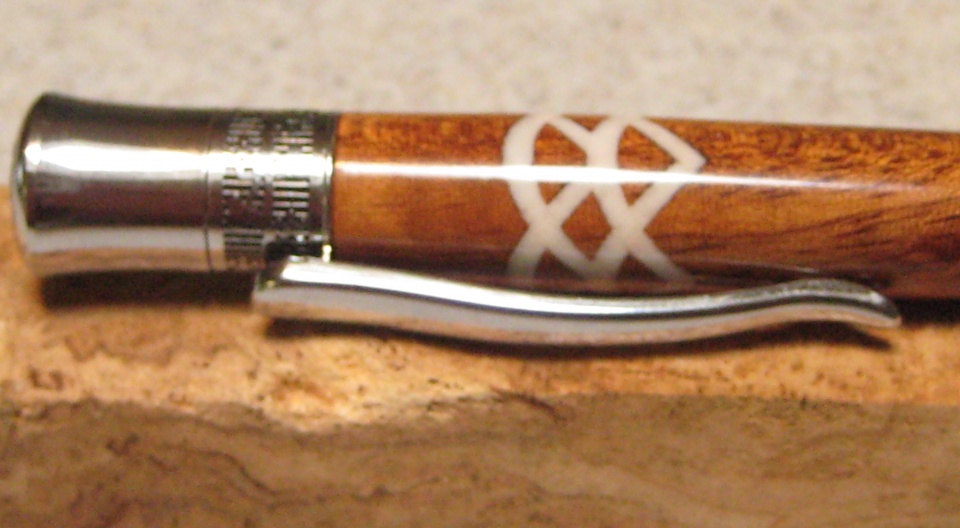

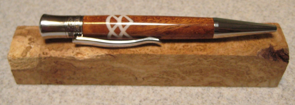

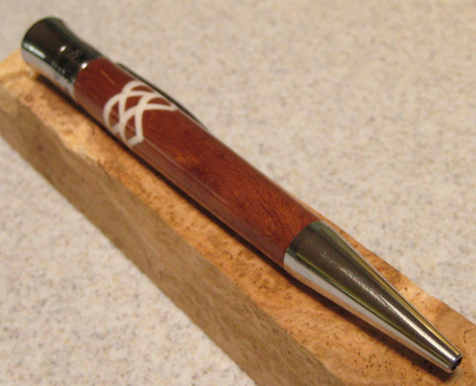

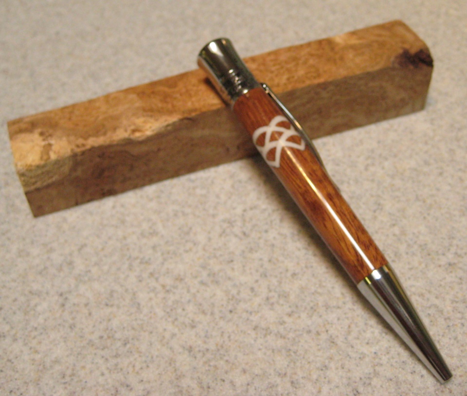

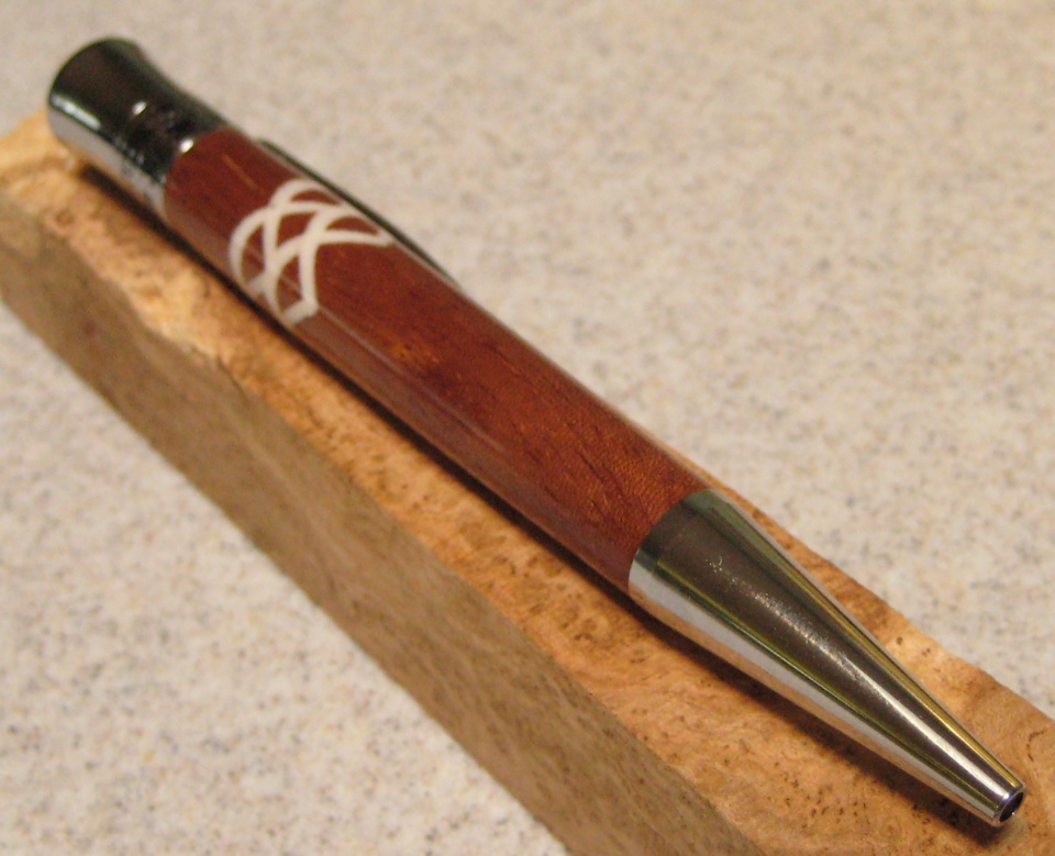

Well, sort of a Modified Celtic Knot. A few months ago I was playing around with inlays, Celtic Knots and serpentines blanks. I finally got around to turing this one. The inlay is Corian. Sorry for the poor quality pictures.

It can be reproduced. I use a sled on my bandsaw. Make it similar to a Celtic Knot but only cut half way through the blank.
One thing to remember just like a Celtic knot start with a perfectly square blank. Draw a center line down the middle of the blank on all 4 sides. Cut to the center line. Insert the inlay using CA or I use Titebond wood glue if I'm using a wood inlay. Let dry for 10 to 15 minutes. Sand smooth being careful to sand flush only the inlay. Flip the blank 90* then repeat with another cut just to the center line. Repeat on all 4 sides. I adjusted the stop block on the sled and repeated the process to make the a 2nd row of cuts.
I used to use the drill press to drill for the brass tube but have started using a Barracuda chuck. It produces a hole right in the center of the blank. If the hole is off center it will make the knot deformed and not be even all around. Hope this helps.
