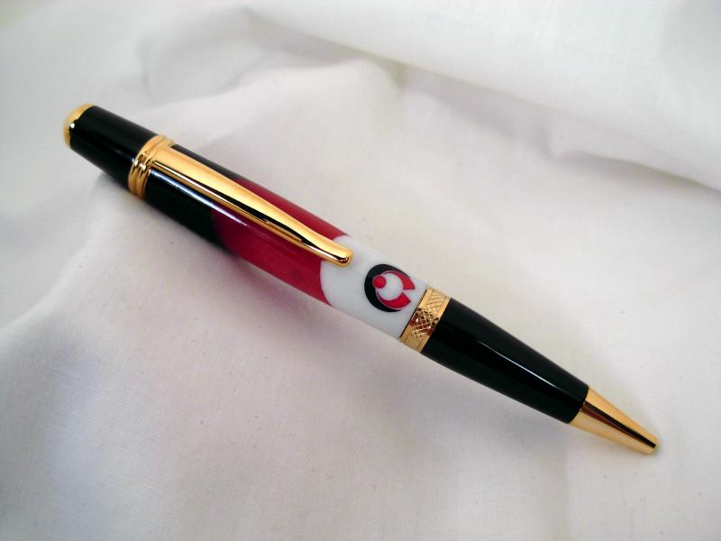

Ryan.
Do you mean something like this?
I cut pieces of white, red and black acrylic at a 35 degree angle and glued them together with CA.
Hope this helps
Jeff
