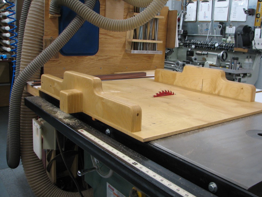

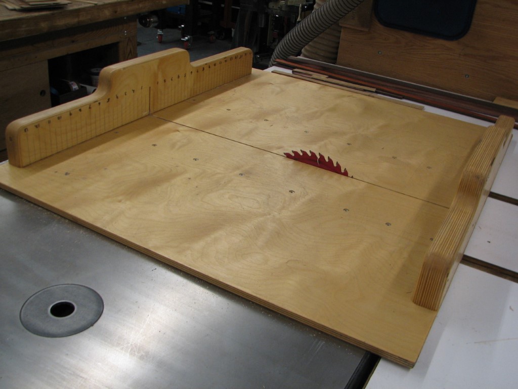

This is the one that stays parked on my saw, it's for 90 degree cuts on anything up to 25"...

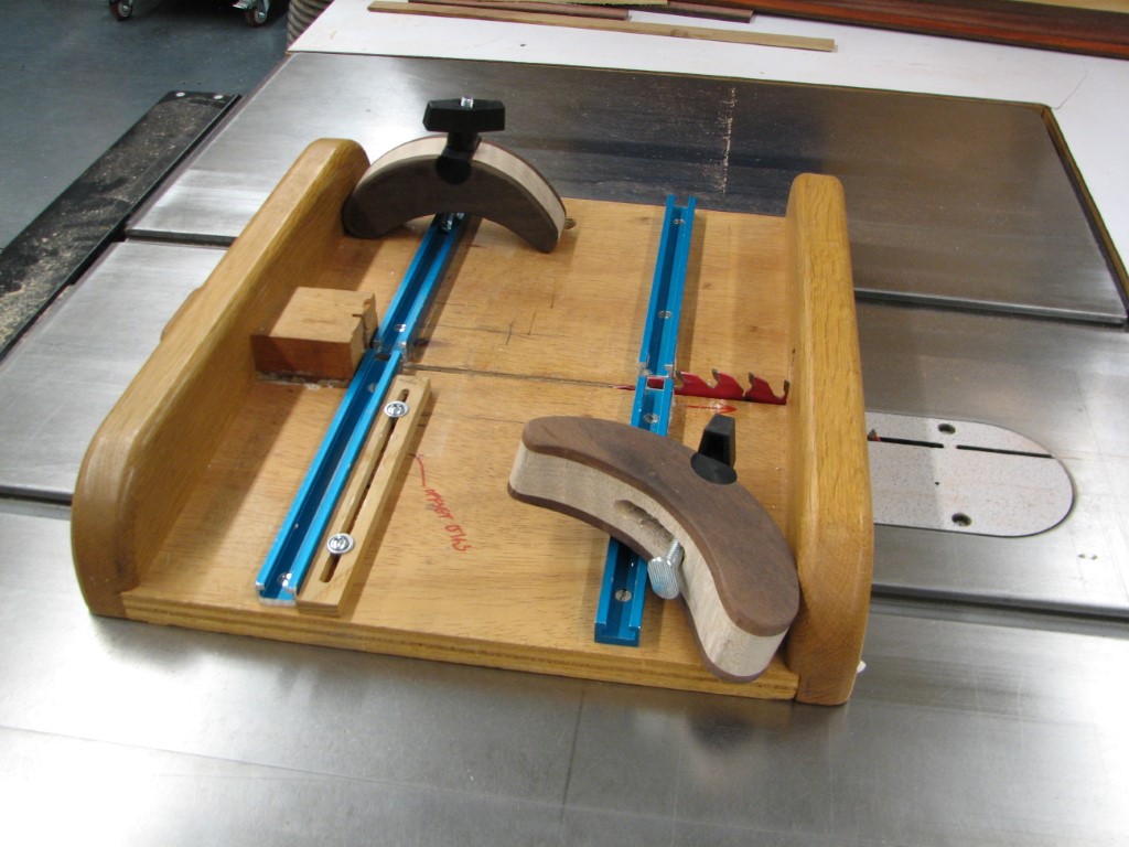

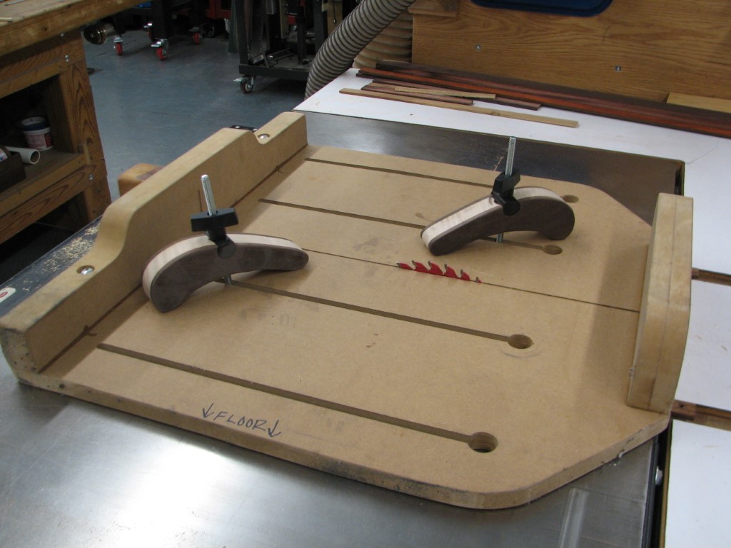

This is for segmenting and small pieces...

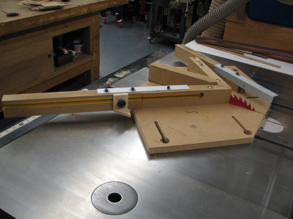

This is for all the oddball stuff, you can set it to hold any angle...

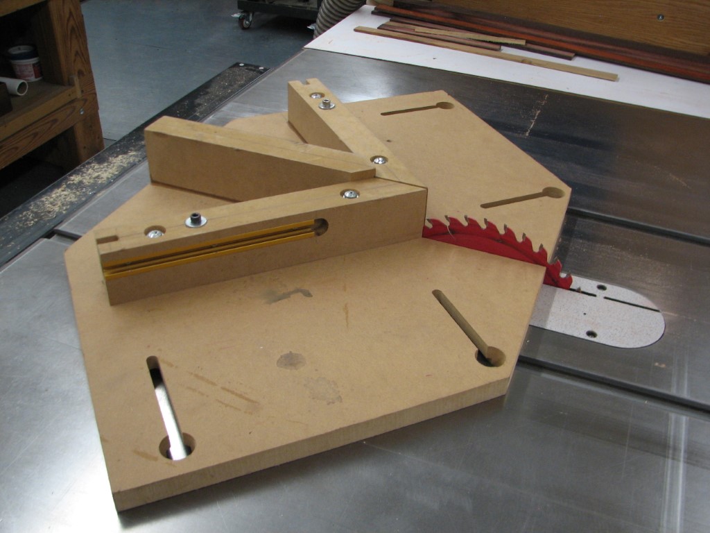

And this is my picture frame jig, it's set to a perfect 45 degrees...
I made some extensions with a stop for longer repetitive cuts...

Some nice jigs there. My miter gauge sits on the jointer top and I grab it for quick cutoffs that are not really needed to be dead on accurate. It falls on the floor and is not tuned to saw. I have one gauge that is tuned and has a fence that I made but any stop blocks I use clamps with pieces of wood. I even have 2 complete sets of the Dubby cut off sleds that I hardly ever use. I just make jigs as shown also. So much more accurate and easy repeating of cuts.
