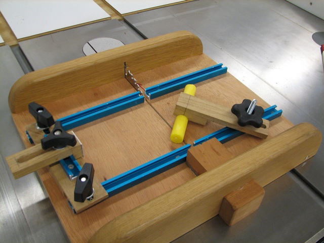

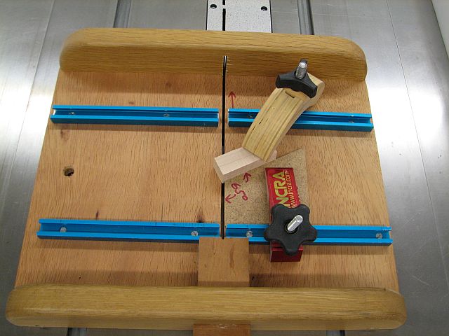

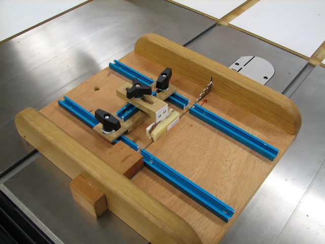

Put a fence on it. I always use a fence that supports both sides of the cut on both my table saw and bandsaw when dealing with small pieces. That is why I also like to use a sled basically but it is not technically a sled because it is attached to the miter gauge. But it has both a fence and a bottom. This way the pieces are supported the same on all sides.
An example. This is a sled for the tablesaw because I use the 2 runners in the miter slots but the same concept is used with the miter gauge. I attach to the gauage and use on bandsaw or tablesaw especially if I need angles. I can attach hold downs, stop blocks, new bottom , attach a piece of baltic birch to the fence and so on. Very versatile. I make many of these as each project calls for something different. So easy to do and makes it very safe around a blade.

Now that is more what I want. I am going with the V27 and building something similar to your second picture!

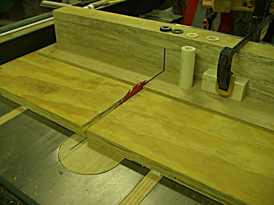

A better choice is a sled with hold downs on it, I made this one for my TS but I don't see why it wouldn't work on a BS.

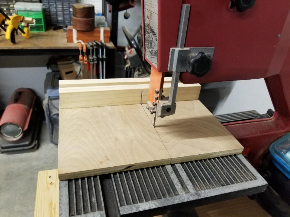

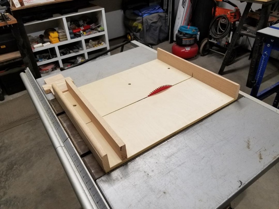

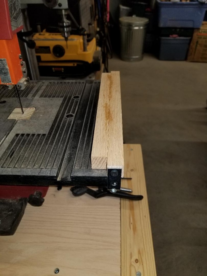

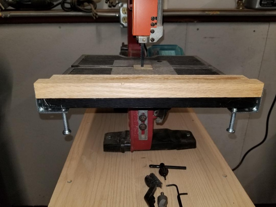

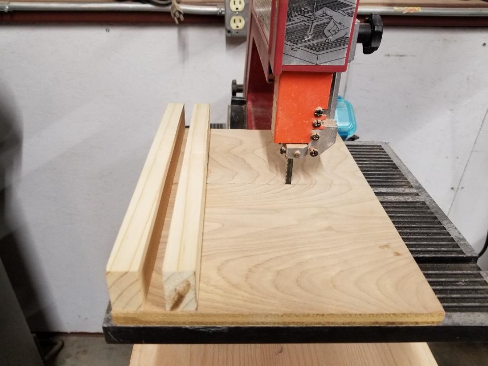

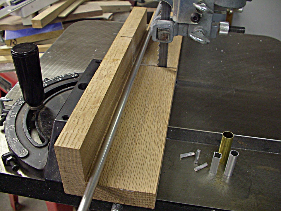

I have some rather old equipment my self. My tablesaw is nice at 10 yrs old but my bandsaw is a 20 yr old mastercraft 10" bench saw. Lol But I have made a couple things for them that helps me out a lot. I have a sled for my tablesaw which is nice but as of lately, I have been using my bandsaw much more. I get thinner cuts and straight cuts with it. The first pic is my tablesaw sled. The 2nd and 3rd pics are my bandsaw sled and the last two #4 and #5 is the little fence I made for it. A very simple little fence that I used two pieces of 1" pieces of Oak. My table is only 11 1/2" wide and long. I put a little L bracket, cheapies from home depot and screwed them to the ends. I then tapped the predrilled holes to fit a machine bolt and I can just tighten it up to the table from the bottom. I can cut a 5 1/2" blank long ways and get a straight 1/8" piece of wood 5 1/2" long. Great for the little work that I have been trying to practice with.
