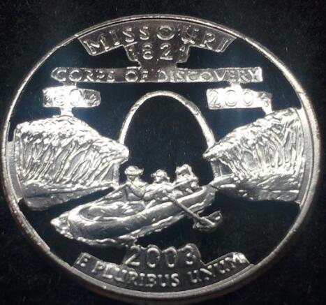

I'm taking a break for the night and cutting a new quarter.Its been awhile, so stay tuned. I figure this should take me about an hour and fifteen minutes.

Pretty sweet looking. I still haven't figured out how anyone can see good enough to do that fine of detail work. I'm always impressed by your talent.

I see you got lazy on this one and did not scroll each individual tree. :biggrin:
That arch is really clean. Do you file after cutting to clean up?
yes as much as i can, sometimes there are areas that are just too difficult to get into with a file.
I thought about the trees, but after looking at it, I really felt like i should remove the dates just below "corps of discovery", its the 1804 & 2004. they seem a bit out of place since there is already a date in the middle top and middle bottom

Great job. What kind of jig do you use to hold the coins while you grind them down? Do you use sander or grinder and do you do it before or after you cut them out?

the only ignorant question is the one not asked! The process that i have developed is quite lengthy but basically the coin is cut using a scroll saw, rolled and cast around a pen tube. Then the blank is turned on the lathe between bushings or centers and assembled.
