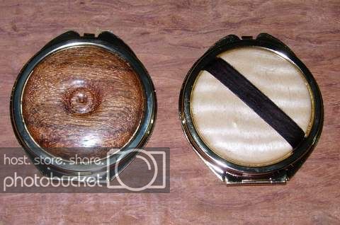

Here is a pic of two of my latest compacts. They make great gifts and don't take much time at all, compared to other projects.
Red Walnut, from New Guinea and curly maple, with blackwood, my first segmentation with these compacts.
Thanks for looking,
Rob

They look best if you don't play with contour too much, as you have to sand all contours out. I took a thin slice of blackwood, cut diagonally accross the grain of the curly maple with a mitre saw and glued the thin strip between the pieces. I should have clamped it together, but you can only see the gap, if you hold it up to the light. Once it's glued to the compact, you can't see it.
