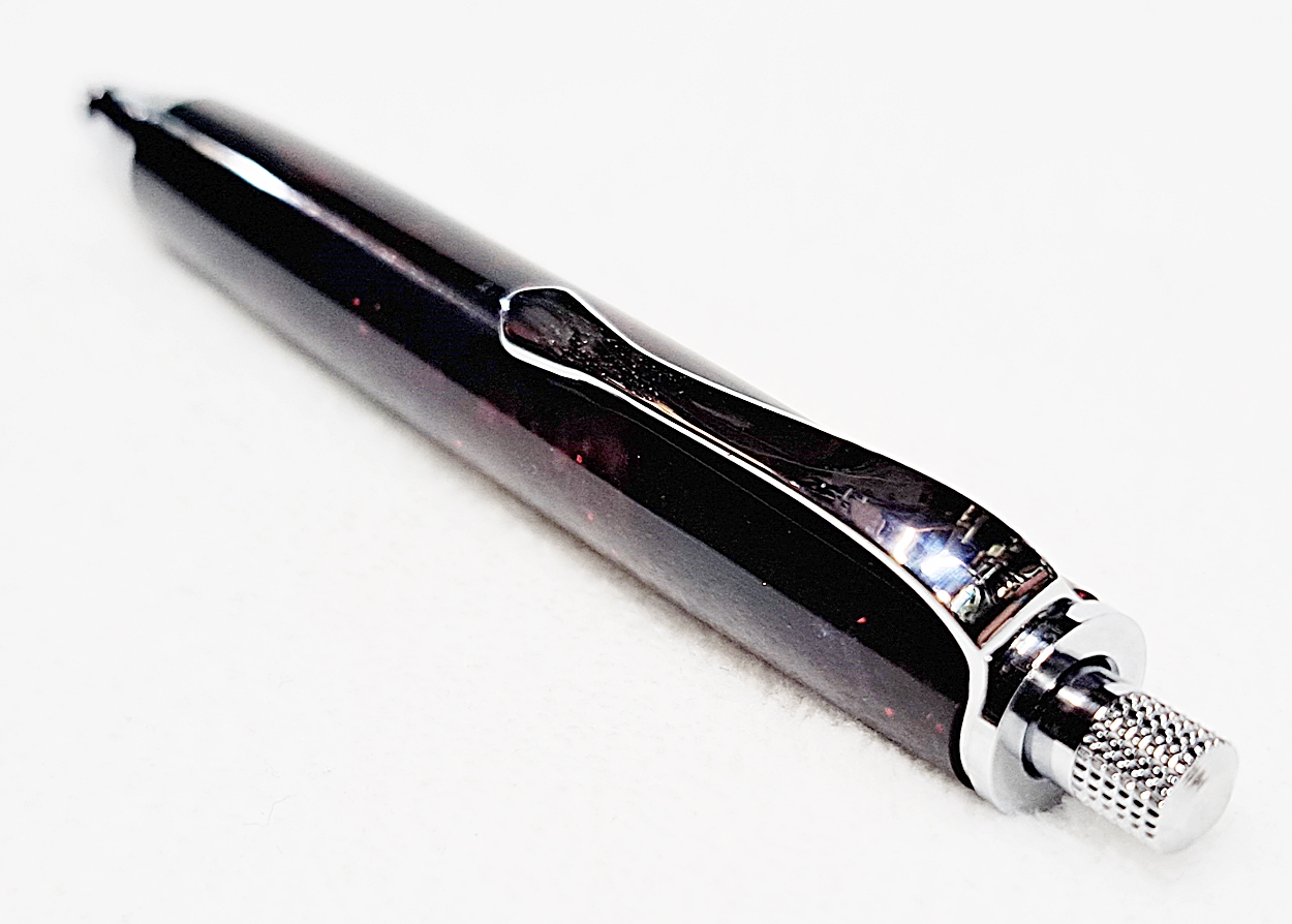

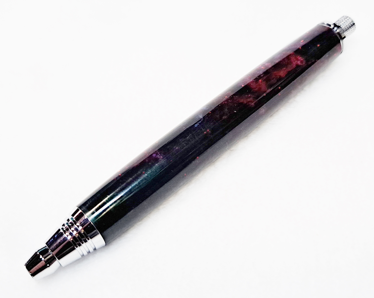

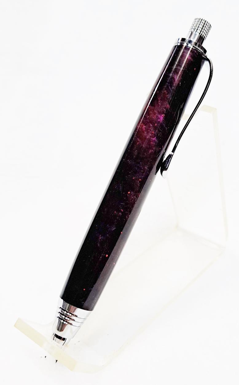

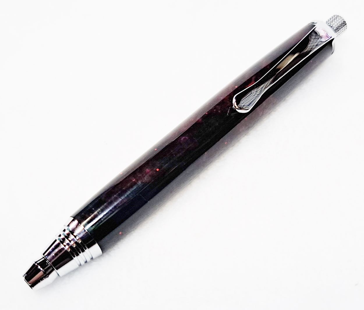

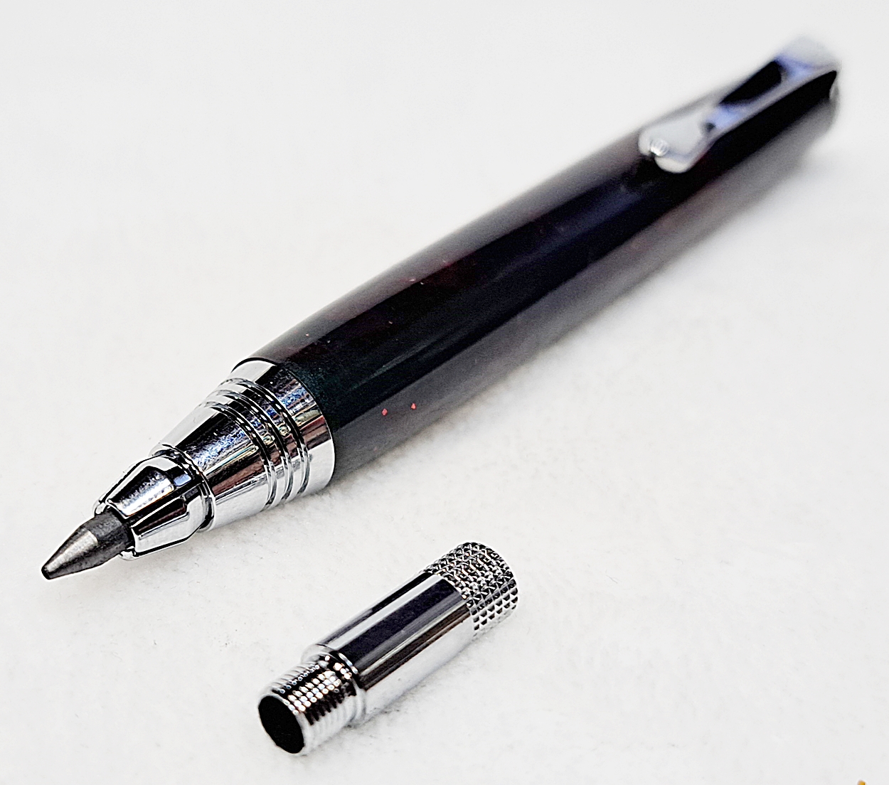

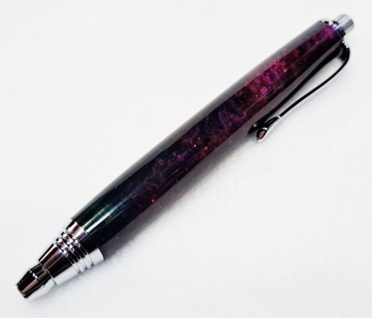

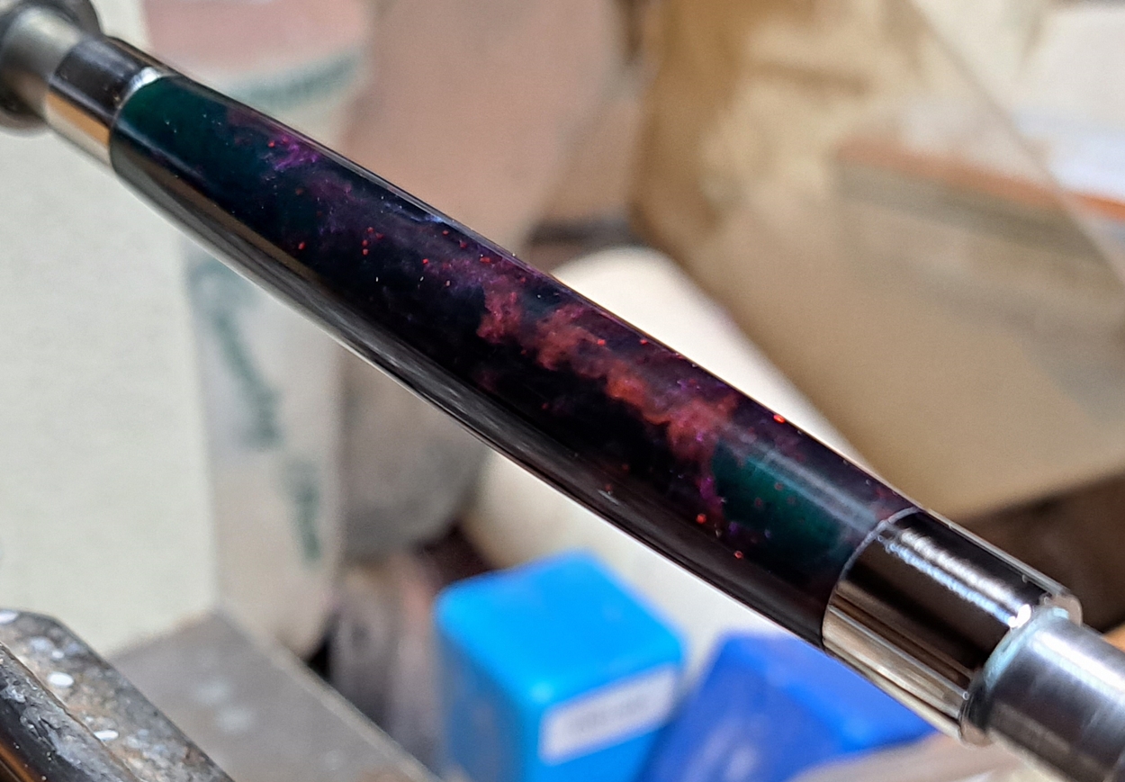

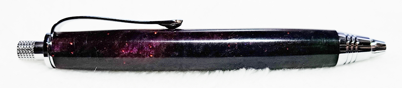

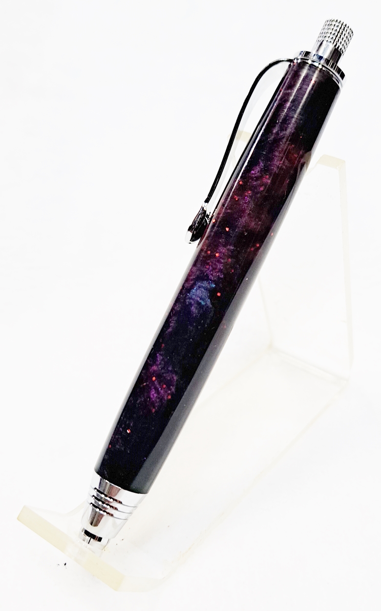

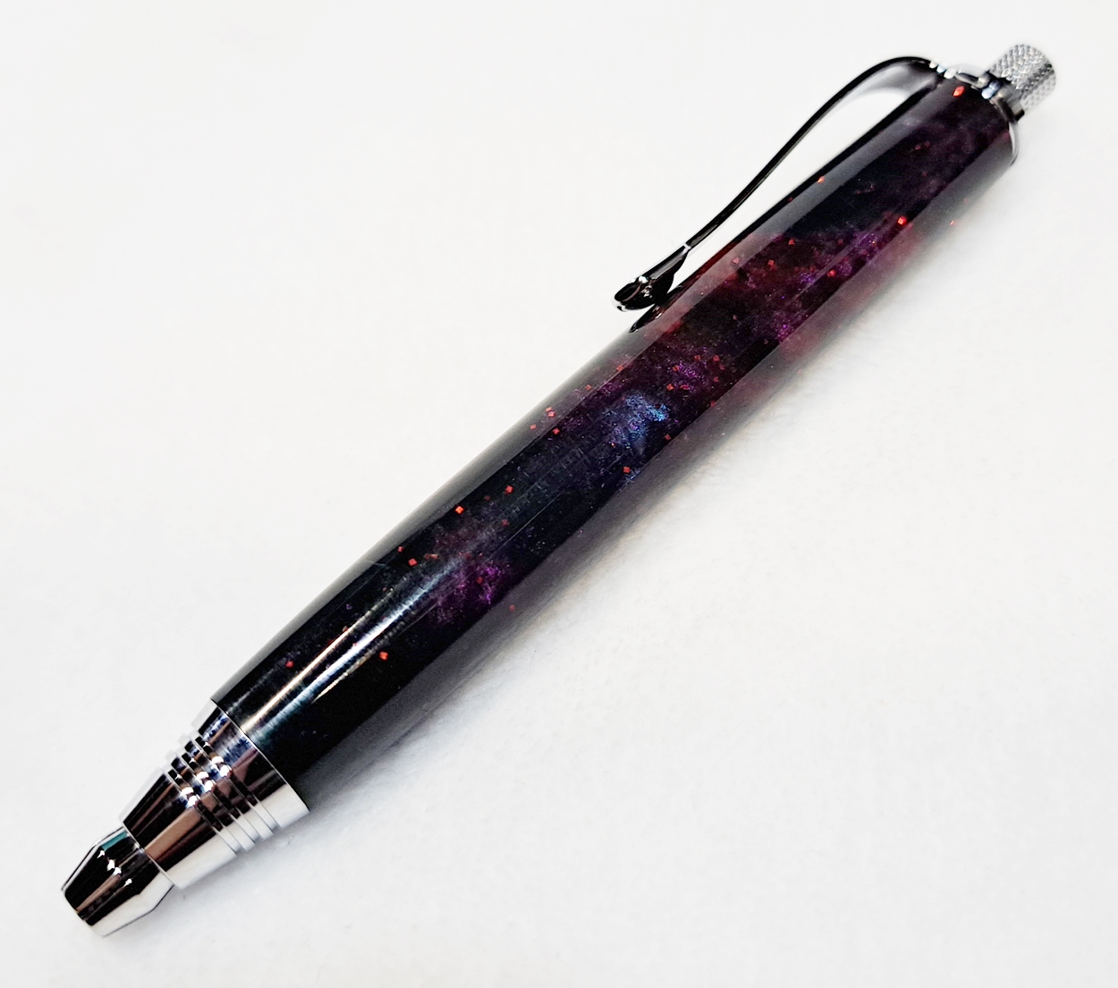

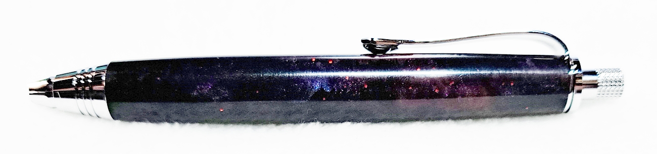

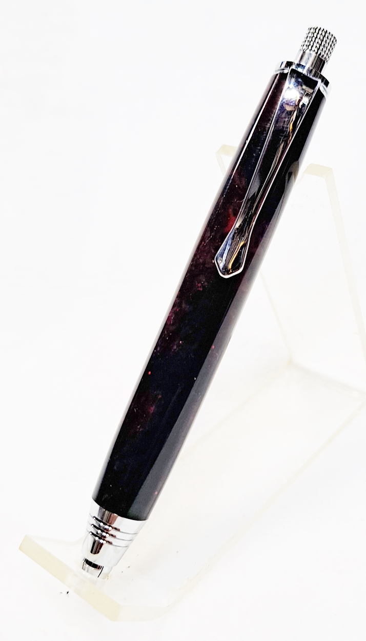

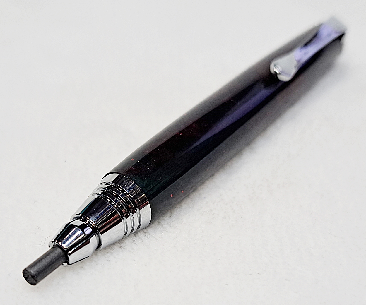

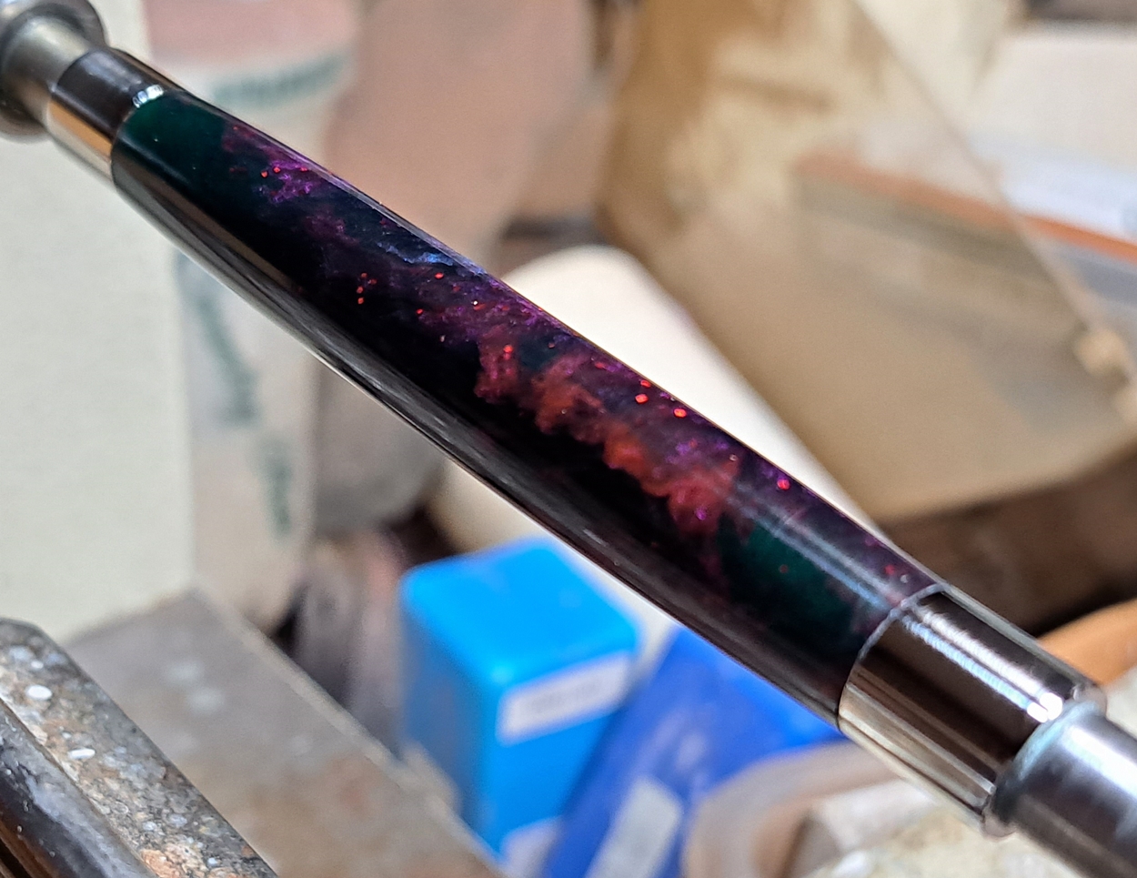

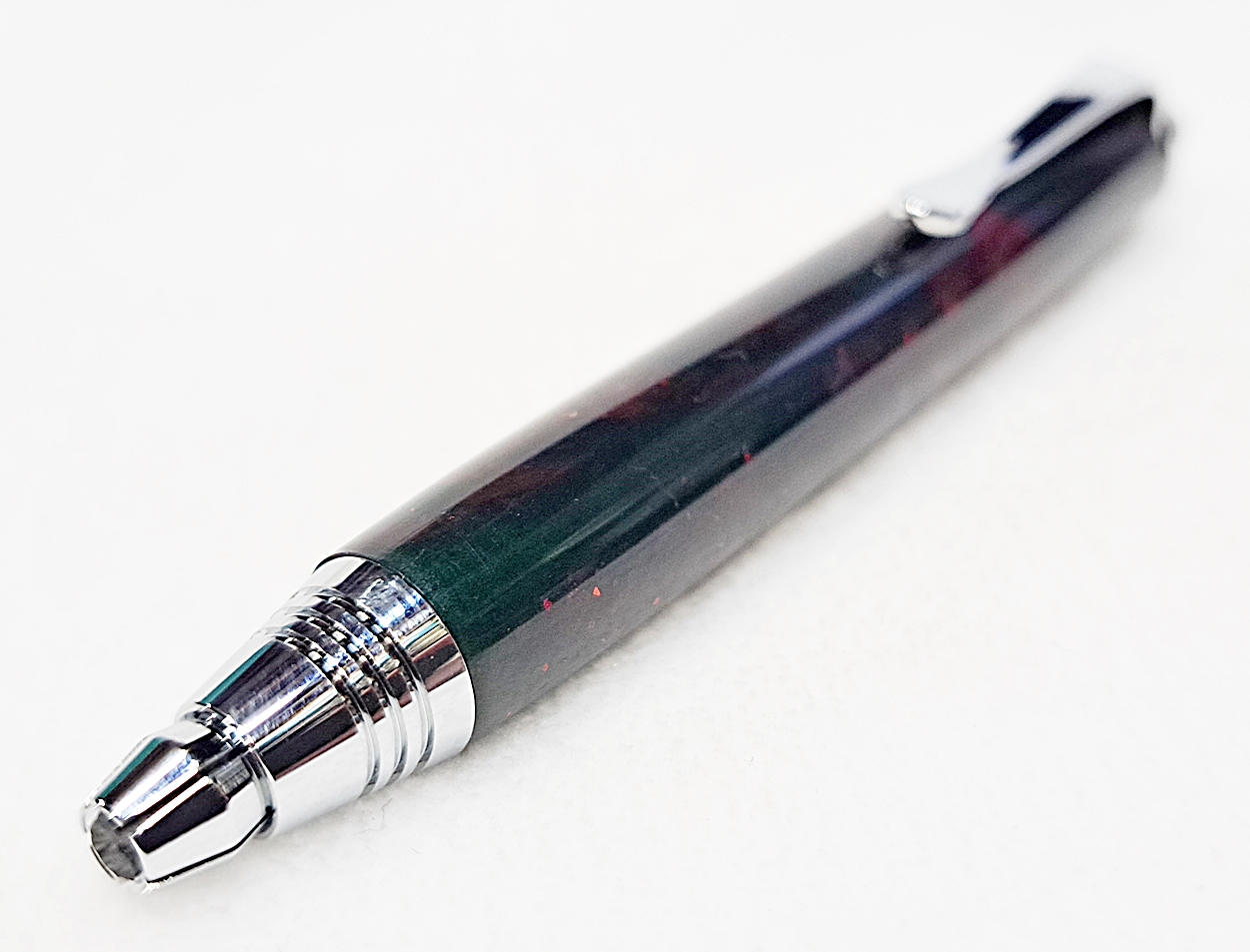

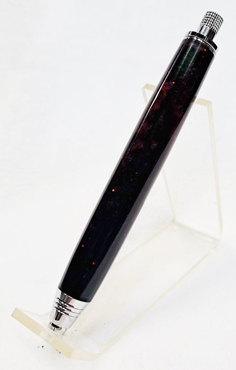

This is a PSI Mini Sketch Pencil in chrome. The blank is a custom cast by my friend Dennis. The photos don't do it justice. There is a lot of depth in it that shows up in sunlight and bright light, that I couldn't capture with the camera. This is my first time turning one of these. I like the kit. It takes 3mm lead, and has a built-in sharpener.

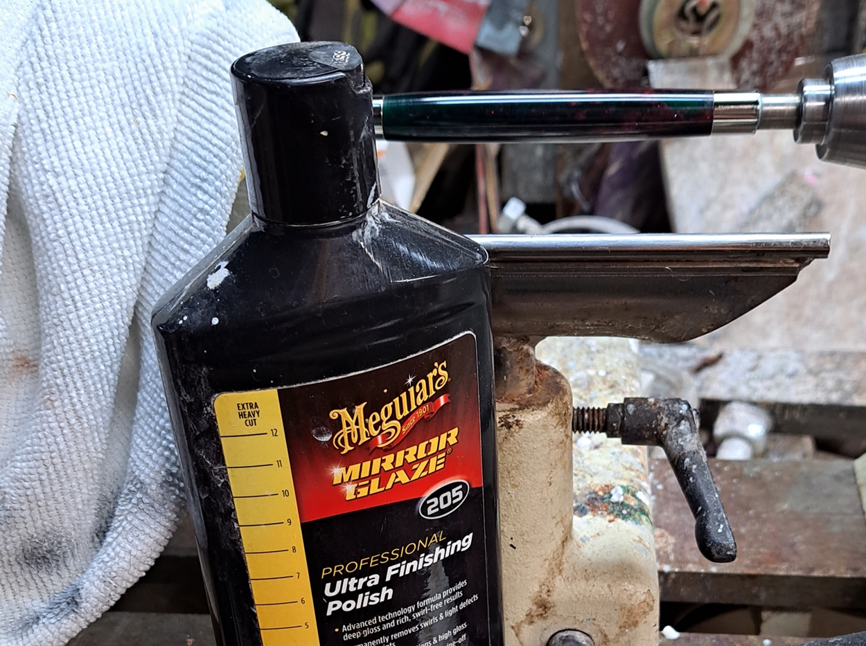

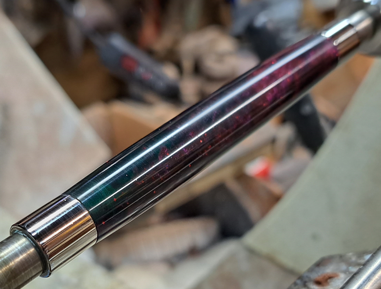

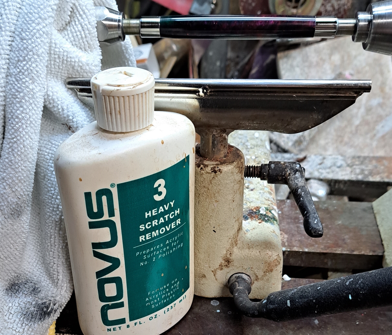

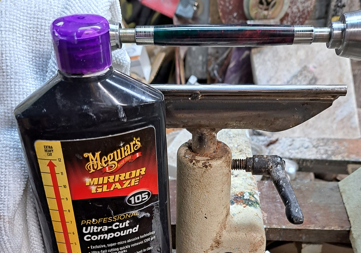

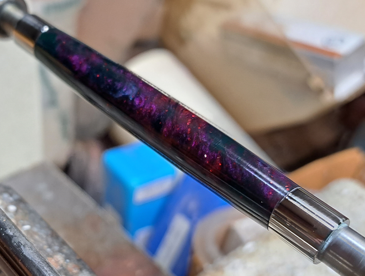

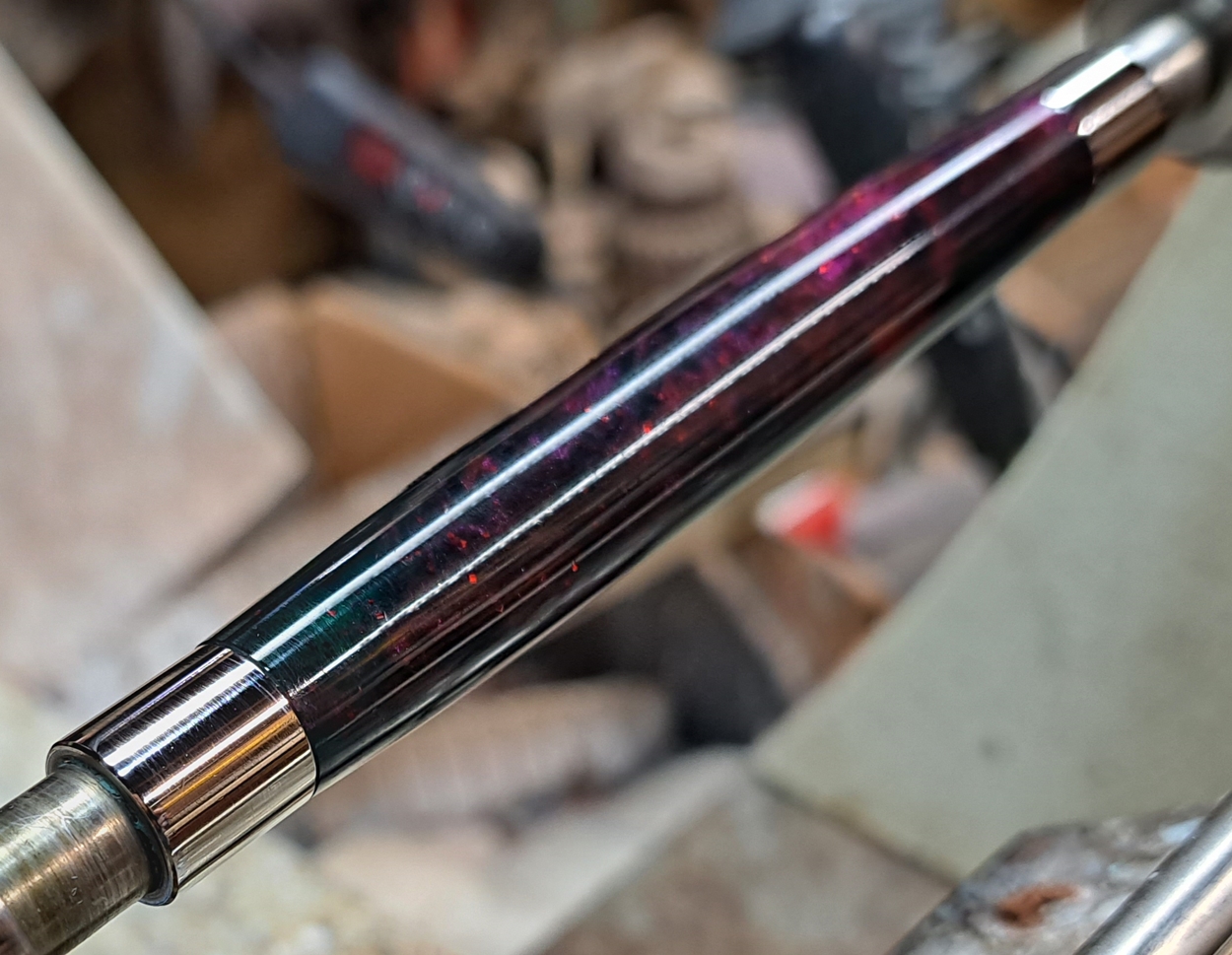

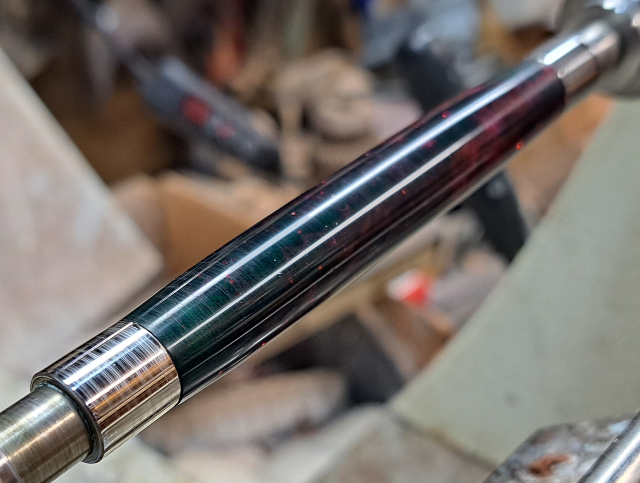

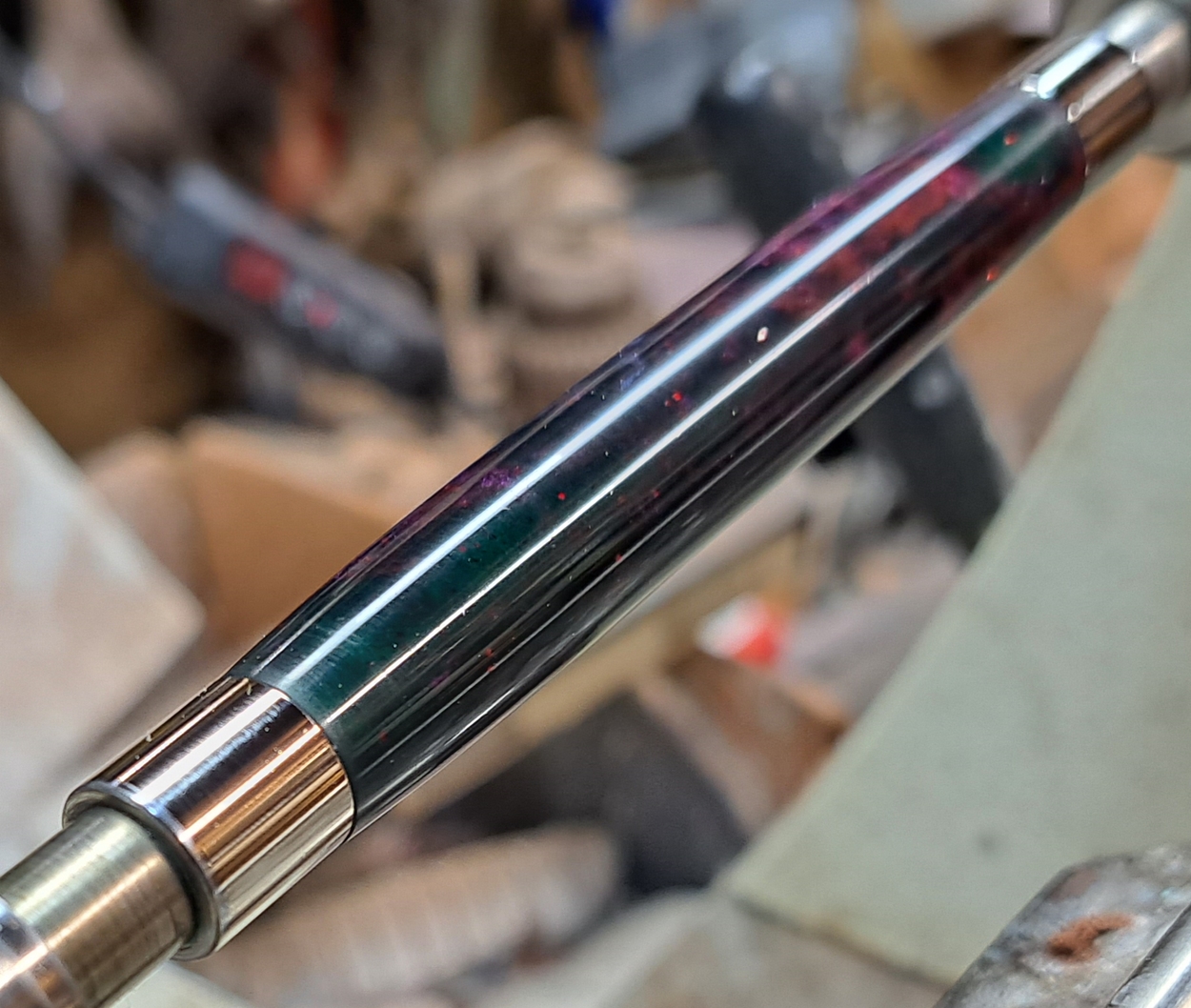

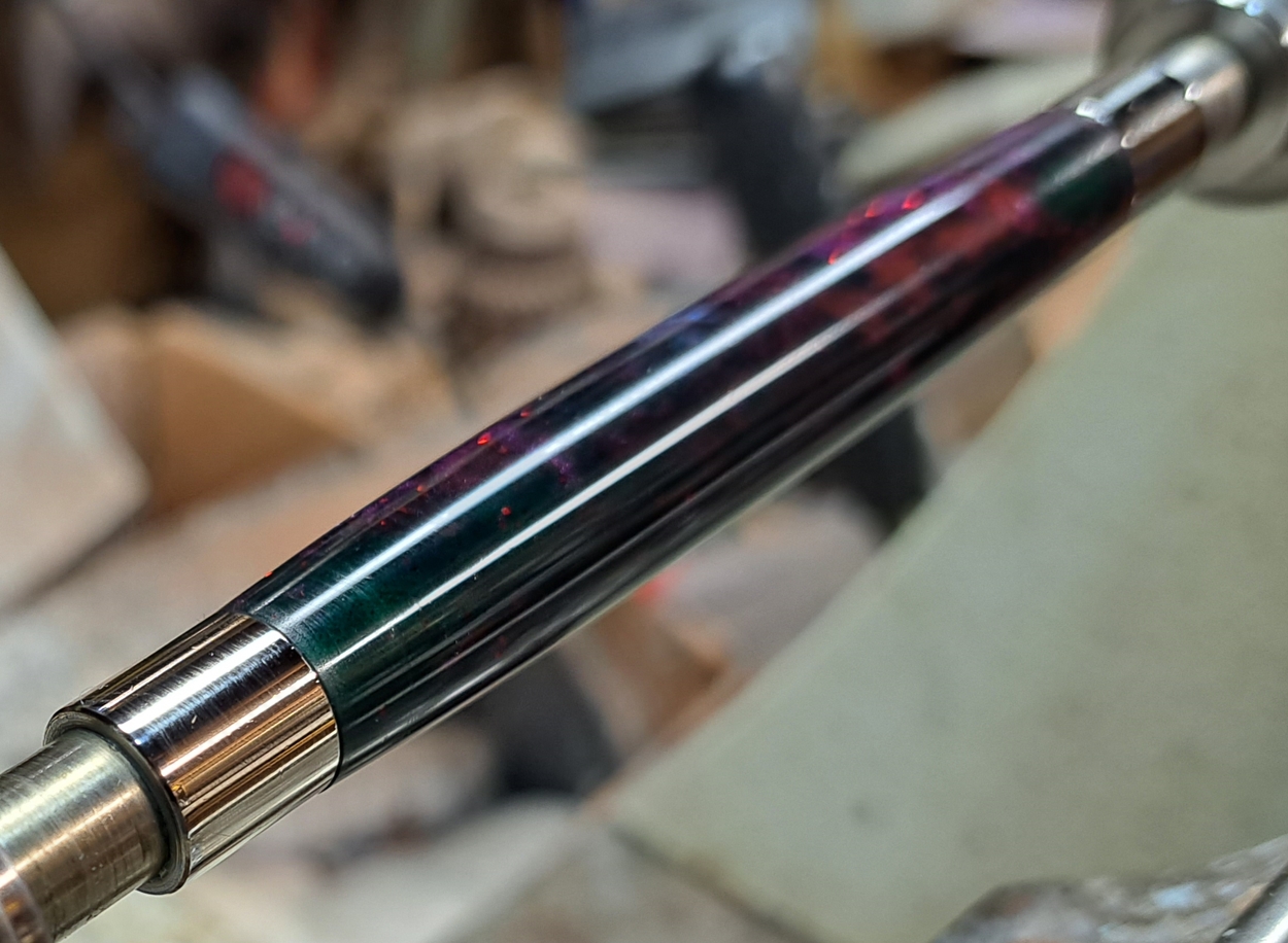

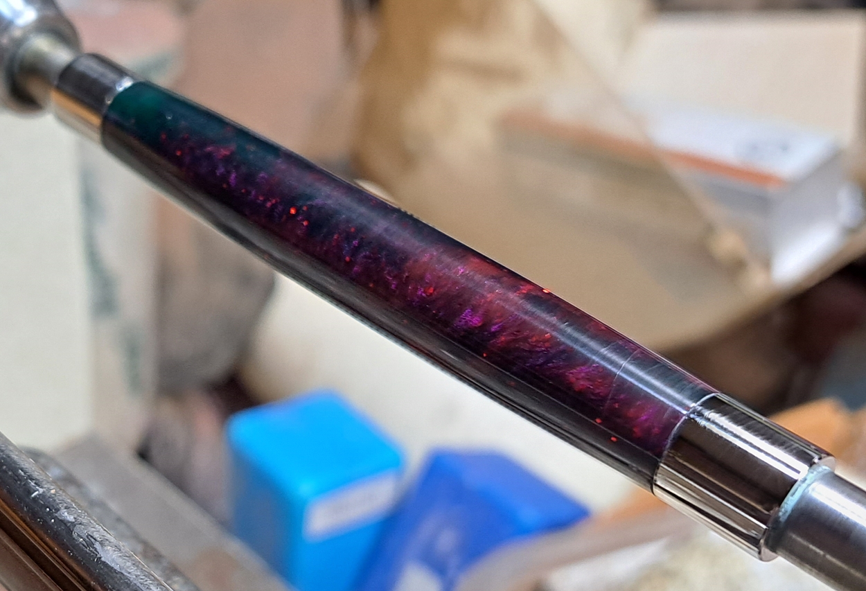

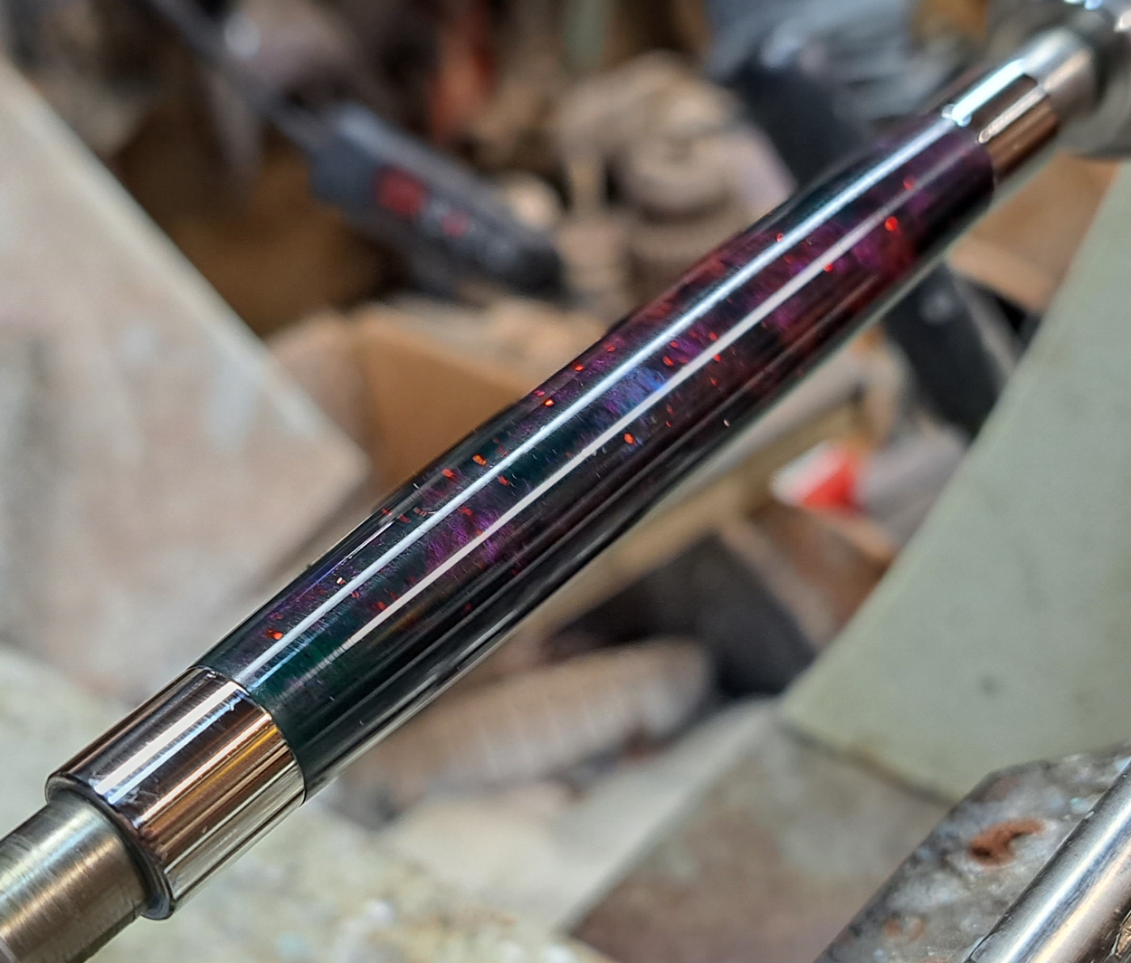

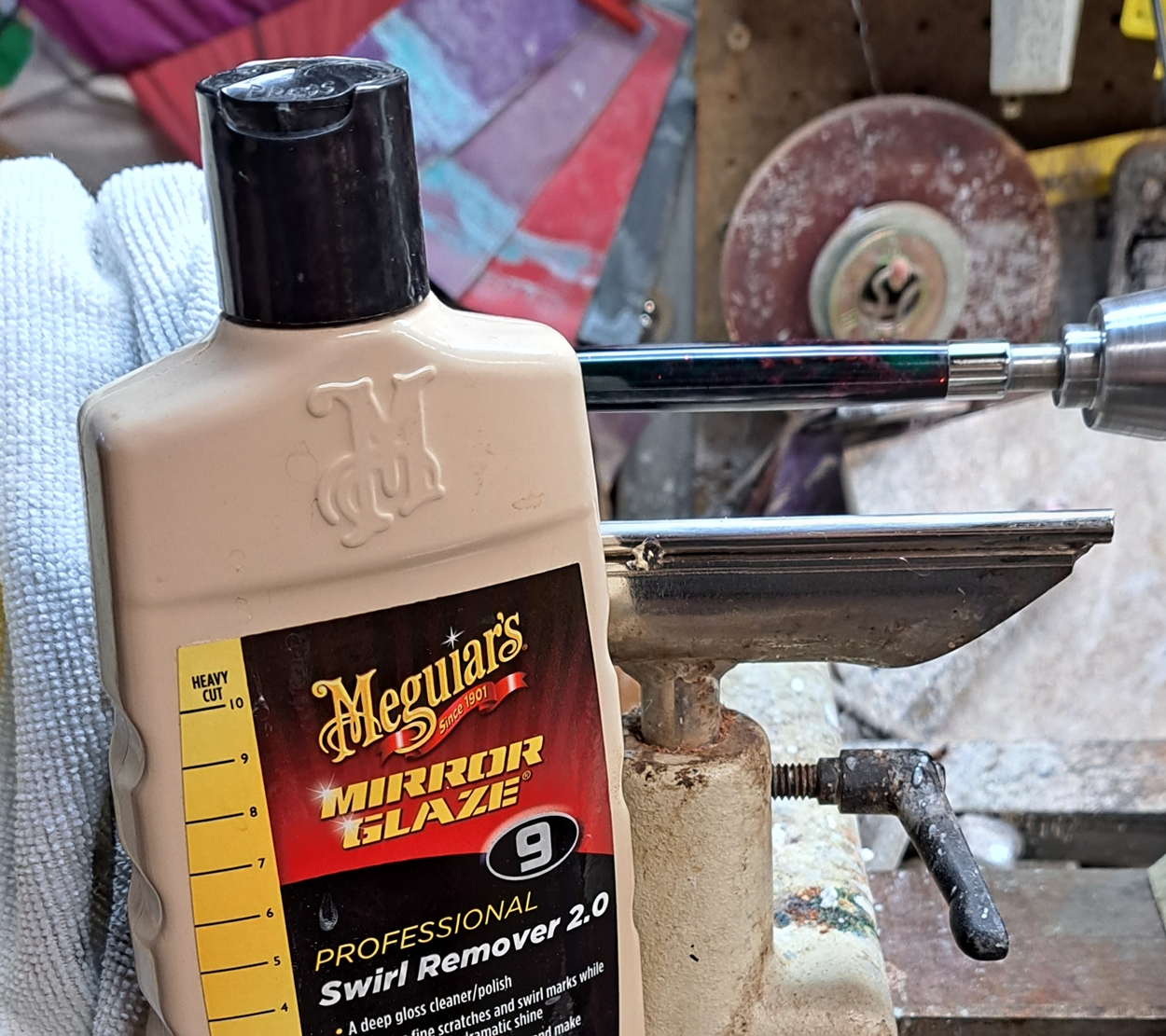

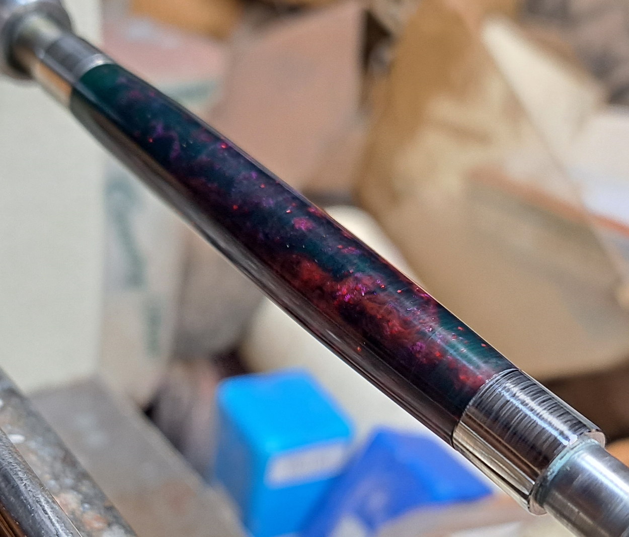

I sanded it up to 3000 grit wet; used all 9 grades of Micro Mesh; then Meguiar's 105, 205, and #9 polishes. It still had visible micro scratches in it, so I repolished with Novus #3, then all three Meguiar's again. Seemed to help a little bit. It looks good to the naked eye.

Jim, For remaining micro scratches on both wood and acrylic, I use EEE Paste from PSI. Just a small amount on a paper towel with the lathe turning works great. Prior to using, I wet sand to 1500 grit, and micro mesh acrylic with all grits up to 12,000. Does a terrific job removing micro scratches that remain after sanding. Increases shine on acrylic even if there are no visible micro scratches. I don't use micro mesh on wood, only on acrylics. 1500 wet sanding on wood followed by the EEE on wood gives a great finish. I never saw a noticeable difference to go any finer, especially if you use CA to finish the wood.

I'm really intrigued by this kit. It is a pencil, right? Is there by chance a sharpener inside of that finial?
Have you ever used Magic Juice? I picked some of that up recently, just a set of the small bottles. It seems a tiny bit goes a really long way...so, it isn't as expensive as it seems. That stuff has some ultra fine grits that might help you take that beautiful blank to perfection.
I just recently heard about Magic Juice, but haven't tried it yet. Yes, there is a sharpener. You unscrew it from the finial.

I use about 1/4 th the size of a pea. I wipe evenly on the turning with the lathe off. Switch the lathe on and use a paper towel to work it in good. I continue with new paper towel until it's all removed from the turning.
EEE is a good name for it. It's actually Tripoli powder mixed in wax. That small tub it comes in will last you for several years !
