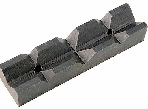

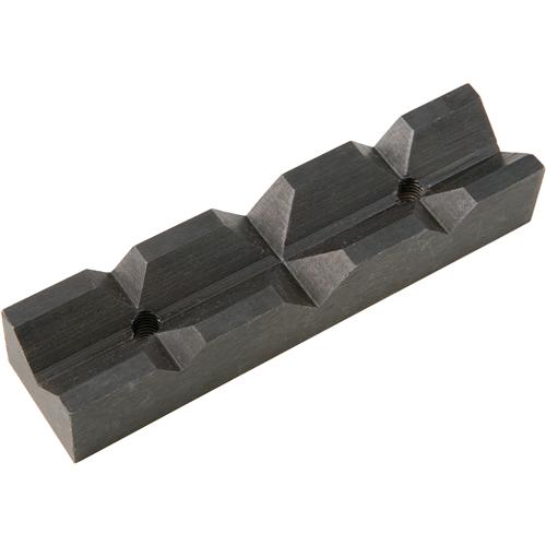

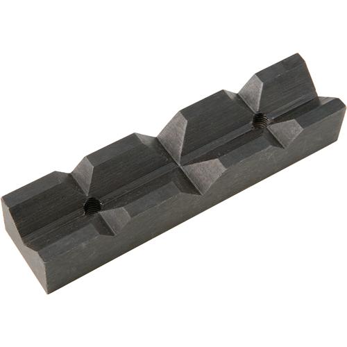

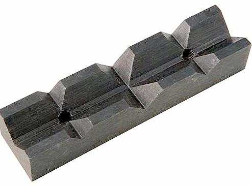

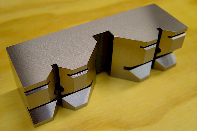

I use an X Y axis vice with two prismatic 4 inch jaws as shown. Two types from Grizzly.
Peter.

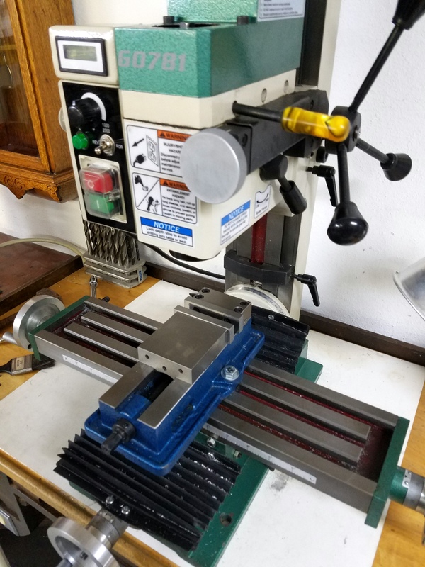

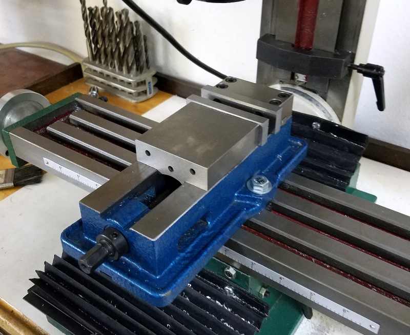

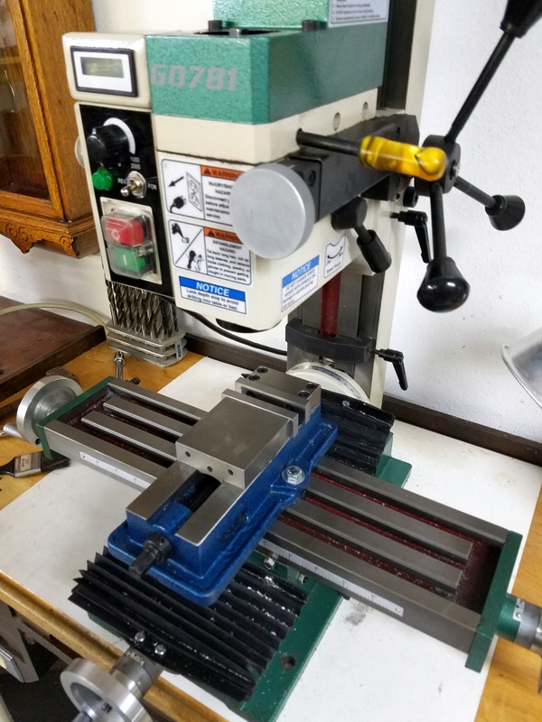

This is my mill vise. Indicates in perfectly but I prefer to drill on my drill press and mostly on the lathe.
