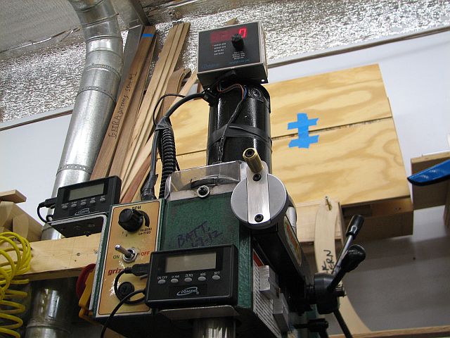

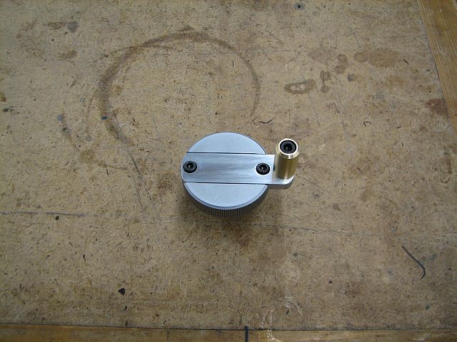

You know what a PITA it is to move the fine feed knob when you have it engaged, well I got tired of it and had some free time this morning and decided to make a handle for it. I don't know if I saw it somewhere or just thought of it myself but this is what I came up with....
attachment.php

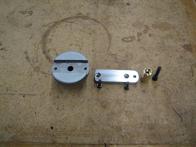

Some 1/4"x3/4" alum. flat bar, some 1/2" round brass and a few screws.
attachment.php
attachment.php
attachment.php
Anyway, I just tried it and it works like a champ so I thought I'd share it with you.:biggrin:
