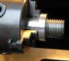

I do like the way you think! I've been looking for a faceplate for my lathe with a 1" 8tpi mounting point for my wood chuck. I just need a piece of scrap steel and relearn how to use my change gears.
You could even put it an independent 4 jaw and you could take out any run out in your wood chuck.

Mal, Danny, PSI has something similar to this one here...https://www.pennstateind.com/store/spindle-adapters.html
Mine was made from aluminum by some friends when I lived in Florida. It served my purpose, which I don't even recall what it was. But I still have it! 😁
