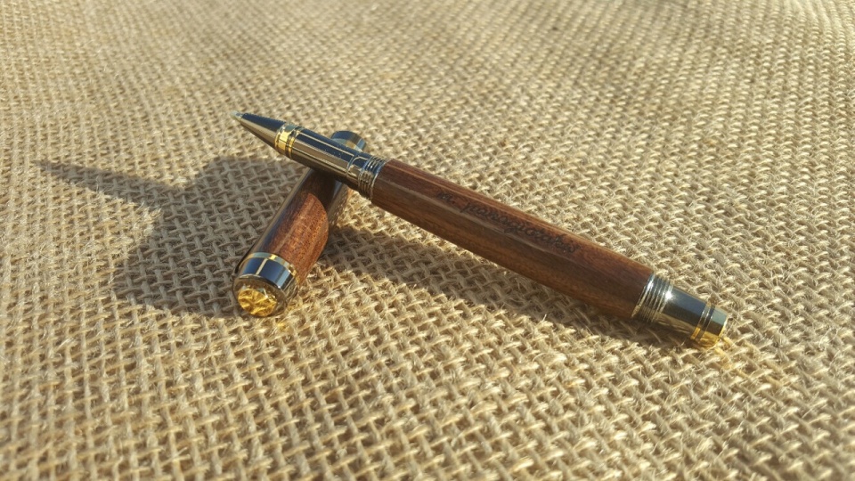

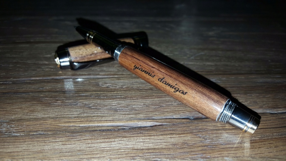

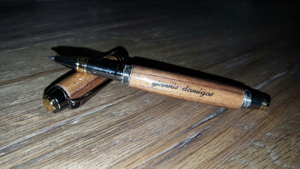

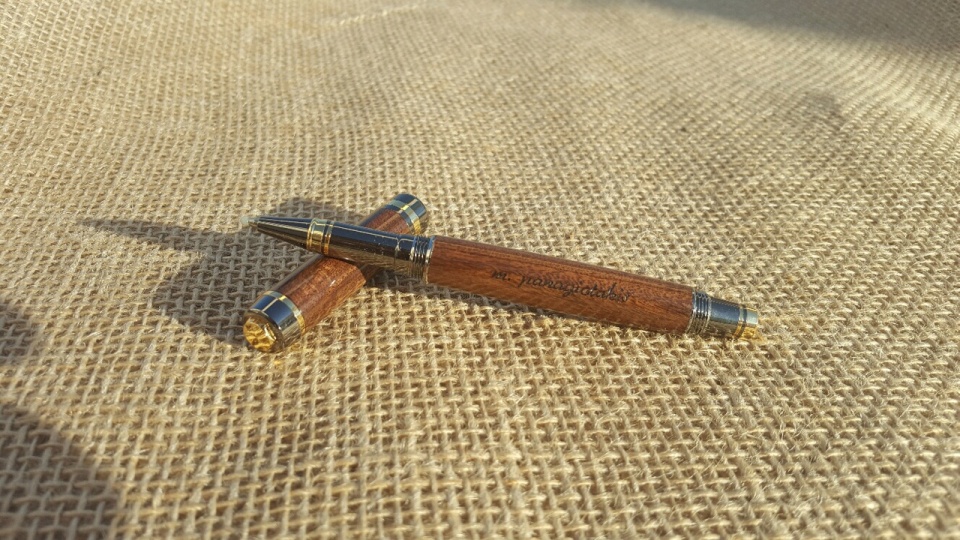

so i recently bought the benbox mini laser engraver.
After doing some tests in scrap wood i can say i am pleased with the results i got in 2 pens i engraved.
Each pen takes about 10 minutes to be engraved.
