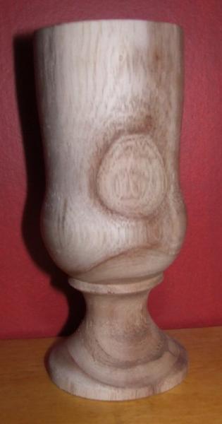

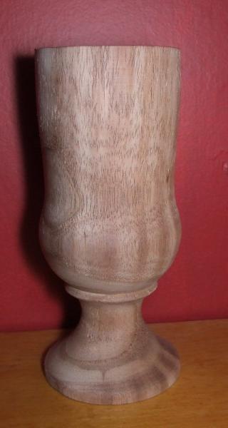

A friend gave me the trimmings from his Mimosa tree when he cut it away from his cistern... some of the trunks were as much as 6 inches at the base... most were much smaller... I used some of the mid sized trunks to turn a couple of wood goblets that I showed on my website and subsequently sold at one of the Farmer's Market shows I did in downtown Knoxville.
Long story shortened... I had an email from a lady who wanted to know if I could make more... I looked and had more good wood and said I could try to duplicate the ones shown sold on my website...(duplication isn't my strong suit)... she wants 10 of the goblets...
Here is the first... turned, sanded through 400 grit and waiting for finish... only 9 more to go....

Excellent turns and some very interesting wood. First one reminds me of mesquite...well sort of.

Nice looking so far, but like you say duplication is the trick. That first one always looks just like itself!
These are two sides of the same goblet... the wood is much lighter weight than mesquite and fairly pourous... I've had this a year or two, so it's pretty dry... I had it in my wood pile and just covered with a tarp... I think it will all turn out fine, just have to be able to duplicate the turnings...
