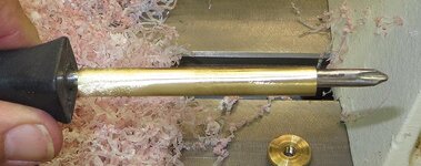

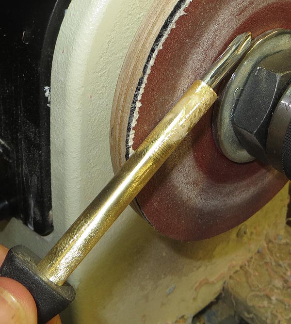

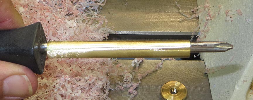

I used to hand sand tubes when I first started turning pens, but that gets tedious real quick, even for just a few tubes. What I do now is put the tube on an old or cheap screwdriver and hold it against a moving disc or belt sander. The tube spins on the screwdriver shaft and gets roughed up lickity split. You have to be sure to angle the tube "into the rotation", or it will go flying. Don't ask me how I know. These photos show a tube that I had turned the blank off of, and I'm sanding off the remaining epoxy. But I do the same thing with new smooth tubes.
