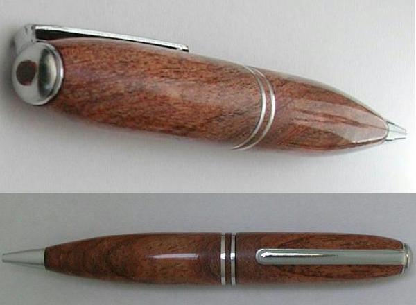

Here is an example:
1. Turned and drilled the center band to size.
2. Mounted the CB on a mandrel and used a parting tool to cut a goove in the center band.
3. Turned a Mesquite insert and drilled a hole to fit the groove in the CB.
4. Cut the Mesquiet center insert in half and glued it in the groove in the aluminum center band.
5. Trimed the insert to fit the OD of the CB.
<br />
Chuckie
