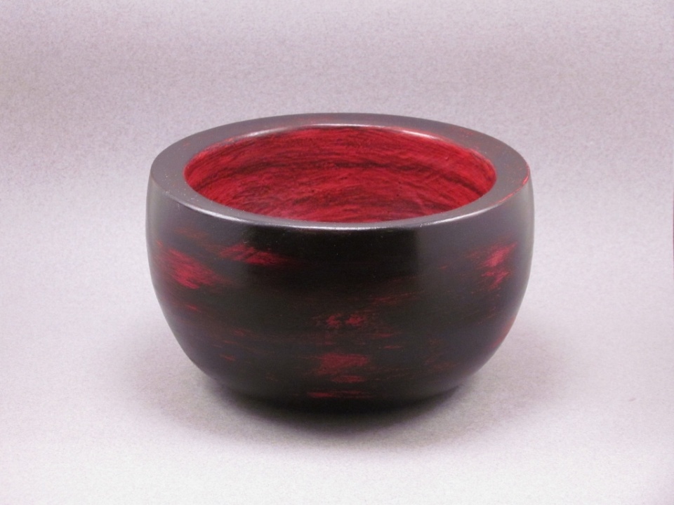

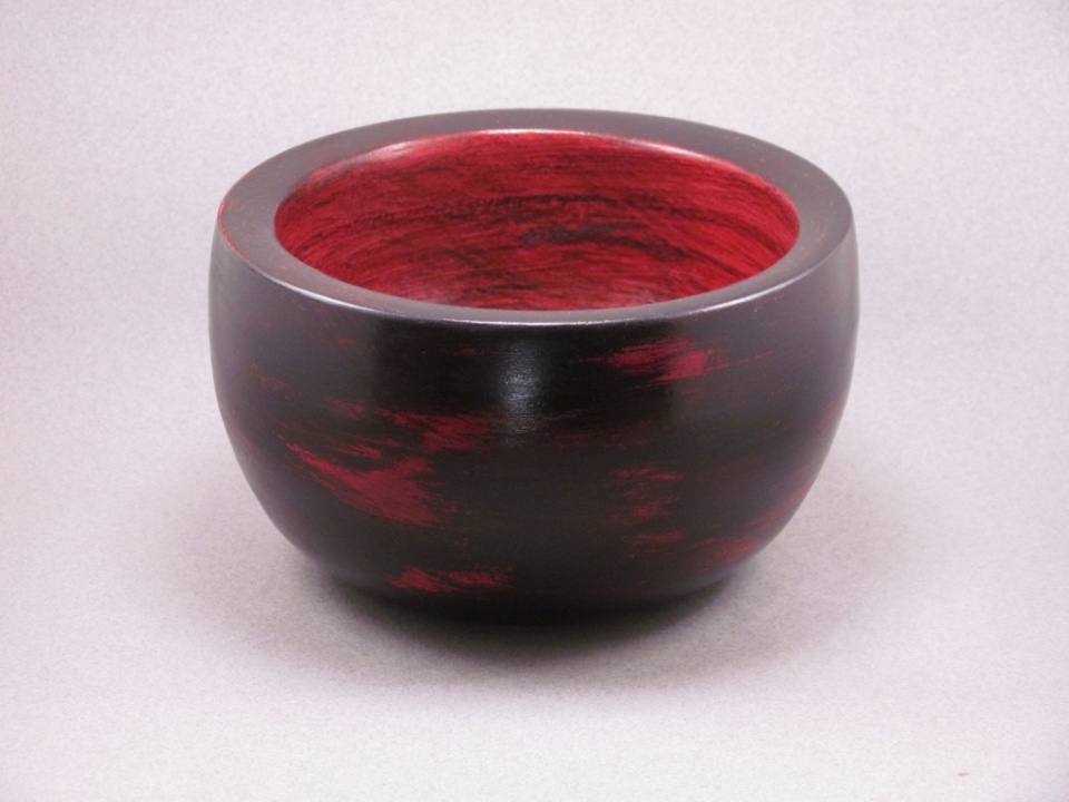

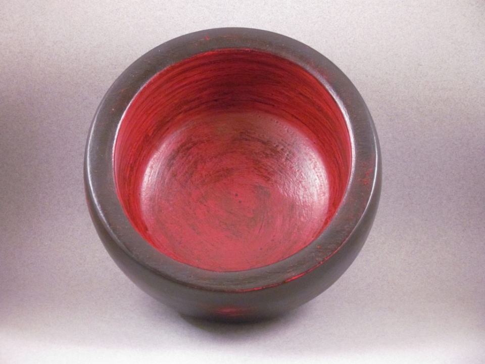

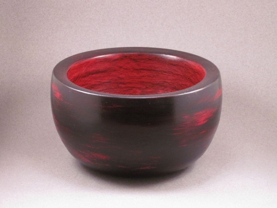

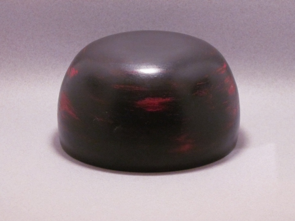

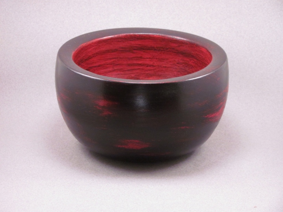

This was my attempt at turning a calabash bowl (I'm don't think I have the proportions quite right). Anyways, I liked the results I got with milk paint on the last bowl I did, so I wanted to keep experimenting with it. On the inside of this bowl I used a base coat of black, followed by a coat of red which was distressed with sand paper. I reversed that on the outside of the bowl (base coat of red, followed by a coat of black which was distressed with sand paper). I then put on three coats of wipe on poly and finished it with a coat of paste wax. It got a little more shiny than I wanted, but I'm still happy with it. What do you think? I know some feel that painting a turned bowl is sacrilegious. My feelings won't be hurt if you're not a fan of this particular piece. I've got thick skin so let's hear what you think; good, bad, or otherwise.

I'm a big fan of these "Stone Age" looking bowls. I like the really THICK walls. :wink: Almost looks like you just scooped out the center with a spoon. Did you do these yourself? :biggrin:
That looks really good Derek. I like the shape and size.

These look great! Painted bowls are great as long as it wasn't something like spalted maple you covered up in the process! I've recently had to step back into furniture making and the whole fad is that chalk paint with distressed waxed finishes....it is an ARTFORM to get that to look natural so kudos to you on the distressed milk paint!
Looks Great! I like it! Before clicking to see it larger, it reminded me of Japanese bowls.
Your basic technique in principle is like the Japanese, but since you have thick skin, I will tell it like it is: they require you to spend at least 10 years as an apprentice before you get to make your own. :biggrin: OH, and they use a very special lacquer instead.

I like the looks and the paint. Very nice and it shows what else a person can do with a very plain looking piece of wood.
