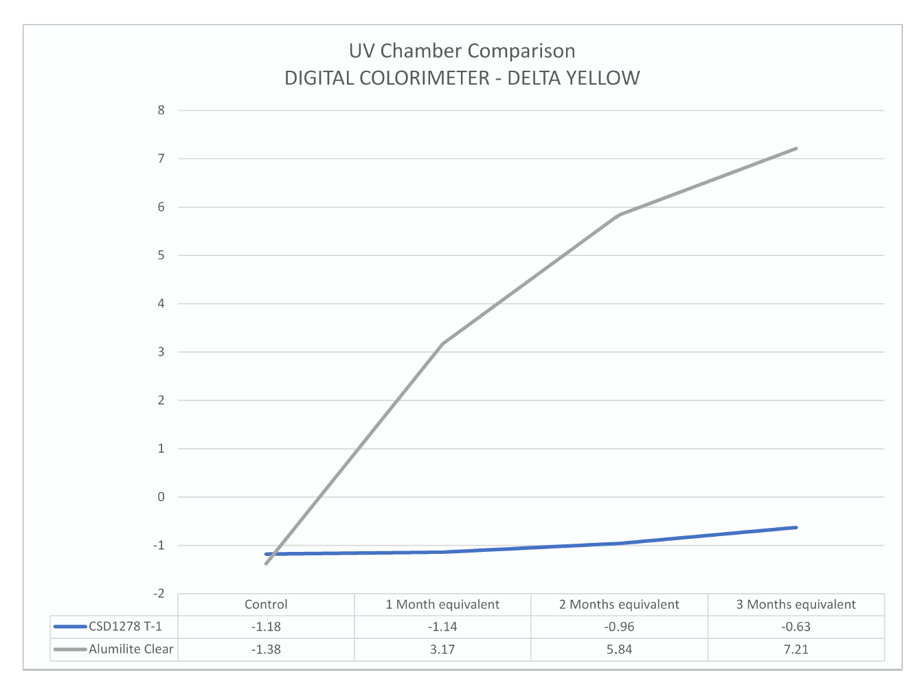

Oh... also got lab info back on UV and Heat tests. If you don't want your casting to yellow, this is one to try. ;)
UV Testing

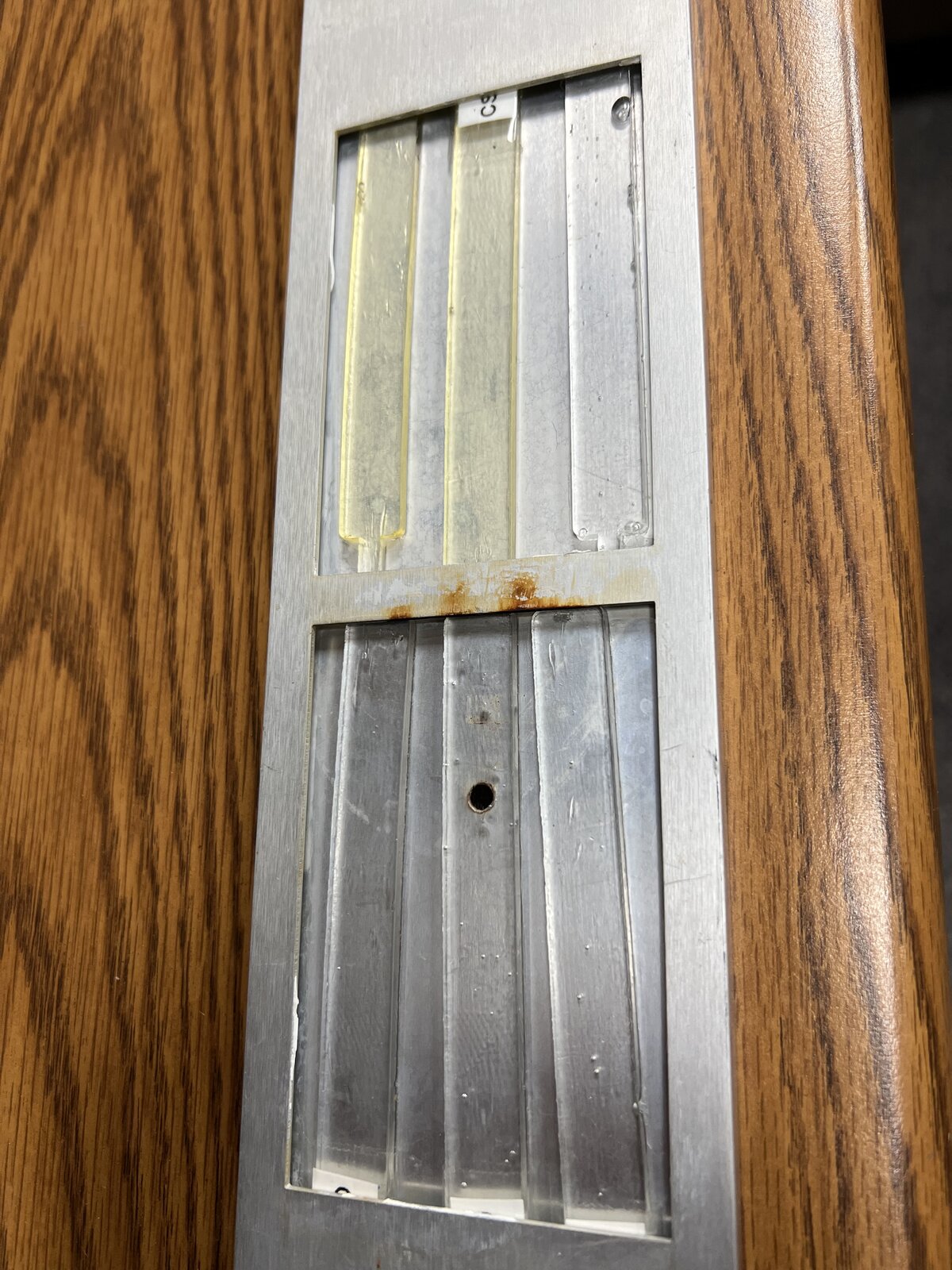

That big giant curve is the resin you're using today. To put that number in perspective. Here's a quick photo of the samples used for the testing.
Look how yellow those top samples are.... The bottom is the Thermoset.

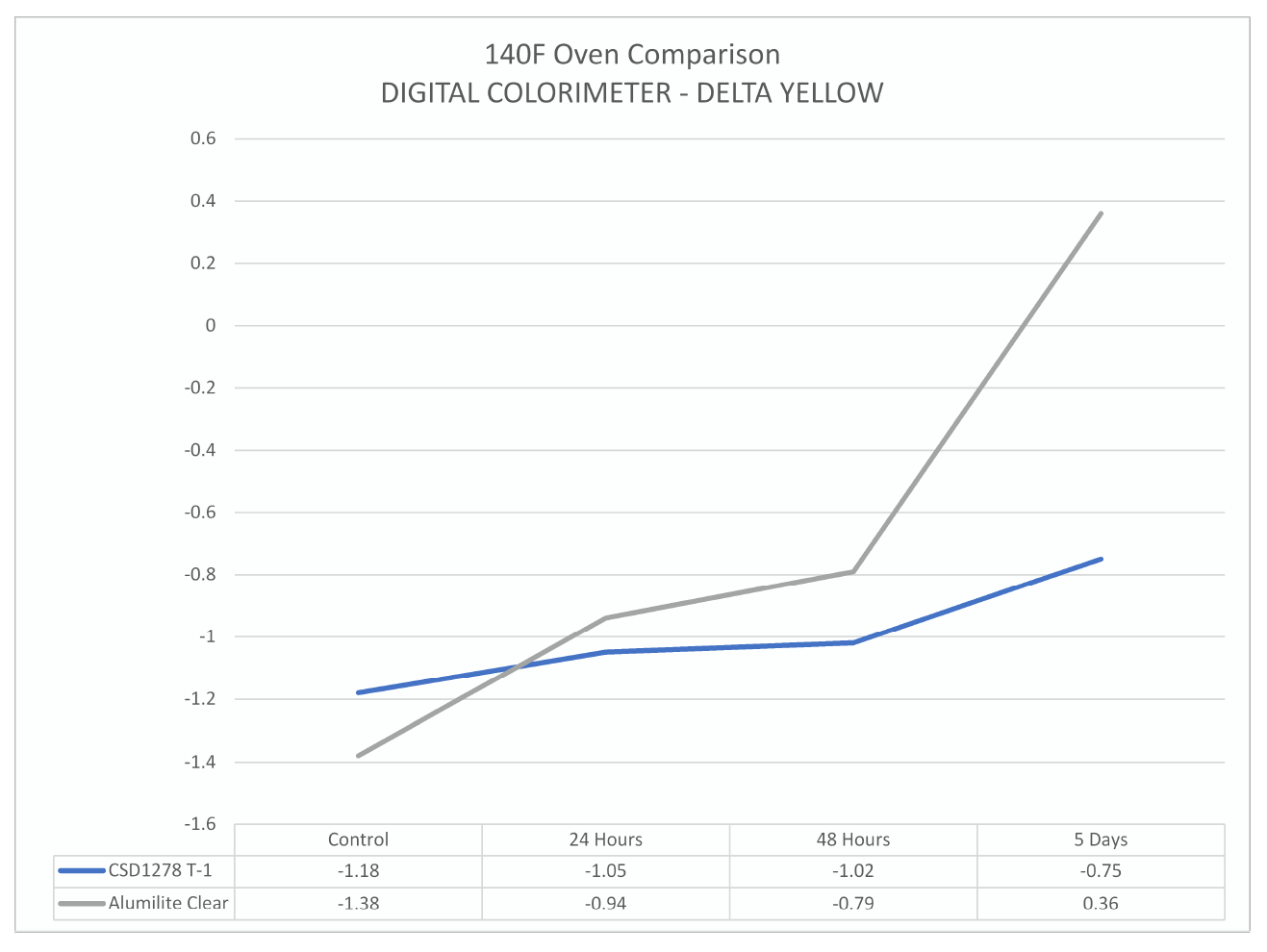

We heat cure our blanks so I had the lab also test yellowing under heat. This also applies if someone were to leave their finished pen in a car during the summer, or you're shipping blanks and they end up spending a bunch of time in a nice hot truck/warehouse.
Short term the other resin is better but as you can see the Thermoset does stay relatively flat while the other one skyrockets in yellowness.
