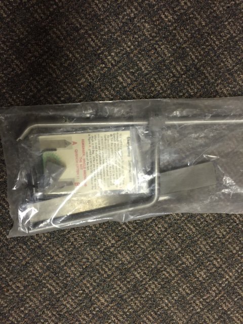

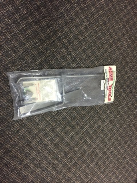

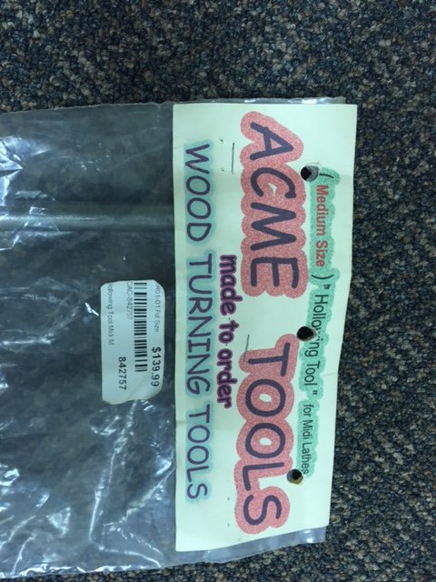

Brand New Acme Tools, hollowing tool for Midi lathe. I got this in a buyout and don't have a midi lathe so for those who do here you go.
Price tag on the bag is $139.99, it's a few years old. My understanding is that these are one off tools made by a guy in SC, the guys phone number is on the back, haven't called him since I can't use the tool but could be helpful for buyer. The set includes the tool, toolrest, bit you can sharpen to your preference. Cool setup. If anyone knows anything more about this or Acme Tools feel free to chime in.
Shipping will have to be in a LFRB game box. No idea what to ask but $100 shipped CONUS only seems like a great deal. Paypal, friends and family preferred. Please post here to claim.

I don't think it is exactly. I don't see a spring. I don't really know how it works, won't to keep it unopened so haven't dug around to assemble it. The guy who bought it never used it either so wasn't able to get much from him. If you or anyone else wants the phone number for the maker feel free to shoot me a PM.
It appears to be a hollowing tool that utilizes the "Torque Arm" as I will call it. While the cutter is inside the hollowed piece. The twist on the cutter up through the straight handle would make it hard to hold onto.
The arm clamped to the shaft rides on the tool rest towards the front of the lathe and takes the torque or twist from the tool handle(and you) and dumps this force onto the front end of the tool rest.
As long as you have a long enough tool rest, all is good.
With this tool, you would probably need to make a handle or place it in a stock handle.
The newer Easy Wood Hollowing tools have a curved neck and the cutter is still in line with the tool shaft eliminating a lot of the tendency for the tool to twist. Also, the wider flat shaft help with this.
Hope this helps.
Thanks Charlie, and I think you nailed it. Good point on the handle, there isn't one that would need to be made, easy to tackle.
The tool rest point makes a lot of sense, this one is slightly under 12" measuring through the bag but is off center with 7" approx. off one side and 4.5" on other so should be good there I'm guessing.
