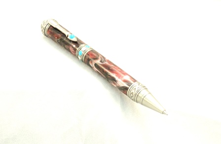

I decided to slow down, which is a chore, I like instant results, (Have Adult ADD) & do a better job on my afternoon's pen making effort! I actually read through the directions (I guess 'cause the kits I bought last summer before the move were so expensive) and looked at the Taiwan bushing closely & after deciding to mic them, discovered that their size and what was on the instructions did not match! So, for the 1st time I tried to turn the blanks down to "size" measuring with the micrometer. Actually I am much more pleased with the results! The blanks are from SDB777 (Slabs....)

Do you happen to have a unedited photo? I'd like to put it on the website Phillip(of course credit will be forthcoming)!!
