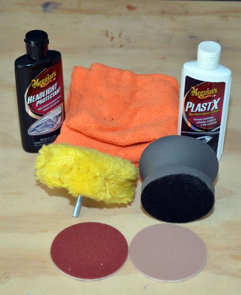

A couple MM pads is what you get in the Meguiar's headlight kit. Here is the contents of the kit, I need to get off my fanny and use it.
