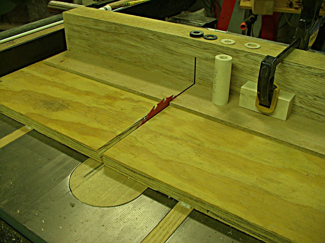

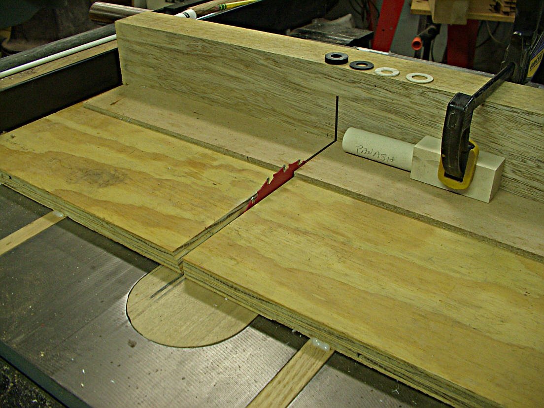

I do not recommend a standard miter fence with micro adjustments as was shown. I suggest a sled that has zero clearance fence and bottom and the reason for this is I hate to have that hang over not supported especially when doing small thin cutoffs. They can kick back and it is not a clean cut all the way through. As far as micro adjusting is something you can easily do with adding stop blocks on either end of the fence and adjust by moving a clamp. That is how I do mine. When the zero clreance portion gets ragged I can easily double side tape another piece to start all over again. It is simple dirty home made jig that has worked well for me over the years. What many times I will do if I am cutting real thin pieces or very small pies I would use doubleside tape so that the pieces do not move after they pass the blade. This way I can safely pull the sled back and recoup the pieces without danger of kick back.
