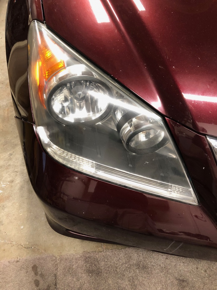

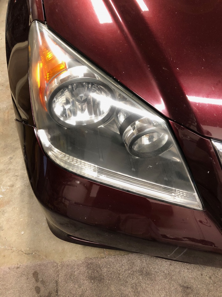

No 'before' picture....
and there should have been, but here is an 'after' picture.
Used Micro Mesh all through the grits, with water and a bit of dish soap. Following that, used some Craftics plastic polish and then a sealer, which was part of a kit I used earlier without much success.
I am pleased with the outcome, but only time will tell if it lasts.
