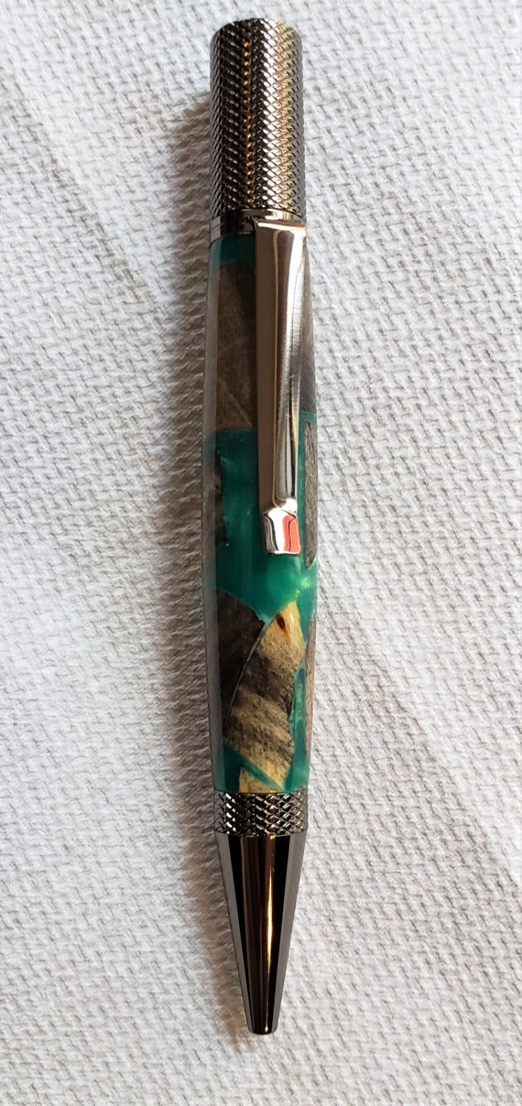

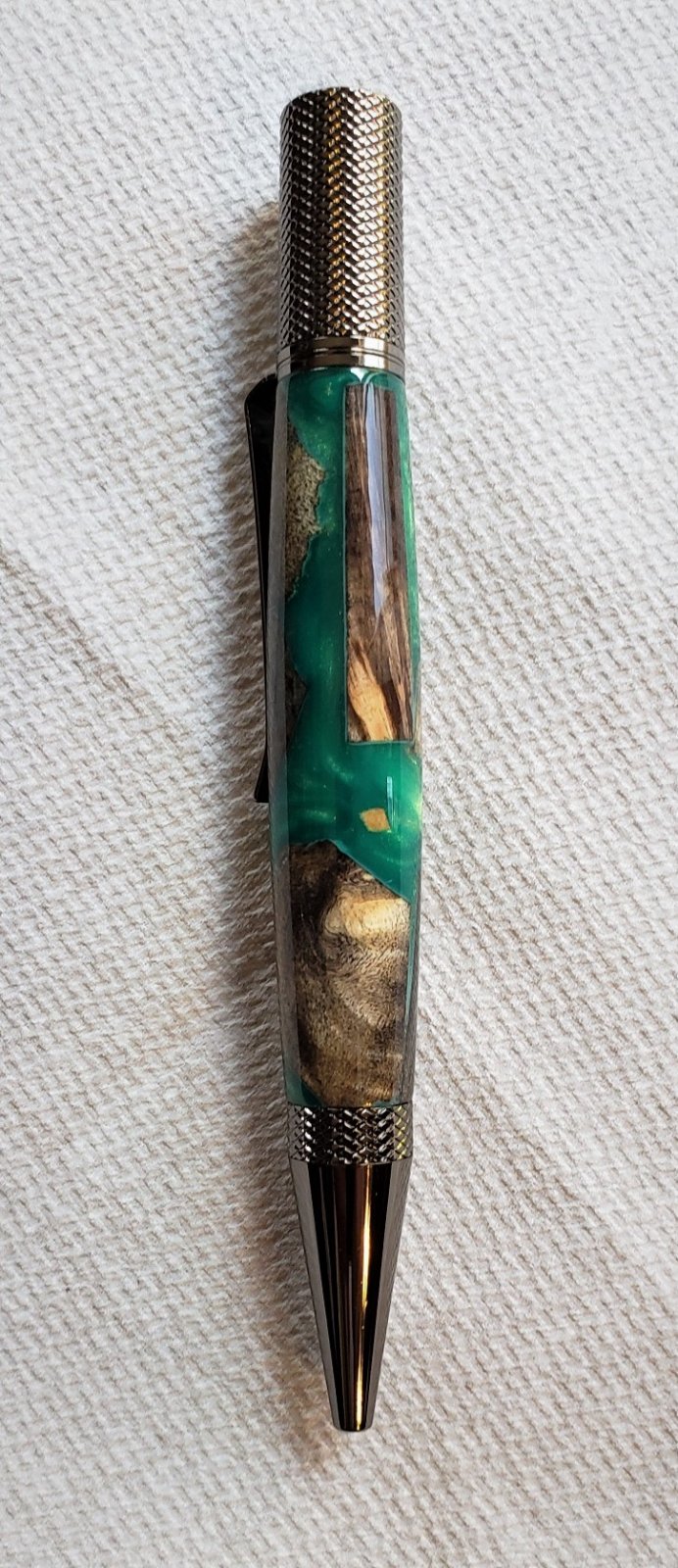

I hope I did this first one justice. Turned easily and polished very well. 2 coats of Mercury Flex thin and 8 coats of medium. I followed JT's advice and used gloves (nitrile I think, not sure what form on "plastic" he suggested) to apply the CA. I never had much success with the little bags like others do, but this worked out very well. I found I wasted less (but none being absorbed in the paper towel and I was able to apply a smoother (less textured) layer of CA which made it easier to sand. I did paint the inside of the barrel dark green.
Anyway...here are two pics:

Looks Great Tony! Of course, all of your pens look great. Very nice job on the finish.

Very nice looking pen Tony. I have been thinking of trying some of those kits.
Maybe once I get a handle on organizing my pen making supplies and organizing things I may give them a try.
