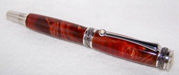

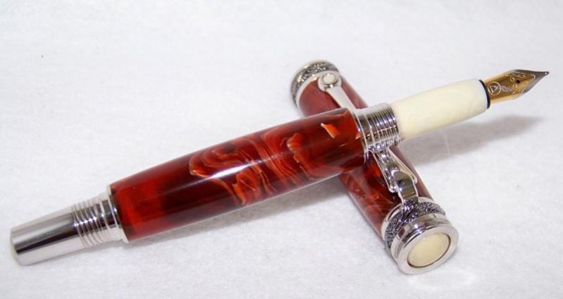

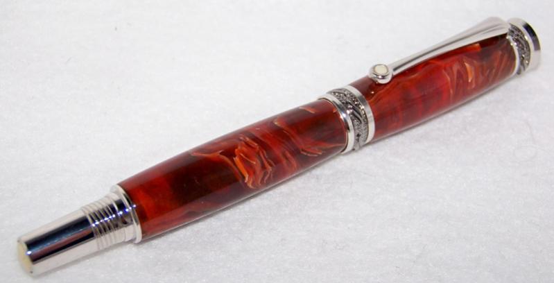

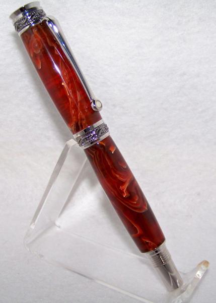

After using a bit of this Mexican Agate to make some accents for this pen (http://www.penturners.org/forum/showthread.php?t=66007) I liked it so much I used the rest for a Majestic Jr. Of course I had to get rid of that eye sore pimp crystal and the finials so I used some Ivory TruStone as a replacement. I've tried to turn a custom grip ala Hans but no go so far. The first one broke and the 2nd was perfect (atleast I thought) until I tried to thread the body into the cap and found out I was about .02" too big and it wouldn't go past the threads. I have enough material for 1 more try so hopefully I can do a repost in another day or so. I'm extremely happy with the outcome so far. It does look slick with the ivory grip so hopefully it'll work out. I upgraded the nib to a Heritage semi-flex steel nib that I got from Exotics. The trustone blanks I bought from Richard at R&B Crafts. All peices were MM to 12000 and polished with PlastX. Thanks for looking and for any comments!

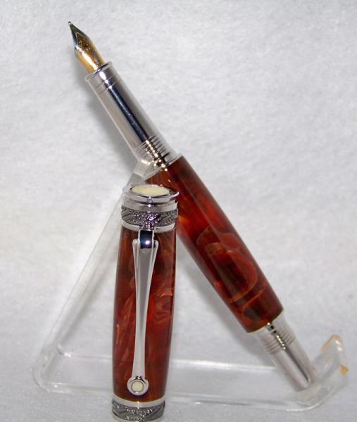

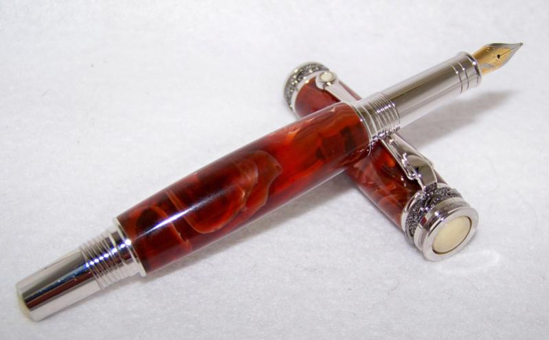

Now with custom grip
Here we have the new grip for the pen. Also made with Ivory TruStone. I'm shocked it held together bc it is paper thin! I think it completes the look I was after. Yall let me know your opinions as far as the stock grip and this one. I did make this one a tad bit shorter than the stock one bc the stock grip blocked a bit of the engraving on the nib so I made mine to expose it a lil more.
