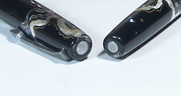

I have made pens using meteorite dust. I add the dust to the plastic matrix to make my own blanks. I use rock dust not metal dust, as there are both rock and metal meteorites.
