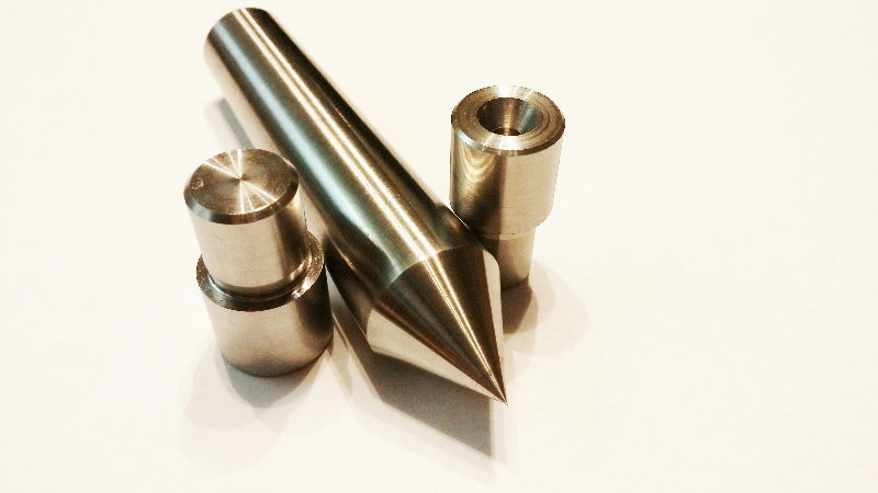

Ha I hate machining 304! 17 4 machines great... No problem on CNC and great finish...I have a video on YouTube on the making of them.. Just search briannikitas...
Made a dead center today from 17-4 steel...will see how it holds up..may heat treat it later...
one up on that.
That is awesome! I tried making a custom bushing last week and managed to get the 7mm hole 10 thou off on one side--drilling into the hole I drilled for centering (not to mention that it was a real b*&^h getting it drillled). I'm afraid my lathe just doesn't have the precision any more. :mad:
